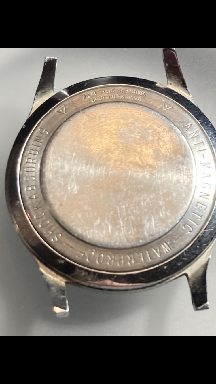

4 hours ago, Latetothegame said:
…I believe it is a snap on case but I cannot find anything looking like a tab or slot to insert a pry tool into…
It‘s a snap on for sure! Some case backs don‘t provide a slot for the knife.
Edited by Kalanag
This case is tight.  I can’t even get the edge of a razor to penetrate slightly into the seam between either the case back or bezel.  Pushing very hard with a razor blade is a dangerous activity so I quit while I was ahead.  I attempted to hot glue a lever to the case back to pry it off.  That has worked for me before but nail I used ripped through the glue.  I’m going to try that approach again but I’m not very hopeful.
Edited by Latetothegame
So, the end of the crown just pulls off?  Sorry for my ignorance on this.
Even if that is correct, I can’t get the bezel off either. However, it would still be nice to now where to focus my efforts.
Thanks for your help!
The red line indicates the boundary of the stainless steel back. Have you tried to get a blade in there?
Edited by Kalanag
Even if this back cover could come off, it will be impossible for the dial to come out via the back as the diameter of the dial is bigger than the opening at the back.
If ever the back comes off, it is to release the winding stem. In quartz watches, a similar design like this is to allow access the battery.

Yes, assuming it's a split stem. You have to pull straight out or you could damage the stem or tube. If it's not a split stem, then you'll break the stem or worse. In any event I'd make sure first by working on getting the bezel and crystal off. That way you can confirm it's a front loader. I think I see a notch for a case knife in one of your pictures, but you should first clean off the gunk.
Sovereign was the 3rd-tier brand made by Benrus (Benrus > Belforte > Sovereign) and nearly all of their watches from this period were front-loaders.  Many Sovereign watches had aluminum cases, but this one is more similar to the Belforte versions which were partially stainless steel.
If I was working on it the first assumption would be that it is a front-loader, so you should definitely try to remove the crown and split portion of the stem. If it comes out, then you can use a crystal lift of one style or another to take out the crystal, after which the movement can be tilted out.

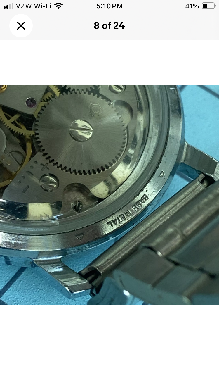

LTTG - As for the two pictures you posted, those do not have their backs removed, they are both actually a poor-man's display back (a thin case with crystals on both sides) that was sold by the Benrus brands at the end of their life. They switched away from ETA movements but valiantly tried to show off the jewels of their Seiko and other non-Swiss components as a defense against the electric/electronic watches and the pin pallet competition. It's not surprising you didn't realize that because they are admittedly weird...
I'm only giving you the best advice that I can. They used mold marks to simulate joints in the side of the case, so you could do some scrubbing and polishing there with magnification to see if it's a real joint. However, I think the giveaway is the location of the lettering. Here is a photo of two one-piece cases I have, and it can be seen on both of them that "Waterproof" is centered between the lugs and the stem hits right at the M in "Anti-Magnetic," which seems identical to yours.  Removable case backs don't act like that. So,  I'd still focus on pulling the stem if it were me.

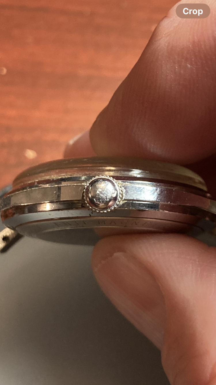

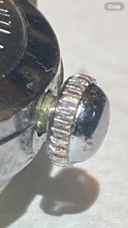

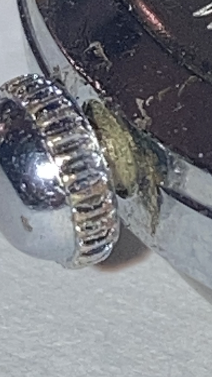

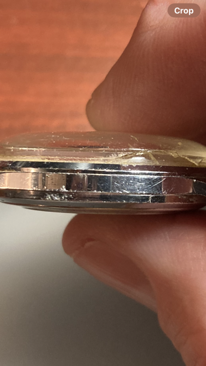

I don’t know if these pics will help to figure this out but it’s just a bit more information to consider.  Here are pics of the crown, stem and case opening.  Let me know what you think.  That opening looks perfectly round.  Thanks.
It looks like it has a knife groove a bit to the right of the crown in that centre detail, as if the whole case splits around the middle - see the first two photos?

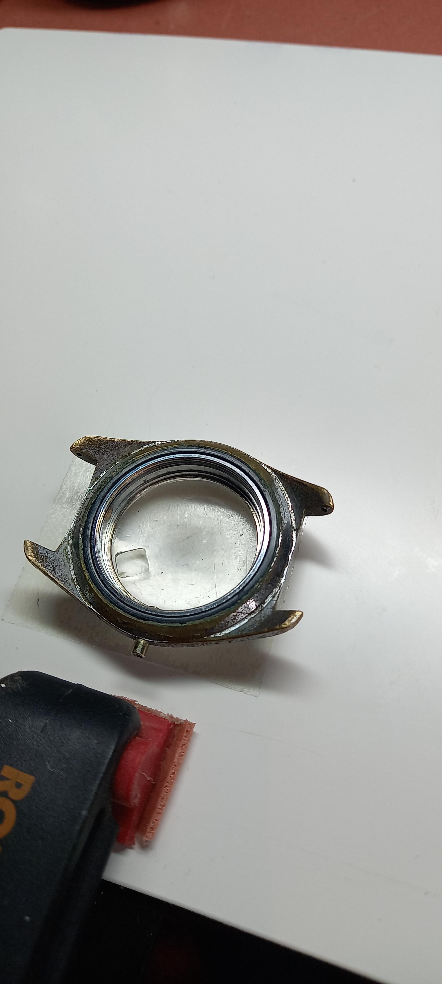

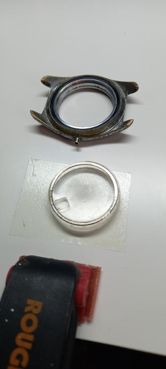

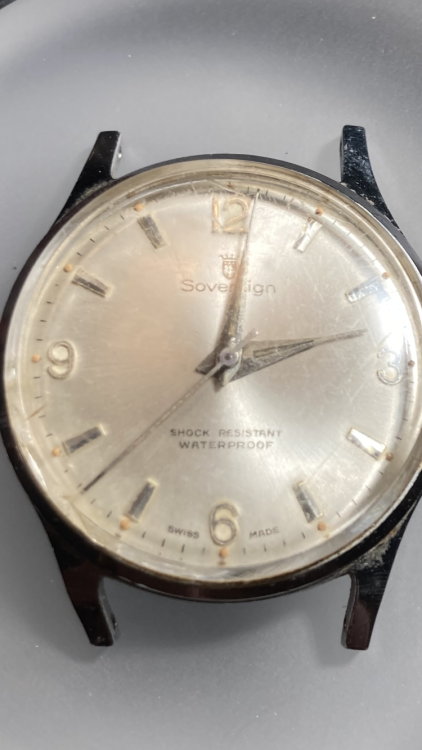

The mystery has been solved.  Geotex was correct.  As I had mentioned, I had ordered a bezel removal tool to see if that would work.  While I was attempting to remove the bezel, the already cracked crystal cracked some more and fell off.  As I was shaking out the loose pieces from the dial, the dial tipped and came halfway out of the crystal opening, stopped only by the split stem still being place.  At that point  I decided to fully commit to the side-cutting plier approach to popping off the crown and stem.  One good firm prying move and it came right off.
see attached pics.  That was last night.  The watch is now fixed and awaiting a new crystal and band.  The case is in fact, a one piece case.   The crumbling crystal revealed a near perfect beautiful dial.  I’m keeping this one.  Thank you to ALL for your time and advice!
