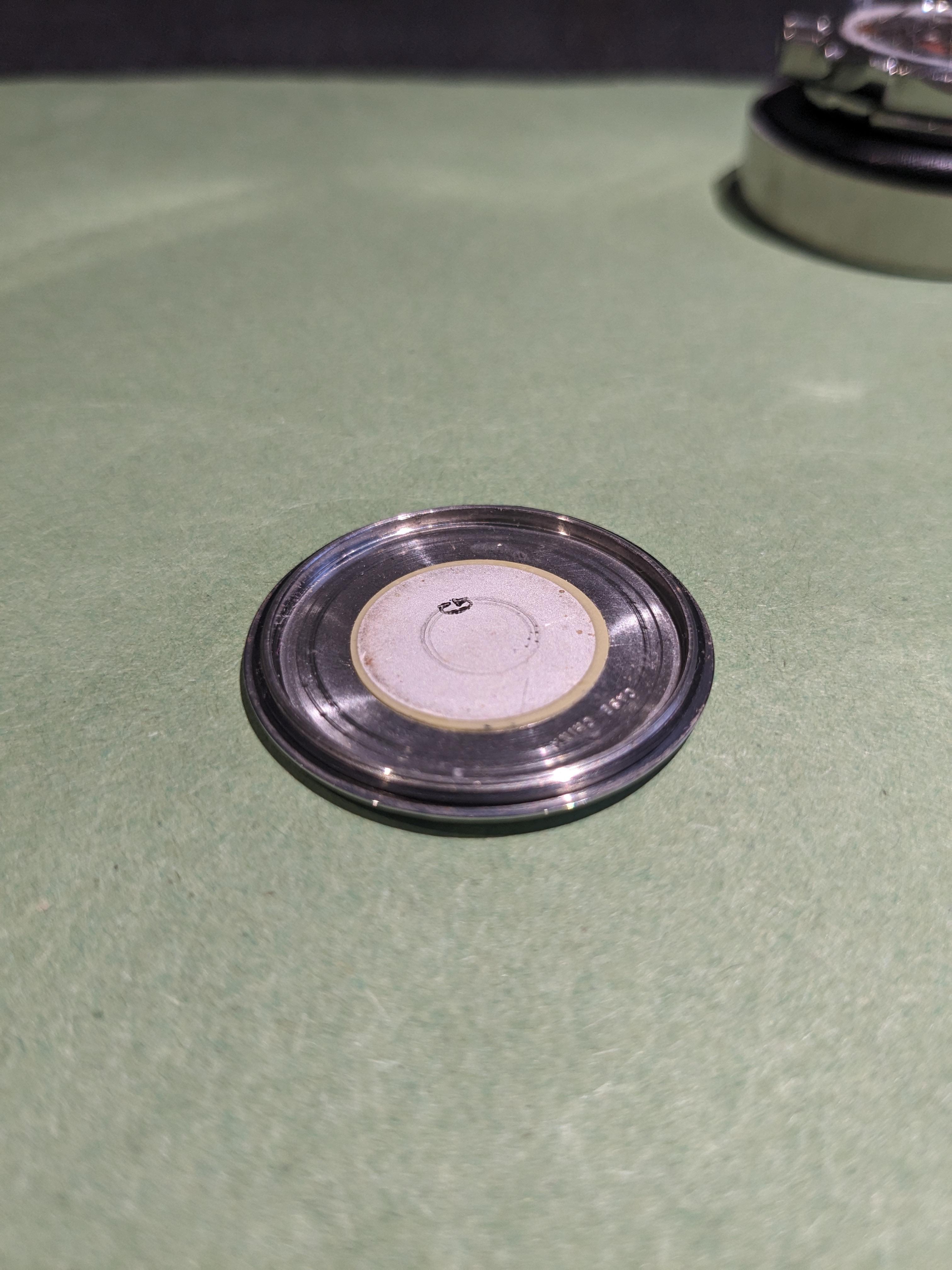

I'm looking to replace the case back seal on a watch, when I removed the case back the seal was twisted and crimped in 2 places. The seal looks flat, but when I've looked for replacements I've noticed there are flat and o-ring style seals available. Would I be best going for a flat seal again? Is the original seal actually flat or is it a completely worn out o-ring?! Do they come in different thicknesses? Is there a way of finding the original part numbers of case and strap parts like there is with movement parts?

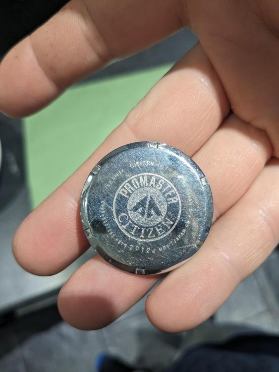

Sorry, I should have known to give some indication as to what it is! I've added pics of the seal and case back. The watch is a Citizen Promaster Wingman Temp. How would I go about identifying the correct parts for it? I've measured the case back diameter where the seal sits, but how would I know how thick the seal is to be?

I've downloaded it from the link! Looks like a really handy manual. However it doesn't help with sizing the case back seal. It does tell me it's a flat seal which is good! I think I'll go for an assorted pack from cousins and see how it goes!

With something like this a gasket seal for instance if i cant find the relevant information i would use instinct to decide what fits and works best. You have the original gasket ( well maybe its original or hopefully it is )so its fairly easy to determine what material to use. Shape , for that i would look at the gasket seatings, are there grooves or recesses in either the case back or case or both, what shape are the grooves, flat or round etc, how does the gasket sit and behave in those seatings. Next thickness,that is going to be a bit of a guess, especially if the gasket is a soft one that has been heavily compressed over time. This is where a selection is going to come in handy, personally i would be choosing one that is giving me the feel of compression as its coming into contact with both of the mating surfaces. But not so much that the gasket is going to squash out and become distorted, again this is guesswork and feel is required with the allowance of compression over time, something you may want to check after six months. This part is a little moot as without a pressure test, good water resistance is not assured so the watch needs to treated as such and not as if it were a new diving watch ( not that i would treat any new diving watch as if were ). What you want to expect from your efforts is a little accidental rain catch, if you want more water resistance guarantee then a professional gasket replacement and pressure test is what you should be seeking which will be more than the value of this watch. Coincidentally i have the same watch, been searching for a stem for it for a while now.
