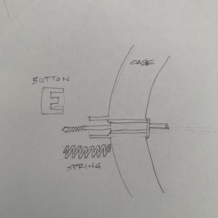

This one has no clips or washers to lock in the pusher in place. Coming from the outside, you'll have the button, spring and the stem inserted from the case and screwed in. The case holds the spring in place and the ridge at the other end of the stem keeps it from falling out of the case.
Posted some pics here and an illustration to help.
My sketch of how all the parts come in to play:
Two different angles of the stem. Note the ridge near the slotted end that stops it falling out.
This is an assembled piece of the one that was successfully pulled out.
If it will have to be replaced, may I have some tips please on how to place an order, sizing, etc (Cousins, Esslinger,...) and on how to remove/install the pushers. My experience is just basic service with time only, day/date complications. Haven't had the opportunity to replace crown tubes and pushers.

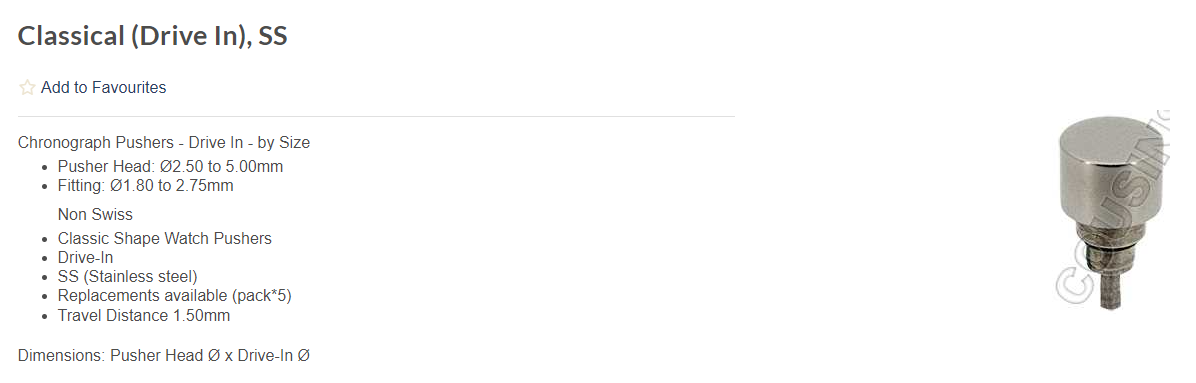

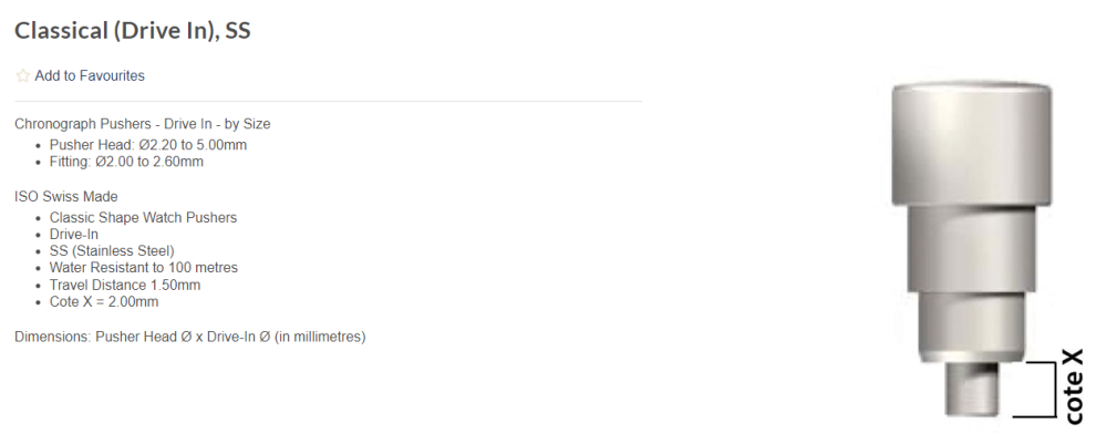

So, I tried contacting Cousins UK asking if these pushers come with the tube or not and unfortunately they couldn't help and their website has no documentation if it does come with tubing.
That said, do they come in complete, ie tube, gasket, pushers? I'm not sure which of these two would be more appropriate:
Thank you.
