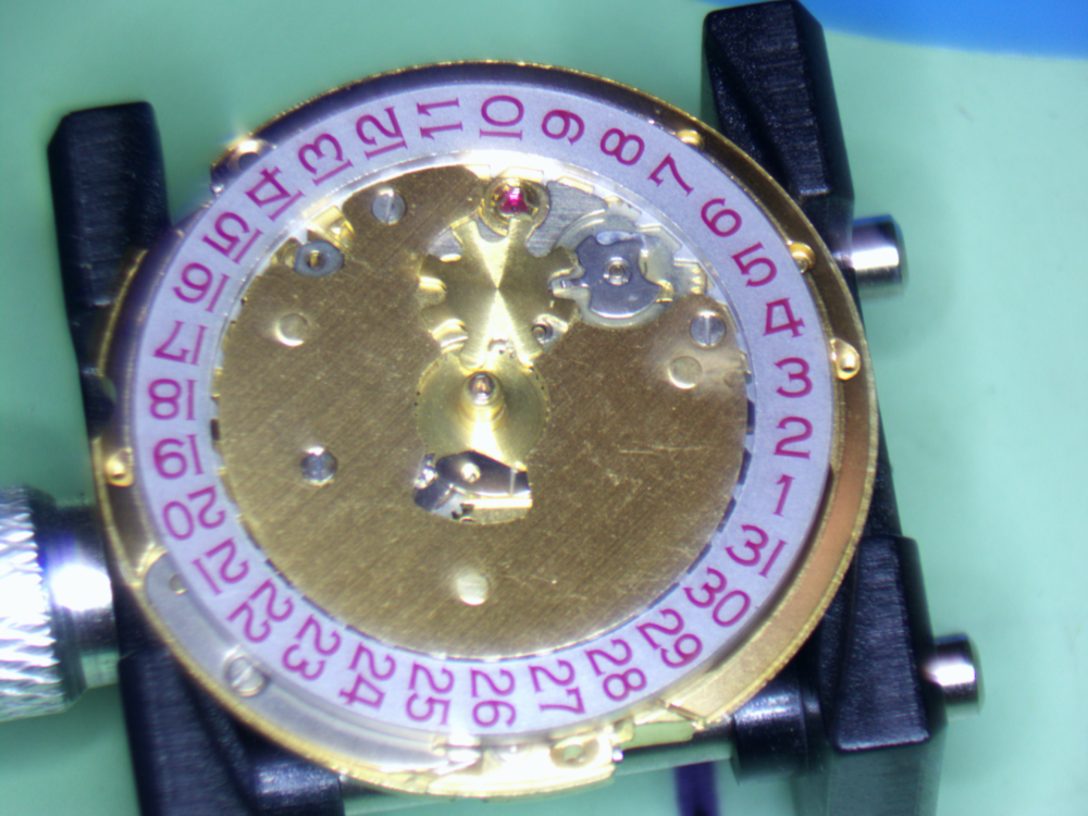

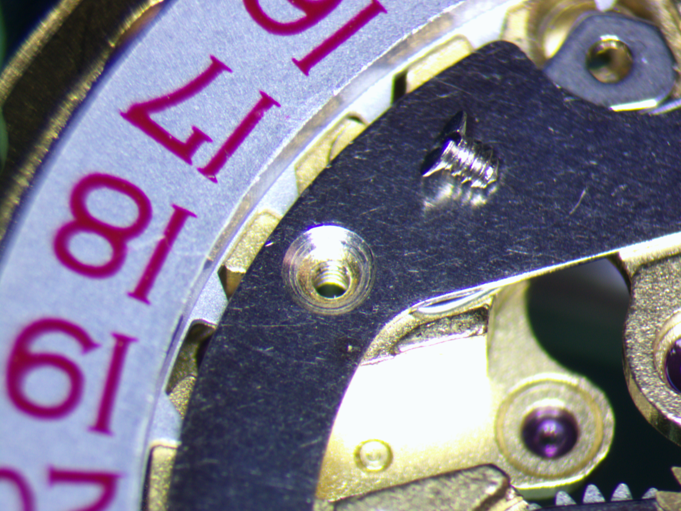

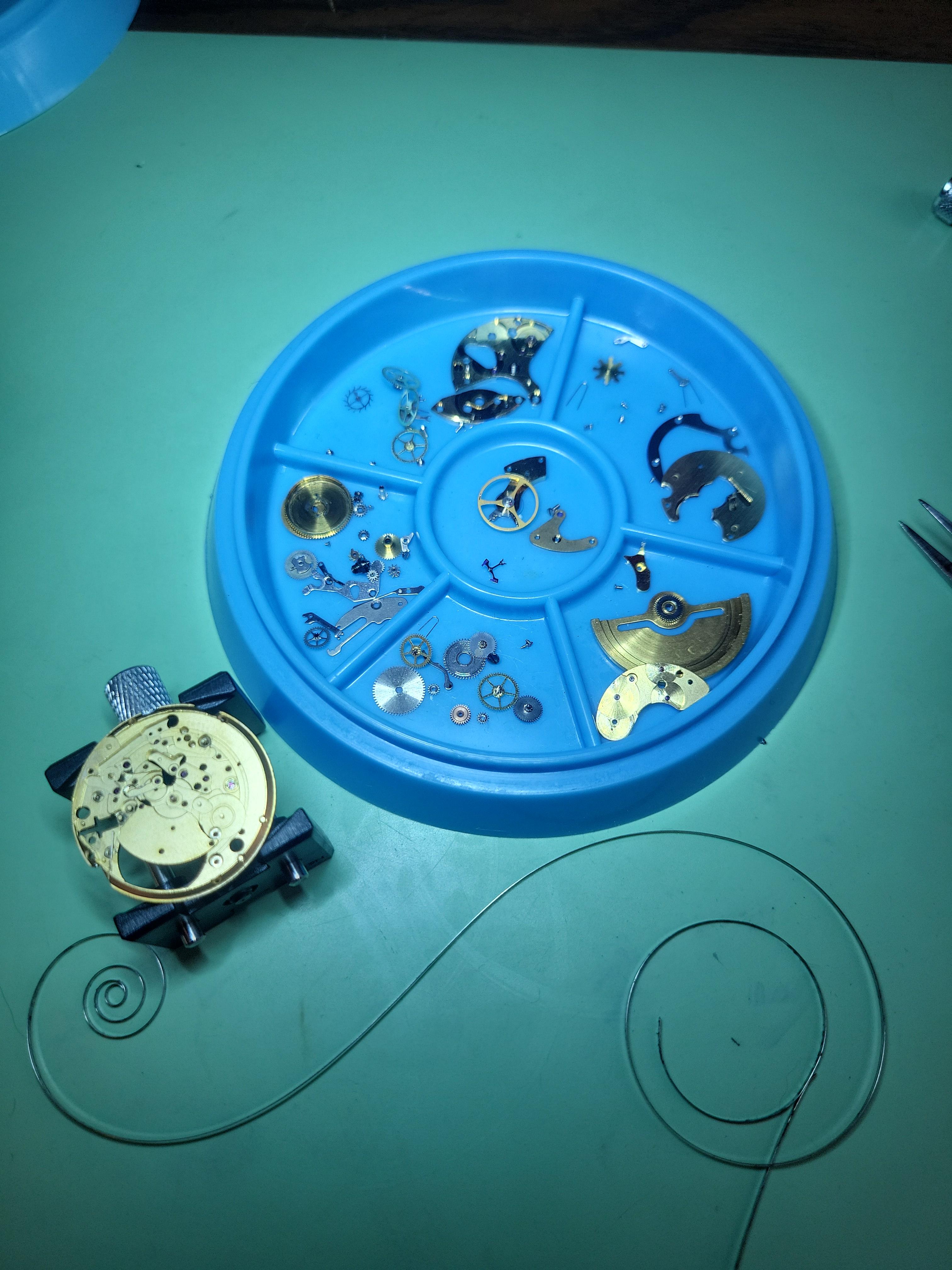

Recently picked this guy up, and took it apart for cleaning tonight.
Looks super clean inside as far as wear and tear goes, but there are puddles of oil everywhere! Hopefully a good cleaning will bring the amplitude back up.
I did learn that the automatic bridge is spring loaded, which you can see below in the yard sale of wheels and gears all over the place.
Sorry in advance for all the pictures and if some aren't in perfect focus. I take a lot of progress pictures through my microscope, and I figure if someone is here looking for help, they might be useful to them.

And this is where I stopped, since I got into the wine.
It's very ..... purple 🤣
It looks like a nice movement. It will be interesting to see how well it runs.

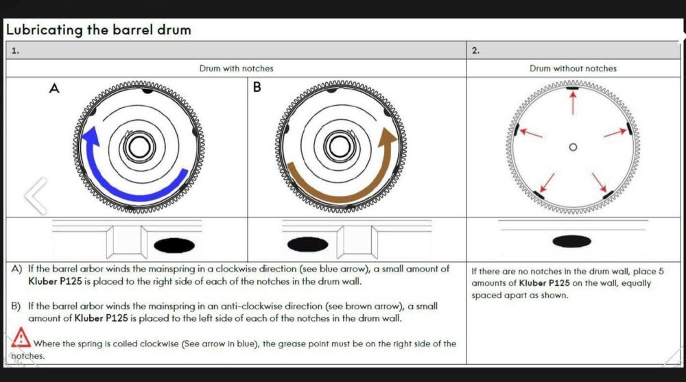

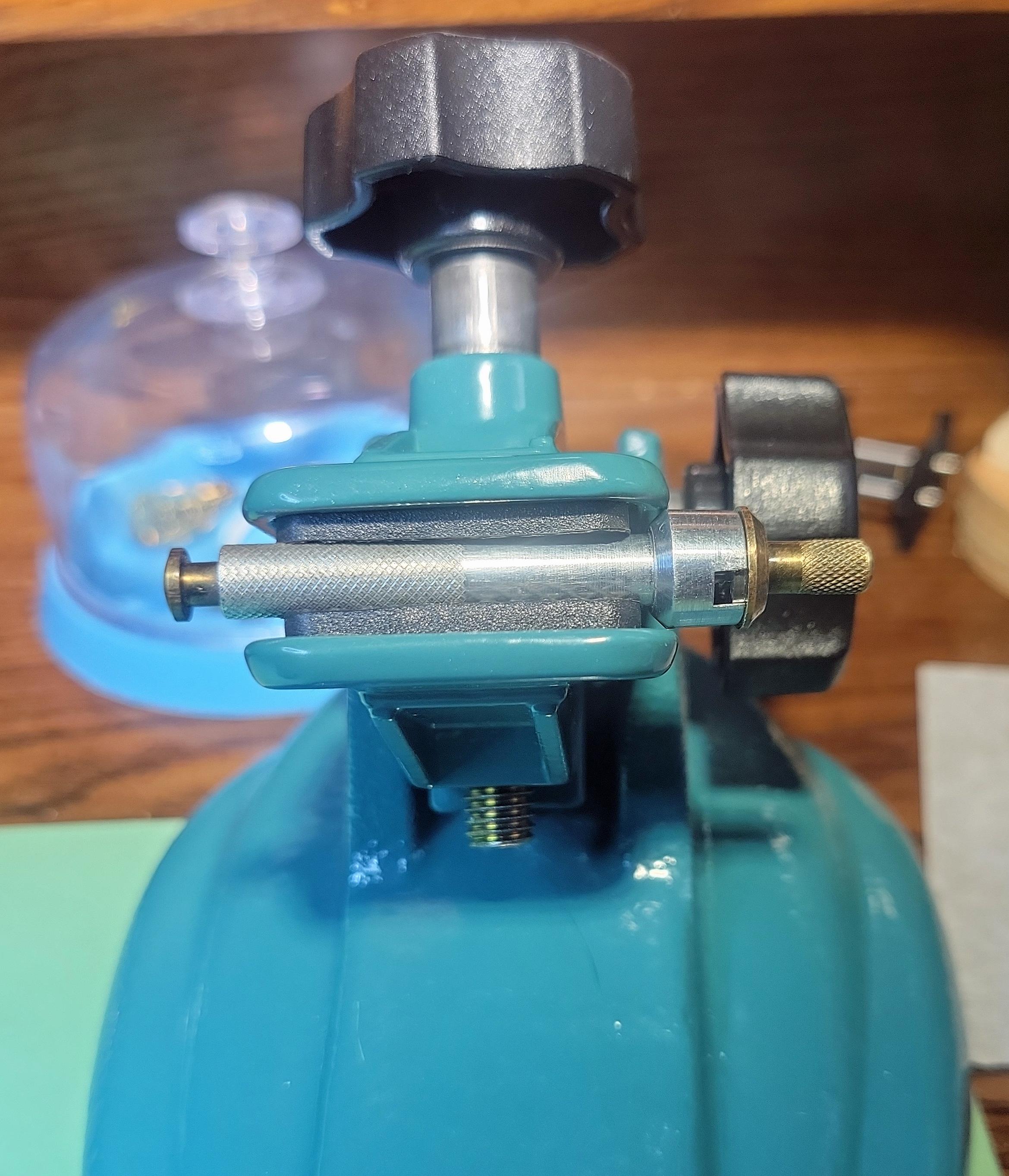

Starting by getting the spring into the barrel, which was a bit harrowing. It took me several tries to get it hooked onto my worn old winder arbor, but I did find a new use for the micrometer stand I just purchased.
Carefully dabbed some Kluber P125 braking grease to the left of the divots around the barrel, and a little HP1300 on the floor of the barrel before popping it in--in case you haven't seen it, this is a great illustration I found somewhere on this site.

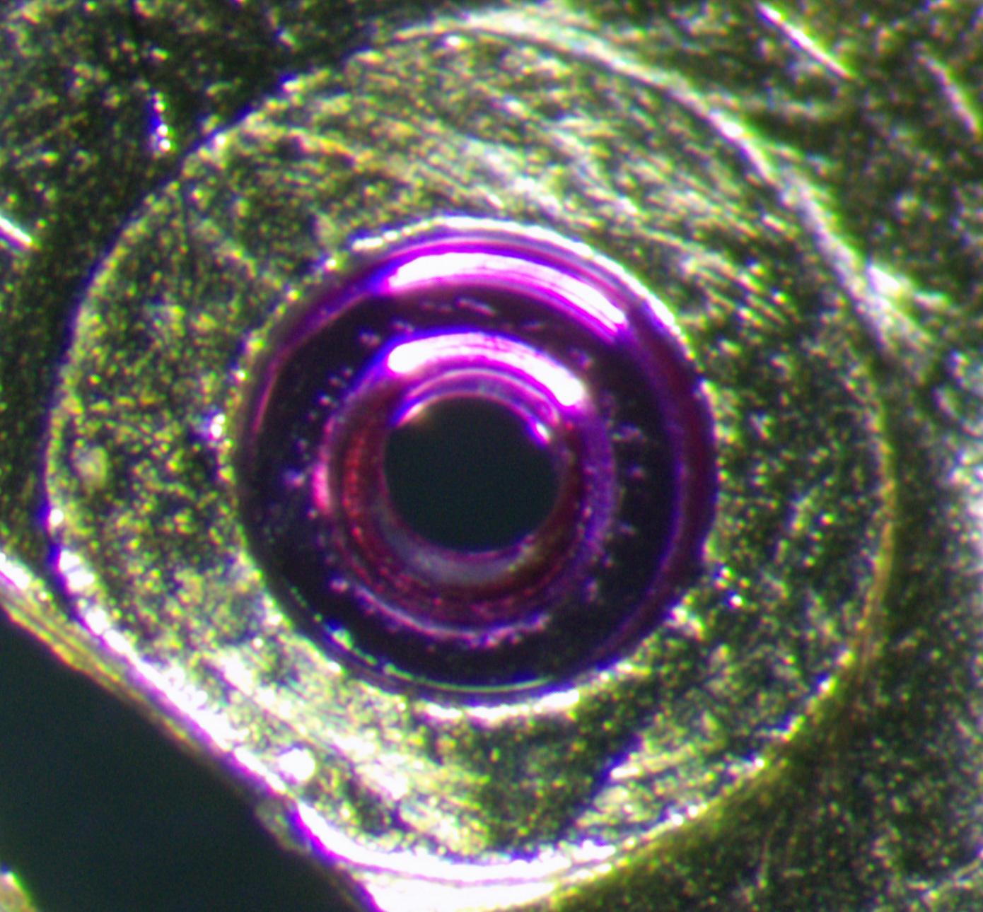

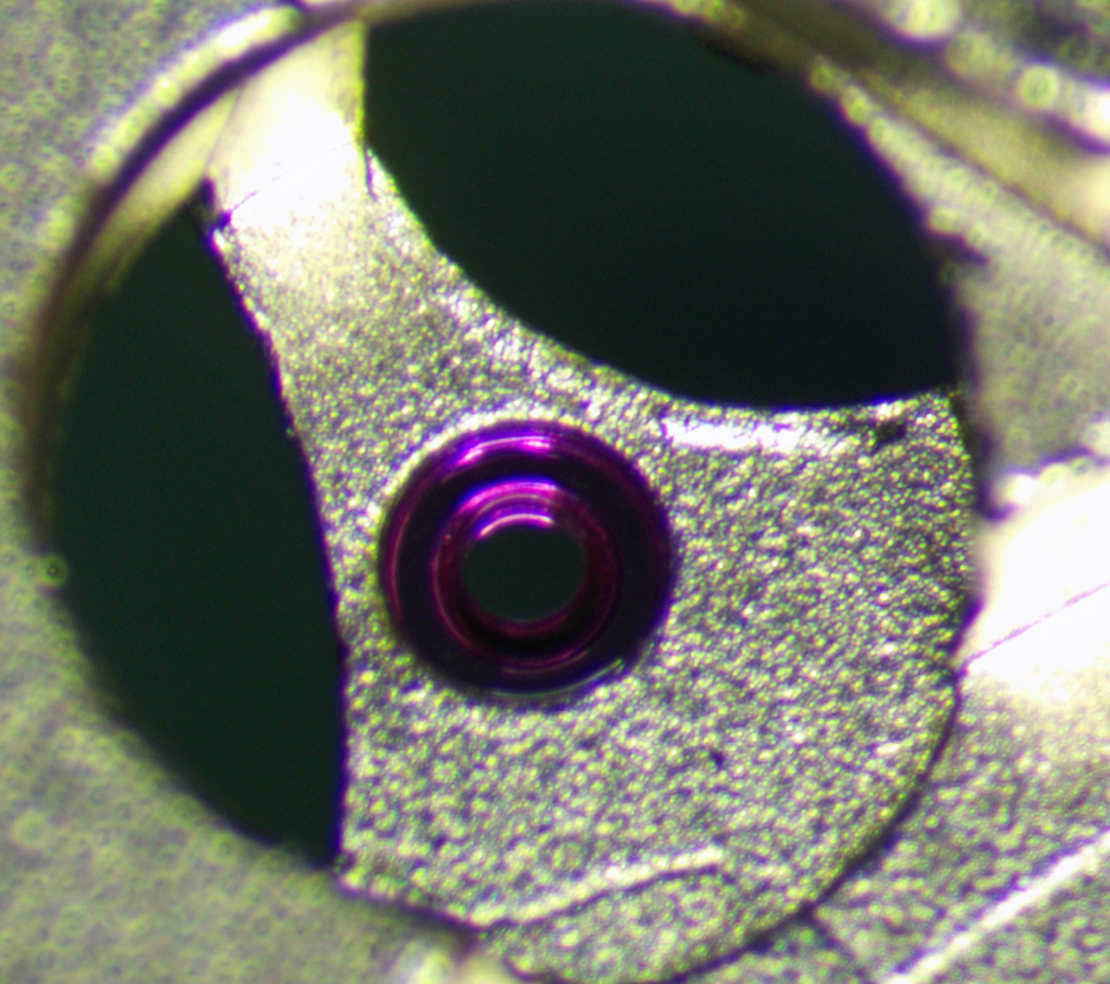

I got the train back in and it didn't seem as free as I'd like. Looks like the driving wheel with cannon pinion has zero end shake.
That could explain the low amplitutde I started with.
Now if you were me, would you push on the plate jewel or the bridge jewel?
I've attached some extra pictures in case anyone sees something else I'm doing wrong here.

Unfortunately I'm not that lucky. I started on the train side and after I noticed the binding I pulled everything out except the driving wheel to rule everything else out. It still binds.
I'm going to double check that the pinion is fully seated on the staff first, then if no joy I'll push the bridge jewel up a fraction of a mm. Fingers crossed!

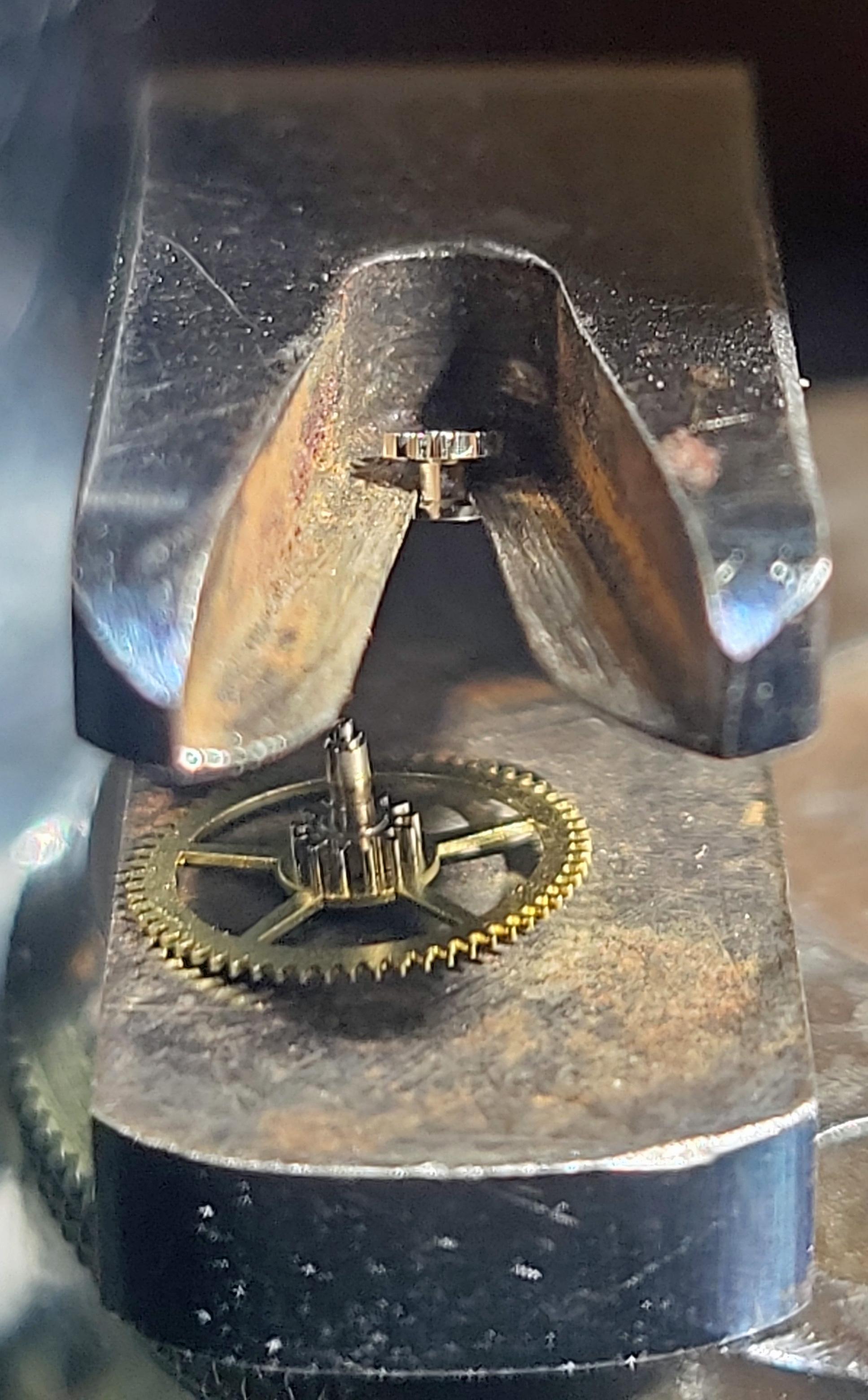

Did you take the friction pinion off the large driving wheel and grease it? Although, now that I think about it, that shouldn't have any effect on the free running of the train if the friction pinion isn't interacting withe minute wheel/setting wheel...
I did not. I thought about it, but I had cleaned it in my ultrasonic, and the tech sheet shows lubricating it in place already assembled, so I figured discretion was the better part of valor.
Although since I have to depth the jewels anyway, maybe I pull the pinion off to rule it out 100% as part of the problem.
Do you know if there's a safe way to do it? I don't want to use a puller because it would push down on the plane of the wheel, and that seems like a Bad Idea.
I thought about using a roller table remover, but I don't think I have a hole stake pointy enough to push it down.

Yeah, I saw that in the tech sheet but I don't see how it can be adequately cleaned with the friction pinion still in place.
I've accidentally pulled the arbor right out of the wheel once when I used a presto tool to try and remove it. Mark shows how he does it with the Platax tool. Those are a little too pricey for me so I got one of these from Aliexpress and I just push down on the arbor with the end of my brass tweezers. That usually gets it most of the way out and then I just grab the wheel with one hand the and the friction pinion with the other and gently rotate them until it pops off. Probably not the best way but it's seemed to work for me so far.
It was easy enough to pop off. Once I had the cannon pinion hanging on the blades of the stump, I got my #2 tweezers on the gear attached to the staff and levered it down.
That way none of the force was on the brass wheel itself.
I reinstalled it and the bridge, and it looks like a small but reasonable amount of end shake. It also spins easily with a blower. It stops quickly, but I think that's due to the large shoulder and about what I'd expect from this wheel.

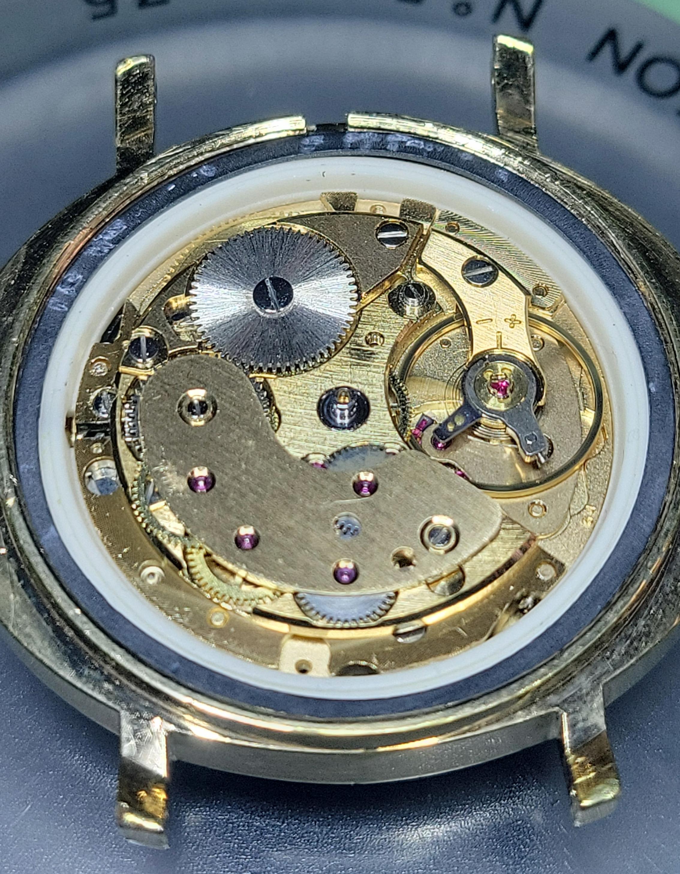

Meanwhile, got the first layer of the calendar works together and made sure the date ring snaps to both in quickset and regular setting.
The mechanism is pretty cool, so I took a video.
All right! Back together, cased up, and ready to rock and roll.
Well, after I cased it and forgot the seconds hand. And then after I found a fitting back gasket. And then after I had to take it apart again because I forgot to put the automatic rotor back on.  🙄
