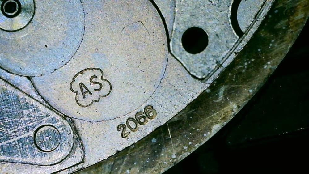

Working on an as2066, needed a new balance wheel and cock, got the whole assembly from a donor but when I put it in, the new balance assembly clearly gets stuck on the pallet fork.

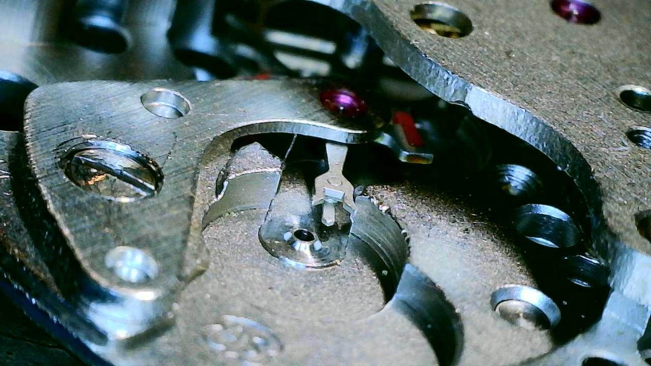

Nearly impossible to see anything there when the balance is in, here are a few pics, everything looks in order though.
Dima, this is actually possible to see. You have to look thru the opening, under the balance, in the direction shown with green arrow. You need to check where the problem is. Actually, when speaking for pallet fork adjustment, one will normally understand the pallets position adjustment in the slots of the pallet fork, and I am not sure if this is the problem. If the pallet fork is original to the movement and 'snaps' as it should and the escape wheel advances when this happens, then this is not the case. You must check how the balance oscillates free without the lever but with the lever bridge in place. Then, with the lever in place but without the escapwe wheel and the other train parts. Removing all from the plate and leaving only the balance and the lever with their bridges gives good possibility to see all from many points of wiew.
I can not be sure, but on the picture there is something marked with red arrow, like result of a hit, and it may limit the movement of the lever to the right and thus make the guard pin rubb in the roller or prevent the pallet to let the wheel tooth pass.
