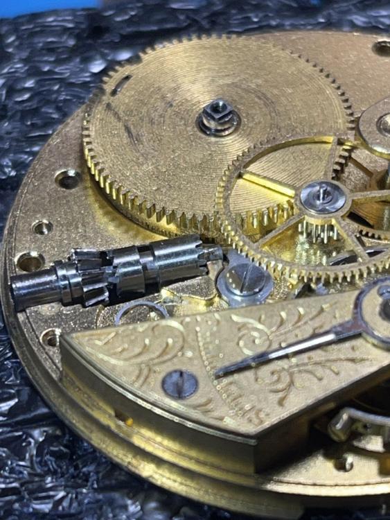

Well, I got a little too cocky thinking big of myself for bringing this Elgin 16s 7j Serial 17412116 PW back to life; only to have the winding mechanism not work once I put it all back together.  When I used my bench winder, the sliding clutch works just fine, moving to the right to engage the winding pinion.  However, when in the case, the sliding clutch/pinion does not move far enough to the right to engage the winding pinion.  Sometimes if I put enough pressure on the crown I can get it to move over enough.  It's like the stem of the crown is not quite long enough to do its job; but it worked fine before I took it out of the case.  Thoughts on what the problem could be?
One issue I've noted is that I'm not positive I have the spindle that goes through the sliding and winding pinions in the correct orientation; because I failed to take a picture of it when it was disassembled.  The spindle has a nail head on one end.  Initially I put it in with the nail head towards the center of the watch.  I think that is the correct orientation because when I reversed it, the winding mech function more poorly, feeling like there was grinding going on.  Am I correct that the nail head goes towards the center of the watch?   Thanks for any advice.
Yes, the 'nail head' is to the center. You have to adjust the position of the slieve, by turning/screwing it deeper with screw driver. If the crown touches the bottom of the neck of the case, but still not winding position is reached, then the stem of the crown is really short
While continuously solving problems is a fun thing to do and watch repair it's amazing what one photo will do. When you're dealing with American pocket watches especially when you get older it's always nice to get a picture because the older mechanisms are very very clever more clever than this. Then the center pin can only go in one way so basically it's in the right orientation gets slighted in and I usually put a little bit of lubrication on and definitely lubrication on the end head words rubbing on the parts there
Thanks for the tips guys.  I replaced the stem sleeve and adjusted it all the way down and the crown is seated on the pendant, so I'm off to find a longer stem.  This one is obviously too short.  I won't swear that it wound properly before I disassembled it; but it is my normal practice to check the winding and setting mechanisms before disassembly.  I've been out of sorts the last couple months so it may be that it had this winding problem from the start.  I'm hoping to be able to report back a successful restoration; we'll see :) Have a good day.

@nevenbekriev thanks for the tips.  unfortunately even with the crown barely catching the threads, the stem is still too short to engage the wind mech; which seems very odd to me.  Maybe someone recently re-cased the movement only to find the stem too short and then didn't bother is find a suitable replacement.

This is really strange and I will advice to check if the movement will switch normally to winding mode by pressing the internal stem with some needle or another tool.

Cool.  I will try that.  And yes, the winding mech works fine when i use my bench key and can fully depress the spindle inside the sliding pinion.

I'm a bit confused here? in the first quote above it says you replaced the stem and sleeve? So did you actually replace them with something new and different or what?
then playing with stuff at the end of the crown isn't going to change anything. The location of the stem is controlled by the sleeve itself this is why the sleeve is adjustable in the case. not only is the sleeve adjustable but they come in a whole variety of sizes and shapes for every case and variations in the length. Then there adjustable with the sleeve wrench like what is found in the image below.

Hi John, sorry for the confusion.  What I meant to say is that I took out the old sleeve (with the trusty tool you pictured).  It looked like it was already seated as far down as possible, but the upper threads on it were buggered so I replaced it with a spare sleeve I had (actually this sleeve while it fits is too long for the stem--the sleeve is not catching properly on the stem detents (if that's the right word).  In order to get more length on the stem, before the bottom of the crown bottomed out on the case pendant, I unscrewed the crown so that it was just barely hanging on to the stem threads.  With that set up, I again tried pressing the crown down to engage the winding mech, but still the sliding pinion was not going back far enough to catch and turn the winding pinion (hopefully I've got my terminology correct).
this is one of the problems with American pocket watch cases is ideally you should replace with something identical to what you took out otherwise you're going to have issues like you're having. Then yes oftentimes you'll find that the top of the thread in part because people didn't have a proper wrench is totally screwed up or practically disintegrating.
So if you have the original stem it should work you just need to have a sleeve of the proper length. Which does present challenges because we don't have the assortments and all the various sizes like we did in the past.

I wanted to report back on my progress so far.  The idea of putting a piece of wire in the crown actually worked; thanks @nevenbekriev.  I still have to push and hold the crown down to wind but I'm fine with that.

OK, but this is still not acceptable. This way You can pretty soon wear the winding/sliding pinion ratchet teeth. If the sleeve is screwed in to the end, You still can do something: Here I will open the other secret - You can add a 'piece of wire' in the bottom of the square hole of the movement part of the winding works, where the square stem enters.
