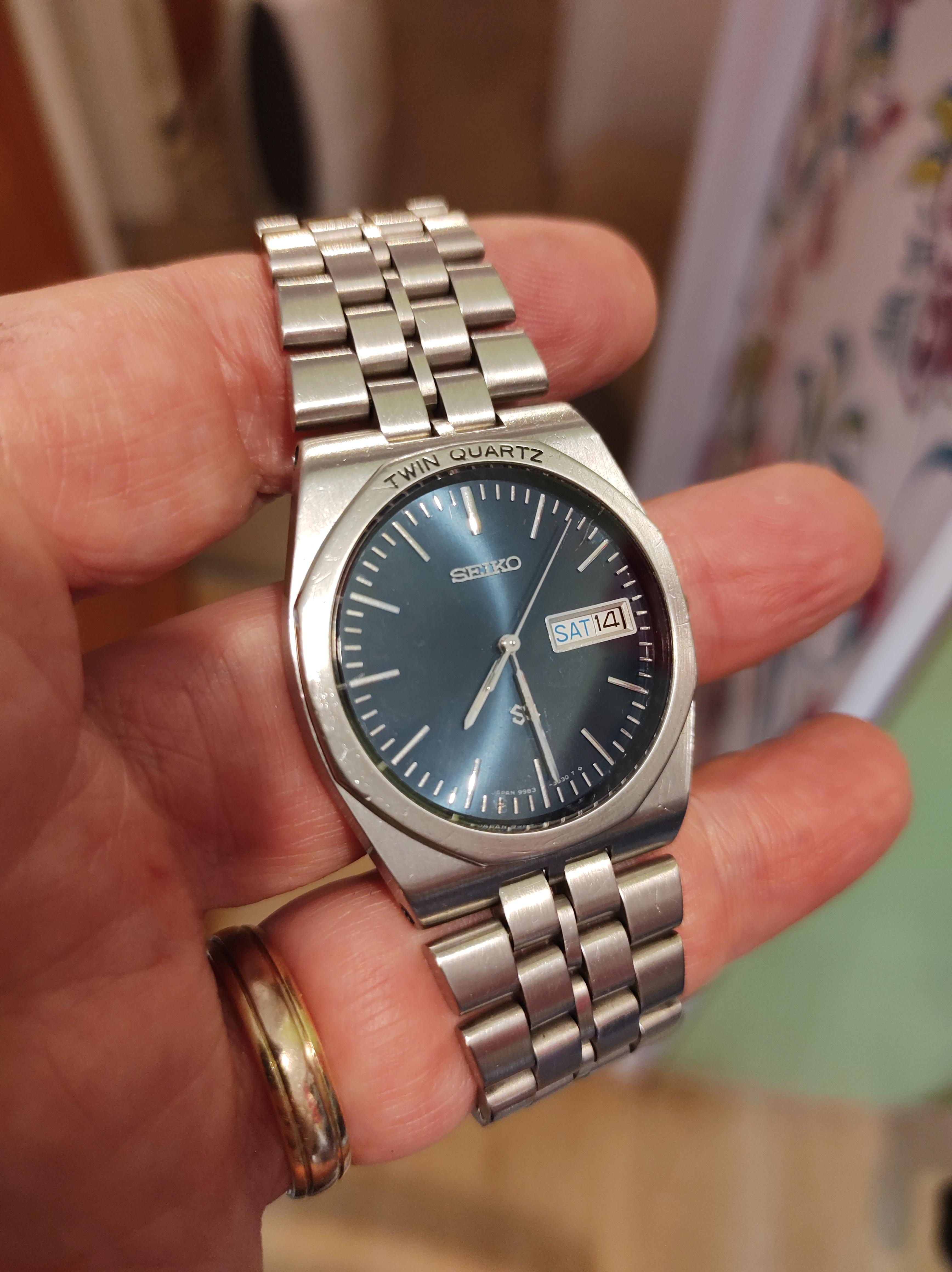

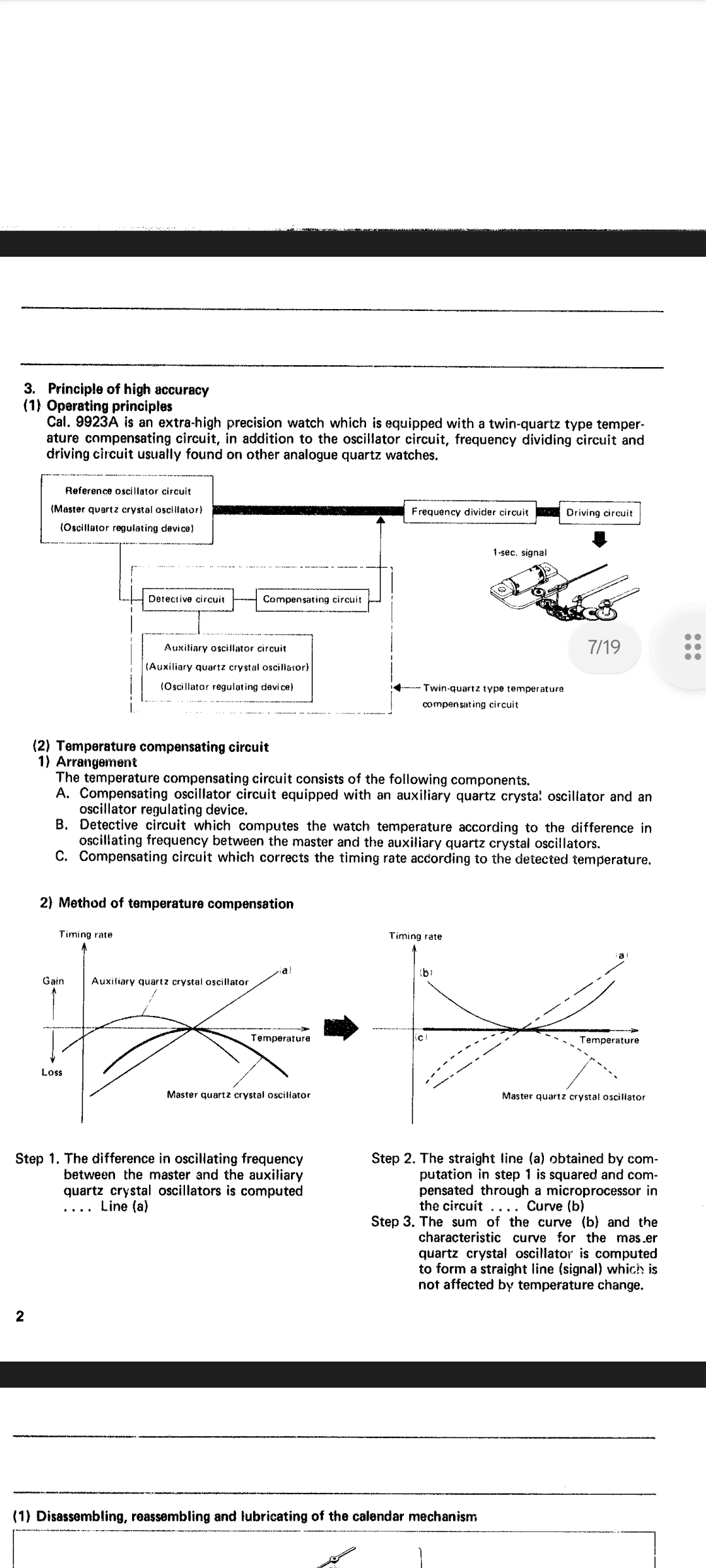

Hi, I recently received a Seiko twin quartz 9983 watch from my uncle that was in a very bad way. I believe that the auxiliary oscillator and main oscillators have both been adjusted badly in a futile attempt to make it run. Does anyone have a data sheet or information that shows how to adjust the auxiliary oscillator frequency? The data sheet for 9923 that is similar just says do not touch the auxiliary oscillator setting. Thank you.

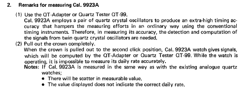

There is a tiny but a information available on regulating at least the watch that you the PDF for like this

Measuring accurately using an oscilloscope is a challenge, if not impossible.  You are correct about the load.  Additional capacitance will pull the resonant frequency a small amount.  They used to make testers that measured the frequency of a quartz watch without adding a physical load.  I have a couple, but I don't think they work.  Moreover, with two oscillators...it would not work.

then typically with quartz timing machines they use basically a capacitive pickup. So basically they're not putting a load on the oscillator because of course that's a really tiny micro-powered oscillator and everything is going to be a load. Unless you can figure out how to tap into one of the outputs like the stepping motor.

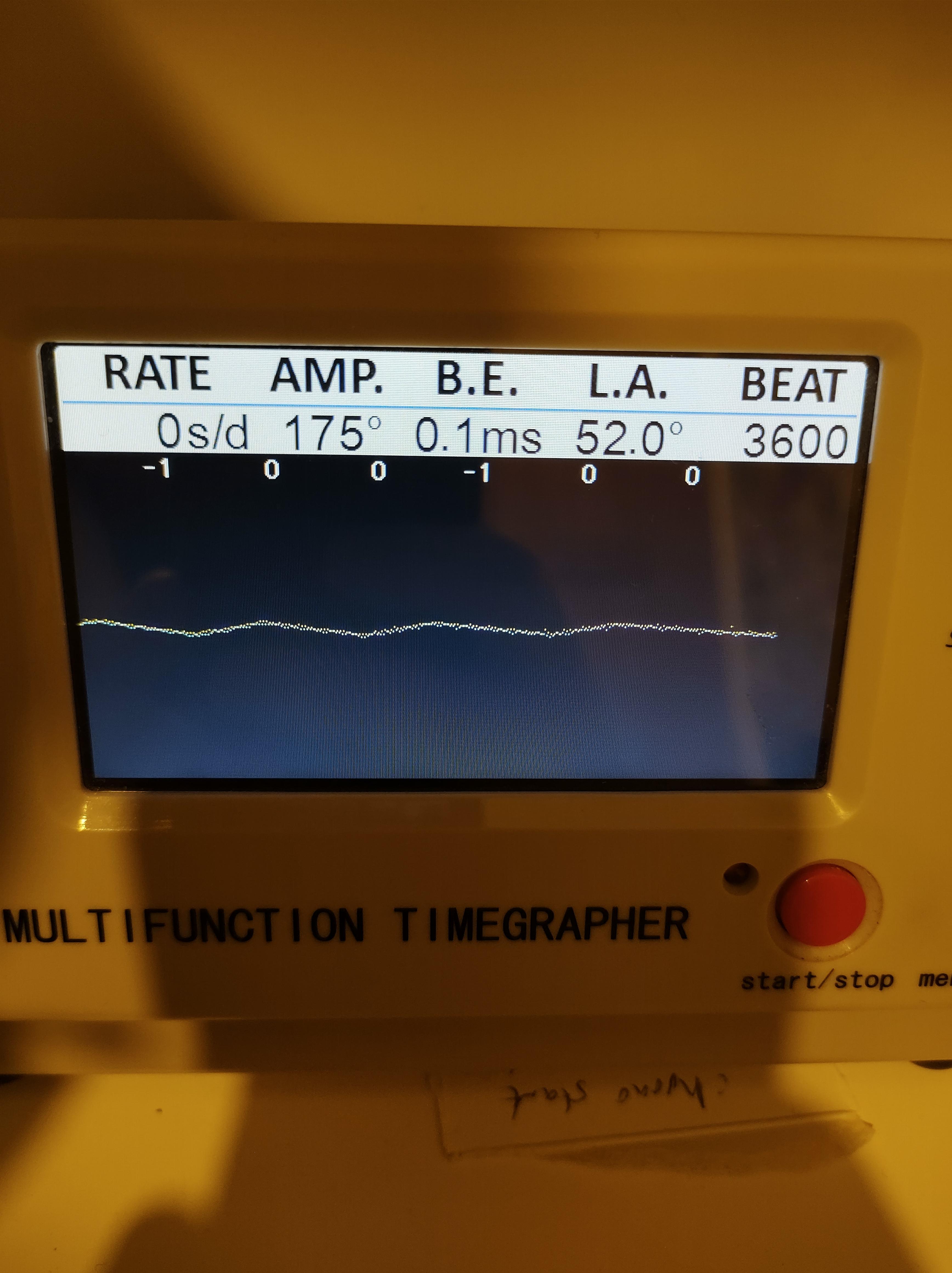

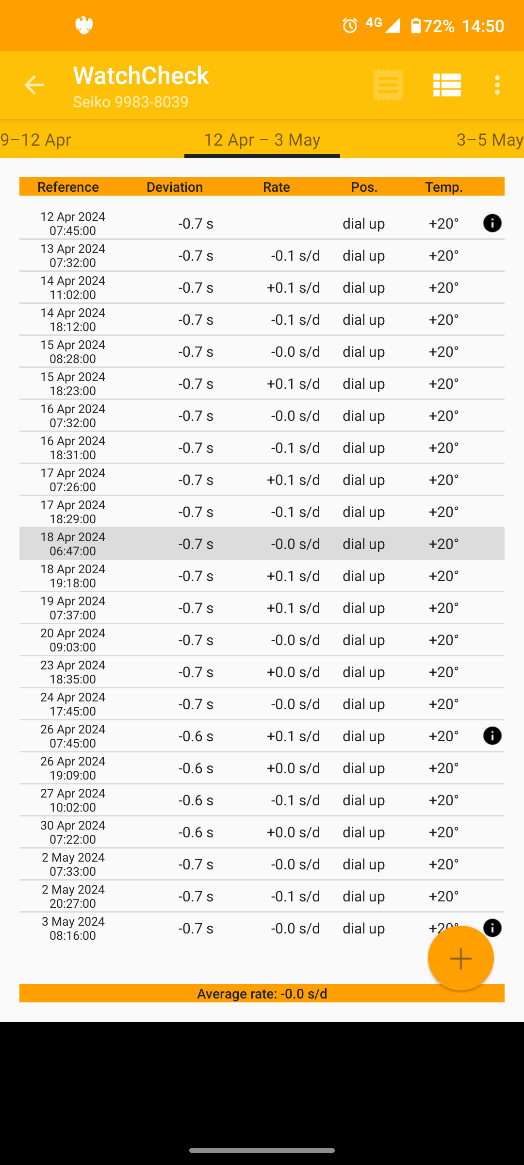

I just wanted to share an update . I'm getting quite close with the regulation. Latest is +0.1 SPD off wrist (16 degrees) and +0.04 SPD on wrist.
Some observations:

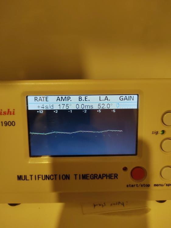

A timegrapher set on 3600 bph is a very useful tool even for quartz to get you in the right ballpark before you attempt the fine regulation. Normally you will see a noisy band across the screen but you can tell if that is sloping up or down, an indication of rate.
A hairdryer can be used to increase or lower temperature quickly. It can be used while observing the rate on the timegrapher.
If the temperature compensation is a long way out then you can see huge swings in rate as the temperature changes, as an example, from 0 SPD on wrist to +3 SPD off wrist.

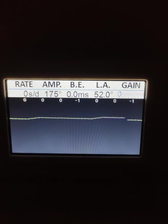

Occasionally the timegrapher noise clears up (no idea why) and you can see how the compensation is working. See image attached (16 degrees) that shows a slightly negative rate that is compensated every minute or so with a small period where the watch runs faster.

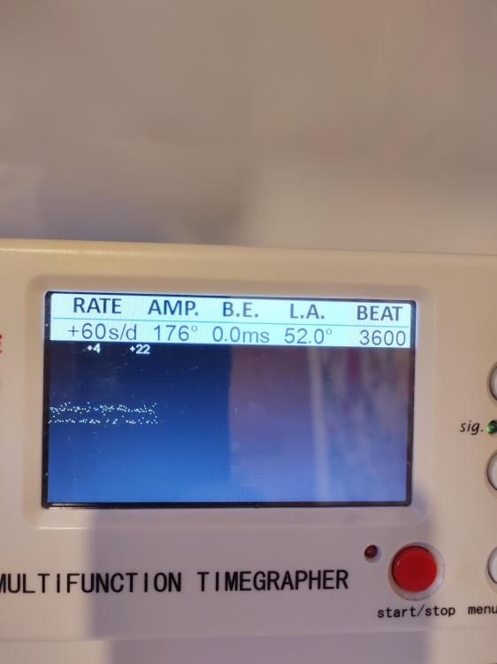

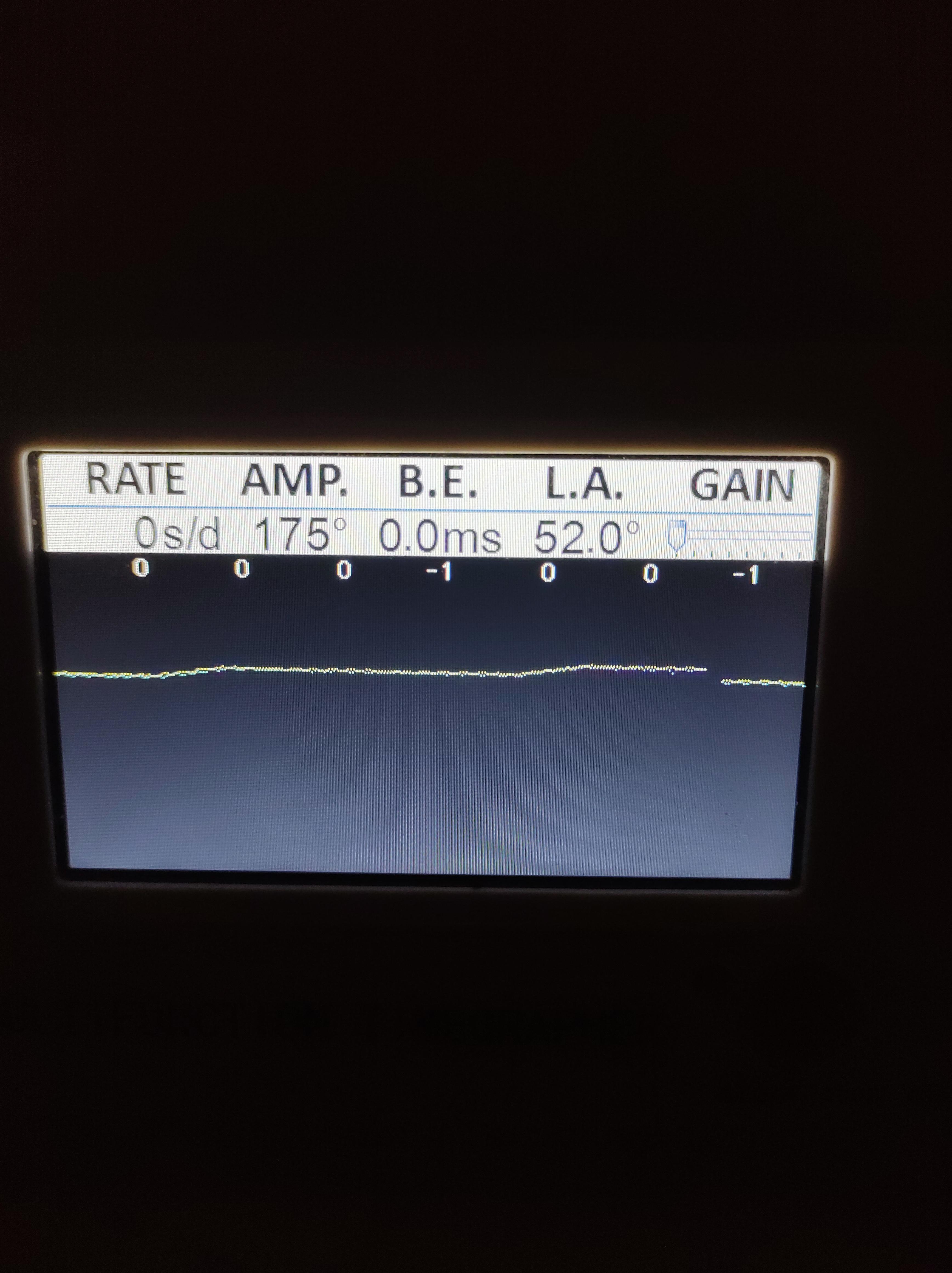

I worked out how to get the clean trace on the timegrapher. I noticed that the trace cleared up between 10:30 and 12 midnight. It clears up when the train of wheels is being loaded by the date wheel changing over.

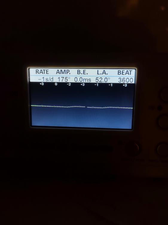

Just posting what the timegrapher shows when the watch is made quite warm with a hairdryer. Note that there are periods where the watch is losing timing (sloping down to the right). That's the main oscillator that is running a bit slower than 32,768 Hz due to the higher temperature. Then there are periods of correction where the watch runs faster (slopes up to the right). The overall rate is showing as pretty much flat after a minute adjustment to the aux oscillator trimmer, as shown by the ruler across the peaks. Note that it takes about 10 minutes for the trace to go right across the screen so it's not a quick process. Much quicker than waiting days between adjustments though. First picture is pre adjustment showing a small rate gain estimated to be about 0.1 SPD.

Update on where I am at. Watch has been running at 0.0 SPD off wrist when cold, probably averaging 16 degrees, confirmed by timing over three weeks. Currently seeing a gain of -0.2 SPD on wrist though. Watch needs a small positive adjustment to the main oscillator frequency that I have just done. Let's see how that goes.
