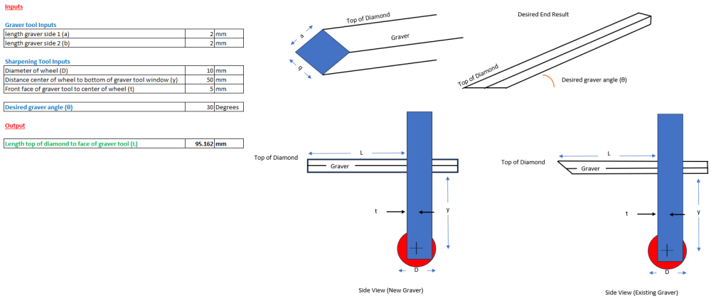

I am about to start on my journey with a new lathe, and need to make some gravers. I ordered the steel to make them and the sharpening stones etc. and planned on making a 45 degree, 20 degree and 30 degree tools to get me started. Luckily I snagged a graver sharpening tool in a recent tool job lot buy so I'm off to a good start.
I was pondering how I could get the correct angle for the sharpening process and pictured myself trying to balance everything and try to read a protractor and thought there must be a better way.... here is what I came up with:
So all I have to do now is put in the dimensions of my graver and graver sharpening tool (should only have to do once) and the angle I want, and the sheet will tell me the distance (L) from the tip of the top of the diamond to the front face of the graver sharpening tool, so in the example above (fake graver sharpening tool dimensions) if I want a 30 degree angle on the graver I need to have 95.162mm of graver sticking out, then file file away!

Just realised that the model only works for square gravers ie a = b on above drawing - head is hurting from the maths to make it work for non-square tools also.
Model also assumes that the angle where the graver enters the graver sharpening tool is 90 degrees.

I love a bit of maths but won't the angle change as the length is reduced by sharpening?  Wouldn't it be easier to cut some plastic/ metal sheet to the desired angle, align the sharpening to it and insert the graver.
Yes and no, because the length is referenced to the top of the diamond, the tool will first start to sharpen on the bottom tip  and the graver will be sitting at the 'wrong' angle eg 28 degrees, as the tool face wears during the sharpening the error in angle will reduce until, just as you reach the tip of the top of the diamond it will be exactly the angle you want - ie 30 degrees in the example above.

Thanks for all the comments. I agree that the exact dimensions are not critical to the performance of the tool, I was just trying to figure out the best way to get the angle right without making a special tool or manually trying to measure and started to calculate it on a bit of paper and then the engineer in me kicked in and "if you are going to do it, do it right" so I ended up making a spreadsheet, partly just to see if I could and partly for fun. I'll look into the glass plate.
