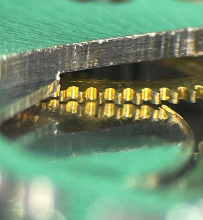

Hi all,
I'm working on a lovely Longines "Flagship" that houses a Longines 284 movement. The watch was last serviced in '94 and I know for a fact that no amateurs have been poking around in here. The watch was running when I got it, but all the oil had crusted up and it needed a service. When disassembling, I noticed an interesting wear pattern on the dial-side of the mainspring barrel.
In this movement, the centre wheel sits below the mainspring barrel. This wheel apparently has a slight bow to it and has obviously been rubbing on the barrel. I can also feel them binding if I assemble the barrel and the centre wheel and turn the barrel with some pegwood. It's hard to photograph, but I've tried:
You can see where some of the teeth have been grinding against the barrel in this photo:
Here they are in-situ, looking down from the dial side:
I have a few questions:
  1. Is it possible that this happened in "normal use", or is it more likely that the watchmaker slipped up back in '94 and bent this wheel? I can't imagine a force that could do this to an assembled movement.
  2. How would I go about flattening this wheel? I do own a staking set, but I have practically zero experience using it. Are there any resources out there with pointers on how to perform such a repair?
  3. I may have to replace this wheel entirely. I went to julesborell and found the movement: http://www.julesborel.com/s.nl/it.I/id.7/.f which lists the centre wheel as " 201/LON 280". scotchwatch.com seems to have a "Lon 10.68Z center wheel #201" in stock here - would that be a match, or have I veered off course? Any suggestions or pointers to where I can find a replacement are welcome.
cheers,
Fredrik
Hi. It is possible the previous repairer slipped up , because if he had noticed it I am sure he would have straightened it.  It is possible to straighten them in much the same way as trueing a balance.  De Carles boo shows one being straightened on an anvil with a large circular punch/ drift.  You will need probably a depthing tool to check it afterwards for flatness. Try that first you may surprise yourself and get it right.
Looking at your pictures I wouldn't even try to fix this and see if you can find a replacement center wheel. The unfortunate problem of quality control can't catch everything and isn't really a problem except over time.
If the wheel wobbles there is at least one bow.
Flattening the wheel isn't actually that difficult, I do it in situ with a pair of tweezers.

I ended up flattening the wheel by placing it on a staking block such that only the rim of the wheel was supported and lightly pushing on the spokes immediately surrounding the pinion with a suitable stake. I can't discern any bow to the wheel, and it no longer touches the barrel.
Thanks for all your tips guys!
