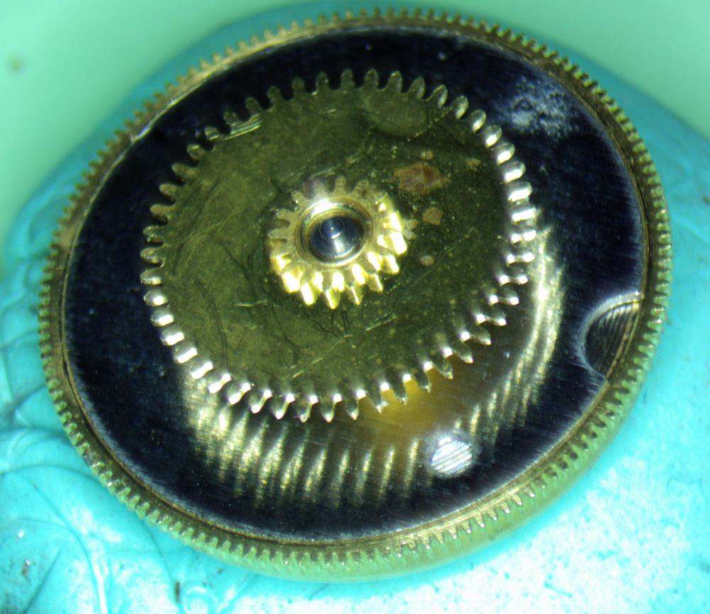

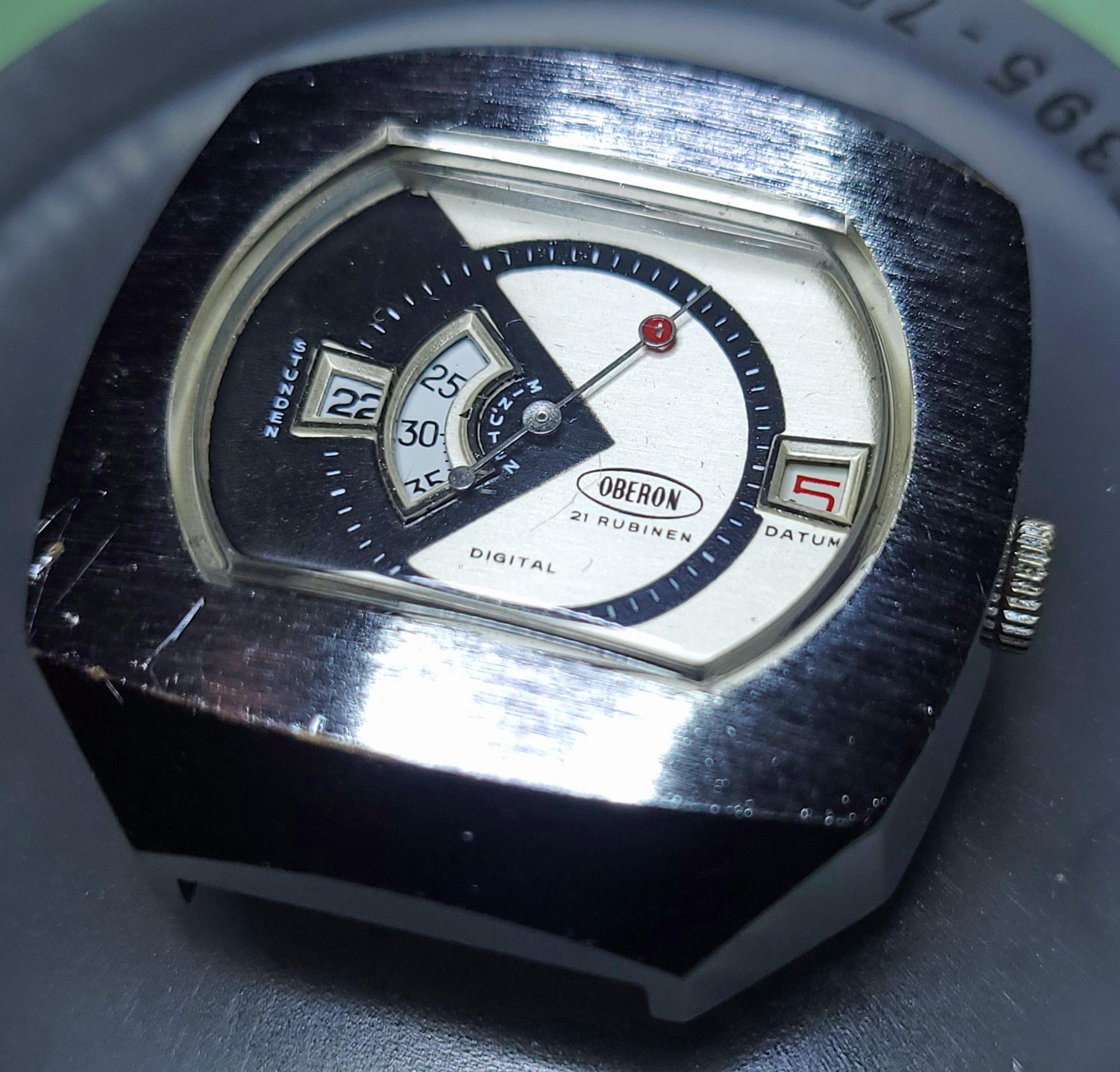

I love jump hour watches, and I couldn't resist this black and white Oberon. Overpaid for it a few months ago as "needs repair," I'm finally tearing into it now.
It looks like the previous owner did the old "soak it in oil to make it run" trick, but it was definitely not running. Came to me fully wound. The balance seemed free, but wouldn't oscillate, so I set about disassembly.
Everything, including the dial, date, minute, and second rings are completely soaked in oil.
The main plate is marked BF 866, which looks like Baumgartner's mark.
Now I just have to figure out how to get the barrel open.

Well, there's your problem. I don't know what that black crud is, but it was definitely gumming up the works.

You get to the mainspring just the way it looks- silver lid and wheel up, push down on the edge of the barrel. The big thing here is there will be dried up lubrication in the lid. The link to Jon’s lessons below has what you need to know. I’ve done a bunch of these and if the pivot holes are good (or you get them there) they can run quite well. I followed all of Jon’s Roskopf series..

Thanks for these. I was able to get the center seconds wheel off with the Presto tool I bought for Bulova sweep seconds hand wheels. Finally came in handy again!
But for the life of me I can't get the minute wheel off the lid of the barrel. Even with my largest hand levers and carefully prying only at the center, I can see the wheel flexing as I apply leverage. Any other techniques besides the one shown here?

I had not seen using the razor blades when I did it. I recall much twisting and prying at the base like opening a case back, close to the center so I didn't bend the barrel lid.  I used hand levers and some cheap collet levers. The tension comes from the tube where the arbor sticks out of, so I pry at that a bit, too. You have to take a punch to tighten it back up anyways...

A little more love with the hand levers did the trick. I assume when I rivet this back on later, the minute wheel should not easily rotate on the shaft. The Powerpoint says "Check the friction with each tap" but that could mean a lot of things.

When you initially checked the hand setting before anything got disassembled and you thought it was 'Goldilocks'... Not too tight and not too loose when setting the hands, well when you get to the friction-fitted minute wheel, you would turn the minute wheel above the barrel which is friction-fitted in place and 'feel' how tight it is. That is the tightness you want to 'feel' when replacing the minute wheel and using a domed punch in your staking set of the correct size to slightly splay the collar that passes through the minute wheel. That's why it is important to check that tightness on each hit of the punch because if you go too far the hand setting will be really tight, but also you'll need to remove the minute wheel and start again. Knowing that it can be hard to remove the minute wheel, if you have over-tightened it, it will be incredibly hard to remove, hence making those hammer blows light and keep checking the tightness. After you have had the experience of what feels correct a few times, it'll be child's play afterward. remember to check the minute wheel and barrel cover after removing, so that it is absolutely flat before replacing. You can see why the minute wheel needs removing by the amount of old grease in there, by your pic. Most of what I've explained is in the presentations.
The slide I show using razor blades to rest the hand levers on is pretty important, as too much pressure will be put on the barrel cover and bend it. In fact, if you have a washer, cut it in half and that makes a better support, as it will rest on most of the barrel cover.

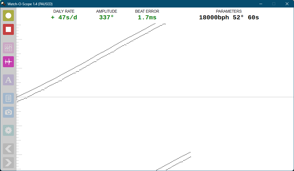

Off to a good start! I'm going to let it run in overnight before I make any changes, but from a non-runner, I'm happy to see this. These are about 10 minutes off a full wind.
Since it's a pin-pallet, I know the amplitude is probably reading wrong. I tried both Watch-o-Scope and PC Timing Machine 3. I seem to remember there was a piece of software that worked better for pin pallet escapements. Anyone know what it is?

Sorry but I do recall a video and/or post what had software that showed ‘pin pallet detected’ or some sort on the screen. Since you have watch o scope and the other- isn’t there open source Tg Timegrapher  for PC?
I’m in mac world so haven’t bothered…0
Well it didn't say anything about detecting a pin pallet, but it does agree with the other two, roughly:
The amplitude looks pretty close based on the super slow-mo, too.

Use Dr Tillwich blue oil for the pins. A couple drops on the top of the pins and let it run down.
Expand
I agree with this and its something I have started doing with most of my pin type pallets, its amazing the difference it makes.

For now, I cleaned up the case and polished out the crystal, which badly needed it.
The second hand was pretty well bent, so I gave it a gentle straighten. It also needs to have the circle re-filled with red paint. What would one use for that?
Then I happened to have a nice brown leather band to try out, and I like it. I'm thinking it'll look even better with black leather.
