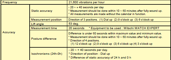

36 minutes ago, Conundrum1911 said:
I guess I just find it odd given this is supposed to be a more "premium movement" than a NH35, but none of my NH35 based watches exhibit the same level/amount of increased gain or loss as they wind down (they do in maybe the last 20% before they die, but not before then).  But maybe this is par for the course with the 9000 series.
what is the definition of premium? Because there is something in your specification that's different than and I'll get that in a moment let's look at the specifications for your watch timekeeping sucks at least by specifications but we also get this?
now this becomes interesting because and off to find some other specifications for you but to look at that watch within four different pendant positions and giving you a timing range. Not the kind arrange your expecting for a chronometer grade watch but still there looking at this watch in more than one position
50 minutes ago, Conundrum1911 said:
NH35
let's compare specifications
now farther into the manual you get something similar
now notice similarities fully wound up watch is done between 10 minutes and 60 minutes where did we see that before? Notice on the second image they say static accuracy versus on your wrist. Notice the only give three positions for timing versus up above with ask you look at it in more positions which technically does make that a more precise watch. Then they also give you timing machine specifications minimum of 20 seconds and stabilization time when you rotate the different positions.
then you'll notice the specifications above isochronism once again in a static position. This tells you 24 hours after its wound up that is what the timekeeping specification should be. This is your specification for basically amplitude variations. You will note that the watch you asked about it doesn't actually publish that it only has its specifications as a fully wound up watch. On the other hand it does specify more timing positions than this watch which as I said would make it more precise
oh and to understand the positional things I've attached a PDF. If you're hoping at your timing machine to give you a better prediction of what the watches doing you then need to time in a whole bunch of positions and do a whole bunch a math unless of course you buy a fancy timing machine that does that for you or some of the software timing machines will do this also. They will actually give you a number which gives you an approximation of what the watch should do on the rest. Versus one position on the timing machine that's not going to represent a watch on a wrist

Thanks, and I do get most of that, I guess I just find it odd that Seiko does list a 24h value and Miyota does not.  That is sort of what I was asking too, if Miyota says -10 to +30, are they also saying similar for the first 24h.  Most of my Seiko based watches are all in the  +5 to +15spd range but I haven't noticed that change much with amplitude (so they might not be accurate, but they are very consistent) whereas this Miyota 9039 seems a bit more random depending on wind even if amplitude stays close to the same.  Positionally though, the 9039 I have doesn't seem to change much or as much as my NH35s do.
