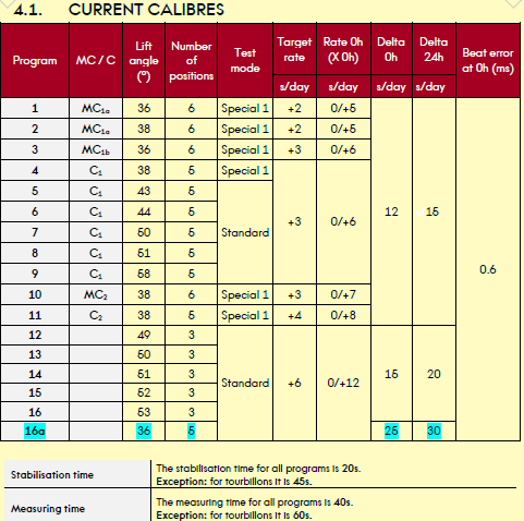

So which document are we talking about that's quite old? I made a reference to the documentation I was looking at I didn't say which one I was looking at. Then for an air of this type how fast with the noticed a problem? Then you'll notice in some of the images I'm giving you things are highlighted if we looked at the back of a document it would be a reference to those of the updates from the previous version so yes the really do update the documentation.
what you need is something called WORKING INSTRUCTION N° 28   25.11.2020. Yes 2020 is really old but if they haven't figured out there problem by now they probably never will.
Now to explain why you're only getting snippets out of the documentation the only way you can get this is you have to have Swatch group access yourself or find something that does have Swatch group access it's not available as far as I know anywhere that you can download. Then Swatch group is paranoid with the documentation let's give an example from when they used to give some documentation out that cousins have
So seeing as how every single document downloaded office watch group as a watermark in the corner complete with the data is downloaded etc. how would they feel if somebody just distributed the world? You know what a pain in the ass it is to get anybody that even has a Swatch group access so know you're never going to see the whole document best your analyses of somebody kindly snips out images Trying to avoid the watermark
So for an 1120 in the image below its programmed number eight. It's chronometer grade watch there is the frequency and the 200 is the amplitude at 24 hours. The plus -10 is when the calendar should change in other words you calendars should change within 10 minutes of midnight. The 44 is therunning time and I could care less about the number two as I'd have to go and look up what it actually means.
Now let's go find the programs I don't really like the newer documents to things are fragmented versus the old stuff which will see below
 Now this is weird 2016 I'm not seeing your watch? November 2017 it shows up and looks like it's 51°.
Now if you're not seeing the amplitude you perceive you're seeing with the correct 51° they really should look at how your measuring or amplitude? If you're using anything that resembles phone apps are apps that do not use a standard watch type pickup that lead the problems sometimes with watches are in heavy cases the case will have a dampening effect that can have issues
but no matter what it looks like 51°
