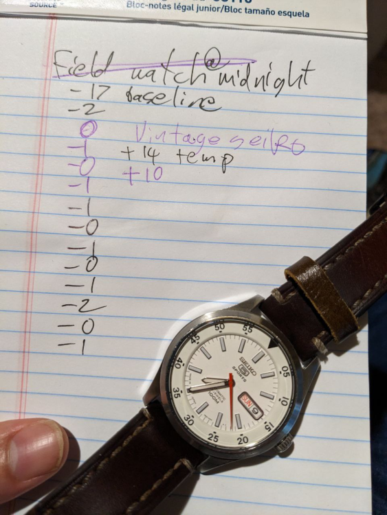

I'm only making this post because I'm now convinced it's not a fluke. I've only repaired/serviced 6 movements now. All of them either 7s26's or nh36's with the exception of a seiko 7006a. When i dove into hairspring fine tuning for adjusting the regulator pins and working with the etachron system and of course trying to do a PERFECT lubrication and cleaning, the first watch i REALLY put in the work on to try and get my delta as small as possible over the course of almost two weeks never deviated more than 2 seconds a day of on the wrist wearing. I've been told how inaccurate this movement is since i got into this so I figured i just won the manufacturing tolerance lottery. This was after timing on my wrist and then changing the rate to reflect that deviation and just checking every day at the same time.  Even months later that watch is STILL running with average deviation between 0 and 1 second a day.

COSC or any other accuracy test certificate doesn't specify the materials to be used in the movement. Nor does it have anything to say about the standard of finishing. It is a test to determine the timekeeping accuracy of a movement in different positions, at different temperatures and at different power levels (mainspring wind). Interestingly, COSC doesn't say anything about how long the movement will retain its accuracy, nor even if the same accuracy will be reproduced when the movement is cased up.
You can have a can have a watch which is very accurate when the owner wears it (but maybe not if someone else does, or if left to run down on a cold windowsill) which will perform terribly in COSC testing. The other way around is much more unlikely.
What you have probably managed to with your watches is to average out the errors under a controlled and unvarying set of service conditions, i.e. on your wrist, following your daily routine. You have done it very well indeed, so congratulations.
