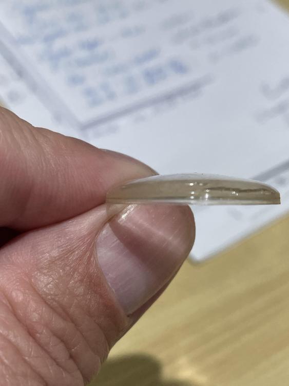

I'm trying to find a replacement crystal for a Mido Multifort automatic (seems from the 40's or 50's). The crystal is rather crazed, so no saving it. It looks like there is a bit of a lip around the edge of it.
The current crystal measures 24.12 mm in diameter. The bezel measures 24.0 mm inside diameter.  It is about 2.5 mm for the inside height. It was friction fit into the case, quite snugly.
If I look at the G-S catalog, it seems that PA-260 and PA-285-5 are my choices at 24.1 mm.  PA-285-5 seems closer to the dome shape as the current crystal.  Does that seem right?
If I look at the Cousins website, I'm not sure if this would be considered high dome or low dome.  If I look at the Sternkreuz "HWS" Glass Dome Heights pdf file on the site, the internal height matches up for the diameter range this crystal is in.  So, maybe high dome?  HWS is "high dome with step", so is that lip I see around the existing crystal considered a step?  If so, then HWS242 would seem to be the one to order.  Does that seem right?
@gpraceman, a post I made a little while ago may help you a bit: https://www.watchrepairtalk.com/topic/25000-tension-ring-crystal-nuance/
If you scroll through the post, I eventually get around to comparing two Sternkreuz crystals I purchased from Cousins (standard and high-dome).  With only that comparison as a reference, the crystal in your photo looks more 'standard' than 'high-dome' to me.

Hard to tell the difference to me visually between those two.  They look more bubble like than the old crystal.
I ordered the high dome with step, as it seemed like the high dome was the appropriate internal height for the diameter of the crystal from the reference PDF file.  Should know within a couple of days, as it looks like my order made it into the US and through customs.

I have popped out the old one (has a crack in it) and measured it at 26.26mm.  The case dia where the srystal fits is 26.25mm so I assume the crystal has shrunk a bit being plastic and old.  I will order a 26.3mm and a 26.4mm replacement.  Would you agree?
The only thing I wanted to clarify is the style.  I think it is a PK - Low Dome.  Refer the pic below of the crystal.
Thoughts?

I think each mfg. has different profiles. This may not be a GS crystal. I suggest you buy several styles and pick the one you like. I prolly have some PK crystals...will post a picture later if I do.

PHD
to make it look like the standard ordinary round crystal in other words PhD. Which used to be standard but now with all these glass sapphire and other crystals may not be standard anymore. At work somebody came in with a watch needing what look like a PhD crystal and they were a bit bewildered as to whether they could even get the crystal or not. Because they're so used to putting the last C and all day long or sapphire
