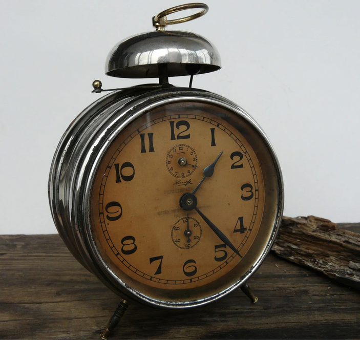

I seems to me that your BPH is way off. Not sure what you are testing?
Pocket-watches often 18,000 BPH, most modern watches 21,600 or 28,800 BPH. Not sure what 10,800 BPH does, an old alarm-clock?
Also, when the amplitude is that low, your reading may be bogus readings. You can "physically" verify the amplitude of the balance wheel with your smart-phone. Take a 10-15 seconds slow-mo video of the balance-wheel and watch the video in slow-motion. Take a point on the balance wheel (a spoke for example) which you can follow. If that point makes a full circle (180 degrees to the left and 180 degrees to the right) you have an Amplitude of 180 degrees. If you W-o-S reading is correct with 143 degrees, than the observed point should make a 143 degrees rotation to the left and a 143 degrees to the right; about 40 degrees less than 180 on either side or about 50 degrees more than 90 degrees on either side.
