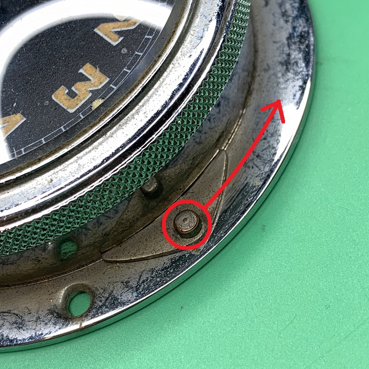

This is my first foray in working on clocks as I'm more accustomed to working with watches so I'm more familiar with watch repair techniques and identification. With this beauty, unfortunately, it didn't have any brand names on the dial and the back yielded no information either. To access the movement, you have to loosen the screw located on the side of the bezel holding the crystal and lift upwards.

Hi what you have is a dashboard / bulkhead clock,   Some were made by simiths others Swiss made. The only way to tell is open it up and look at the movement. Smiths usually had the name on the dial. I have on which uses the bezel wind and it’s a Swiss movement, open it up and post pictures of the movement.   Cheers
You will need to remove the movement from its case. It will have a platform escapement so you will need some pocket watch oil for that, the rest of the movement you should use Windles clock oil. I'll comment further when I see the movement.

Here's a couple more pics. Aside from dirt, it was oily as well. I'm hoping the accumulation of dirt wasn't abrasive enough to ruin the pivot holes or other bits.
Normally if the movement is swimming in oil providing the pivots are well oiled little wear will happen to the pivots. That's a good sign with all that dirt because that is telling you a good clean and new oil will be all that is needed and a little adjustment for time keeping.
If the clock was installed in a military vehicle dash board I can imagine the dirt and condition they worked in. But like OHippy said the presence of oil means a good clean and off we go. The dial is most likely to contain radium as its from that era late 30s thro 40s and will have to be treat carefully as it’s condition looks flaky.  I think windles will cover all points regarding the oiling.  Cheers

I found out the reason why it got dirty. The flange that allows you to adjust the clock speed came loose thus leaving an opening for dusts and debri to get in. See the before and after pics where one can see the slot opening and the other where I temporarily placed the regulator/flange.
