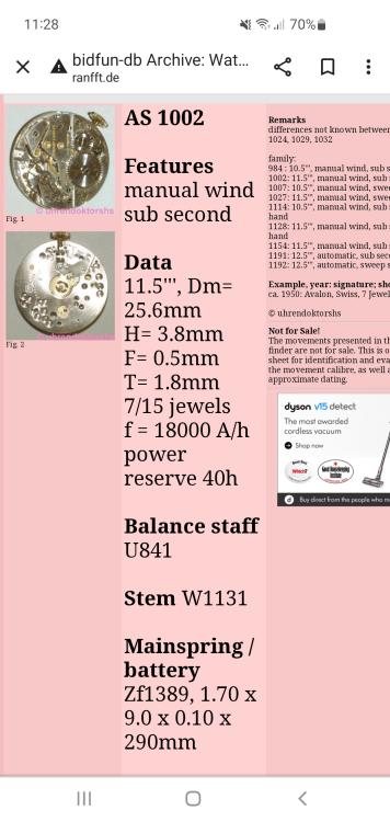

3 minutes ago, watchweasol said:
Hi  Not  found a service shhet on my usual sources but if yo look at ranfft  as1002 he has a sheet with a lot of data.
I have looked there already. thanks

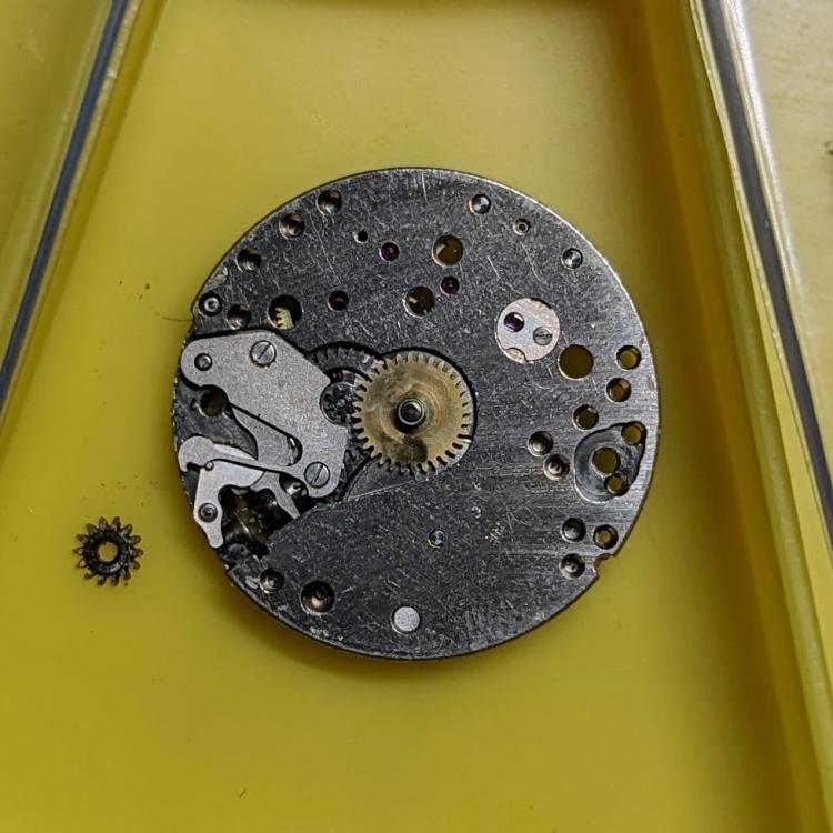

Hi,
I have just removed the balance. As you can see the movement number is AS 1002 / 984.
Has any one had experience on working on this movement?
Just, oils used, anything i need to be made aware of!
2 minutes ago, jthing said:
what serial number do you refer to?
As on the movement you can see AS 1002, with 984 under neath.
Couldn't find it searching on ranfft, so Googled AS 1002, the family is on the right of the page. 974 is there too. Measure the movement to determine which one it is.
1 minute ago, jthing said:
ok, thanks.
so if its a 984, is there any technical manuals?
I have looked but there seems to be nothing.

AS984 / 1002 is a nice basic sub-seconds time only manual wind movement so about as uncomplicated as it gets. You're highly unlikely to find a service manual for it but all you need to do is to follow a logical system of work, work slowly, don't force anything, and take pictures of every step of the strip down as reference for when you put it back together. Also make sure you let down the power before you start, and it's good practice to remove the balance cock and balance and put it somewhere safe at the start of the works, that way it's less likely to be damaged.
One thing to note (and I have just checked this on a 984 in my parts stash) is that both the crown wheel screw and the ratchet wheel screw are reverse (left hand) threaded, so turn clockwise to undo. Otherwise there should be no real surprises.
I have attached a copy of the BHI guide to lubrication which should be more than adequate for your movement and is a good starting point for most clocks and watches in the absence of anything more specific.
If you get stuck on anything just ask on here.
