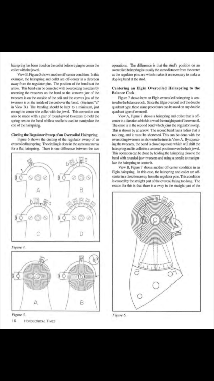

Also if anybody on the community can give me a little guidance on my first ever hairspring adjustment. I got the balance complete off the cock and was a little disappointed to not see an obvious bend or kink in it that needs to be straightened but I have a feeling i know what needs to be adjusted. I'm not sure i have the tools to remove the actual hairspring from the balance wheel, if i do i'm unsure how to do it, it looks like nothing can really fit there? But i see people do minor adjustments with the balance complete still put together so I think i'll opt for that.
So here's the balance, you can see it's off center. The curve the regulator arm engages with appears to need adjusting as it is not centered in the pins past a certain point. I know the principles of how to adjust it, that the hairspring needs to remain centered in the regulator pins through the span of the amount the regulator arm can be adjusted.
Here's the balance off it. It looks like the curve the regular arm covers when you move it needs a slight adjustment on the end closer to the stud? I've never done this and i got one shot at it so any guidance before i try it would be appreciated, if somebody wanted to mark where i should go for that would be super useful. Perhaps there's a way to get the hairspring and collet off the balance that's easier than it looks? It just doesn't look like a normal hairspring collet.

Good to see its all coming back together! Wish I could give some advice about the hairspring
There is an excellent article by Archie Perkins in the July 1996 Horological Times that explains circling the regulator sweep and centering the hairspring on the cock. Sep 1995 issue has articles by Perkins and Fried on hairspring manipulation. The Fried article (continued in Oct 95 issue) is the bent hairspring chapter from his Bench Practices book.
Ok this is super helpful. It looks like figure 5a is similar to what i'm dealing with but with the adjustment needed in the middle of the regulator section of the regulator arm part of the curve as opposed to the kink before it. But it looks like i have to have the hairspring off of the balance wheel to do this so i can see that the collet is centered on hte pivot hole. I can't find a video of somebody removing a damn hairspring from a 700X balance wheel. They don't seem to have a normal C shaped collet and i'm afraid i'll destroy the thing fiddling with it without knowing what i'm doing! @gbyleveldtor anybody who's worked on these 70's seiko movements. What is the correct procedure to remove the hairspring from the balance wheel? I got a feeling if i can get the hairspring off the wheel this will be a pretty simple adjustment.

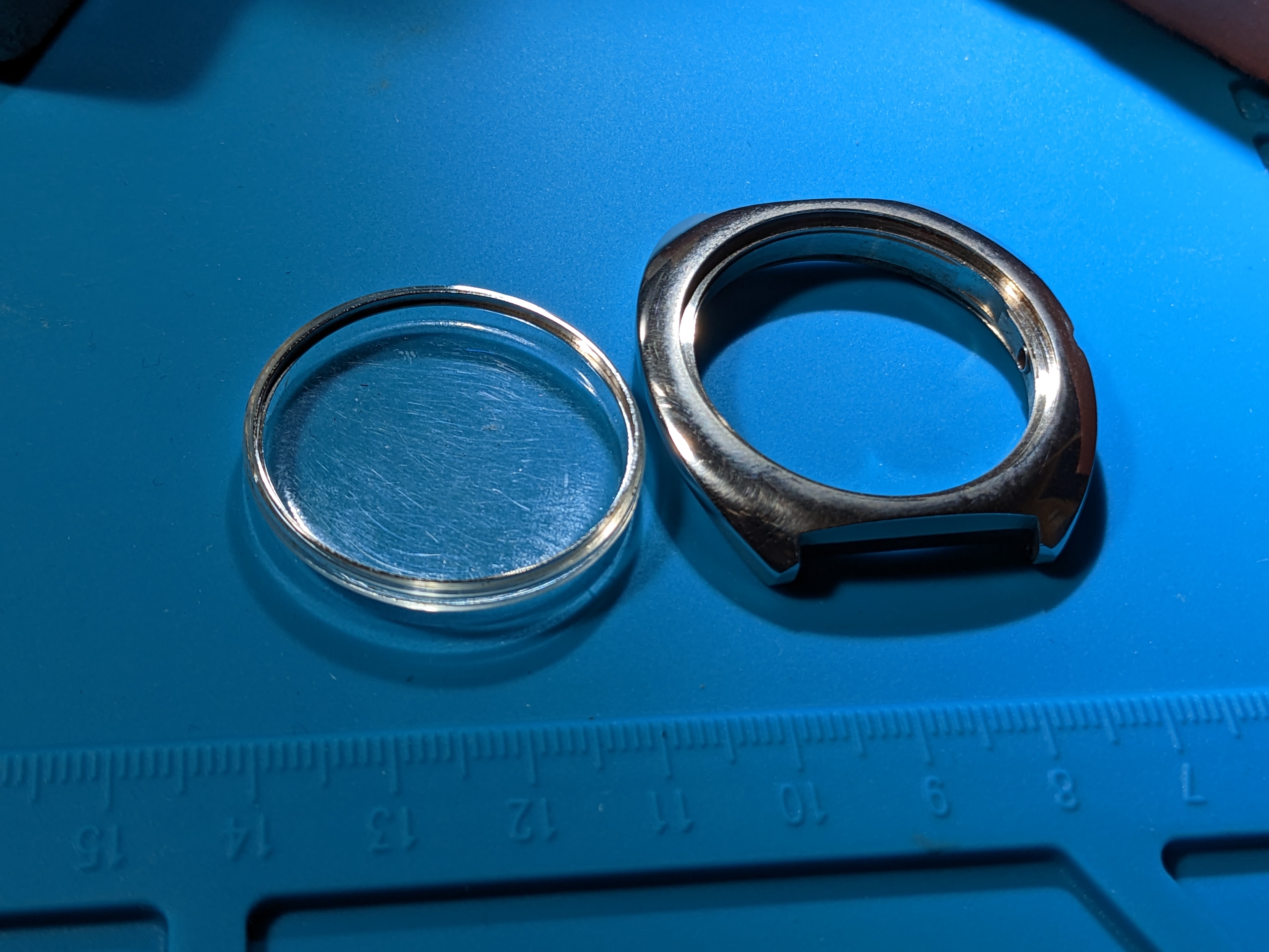

Ok. didn't get much time to work on this but i'm assembling all the stuff i need to buy for this and several smaller projects on cousins so really trying to get my ducks in a row on this and i'm a little in teh weeds on matching the crystal and stem gasket.
So i pulled out the crystal and to my disappointment, it's a weird ass one. One of those tension ring acrylic crystals i know nothing about but there's a ring on the inside of the crystal that comes out. The dimensions of it are 32mm diameter X 4.318 height. The ring width is 32.98. I'm a bit unsure how you match this. I did however find an ebay listing claiming this was a match for it and cousins has it in stock. I jus twould like to make sure this is accurate before buying two of them. THere doesn't seem to be any sizing info on cousins to actually match these so how on earth would you know?!
Here's the link. https://www.cousinsuk.com/product/special-profile-sternkreuz-xac?code=XAC321636

Then there's the crown gasket. The one that was in it was shriveled up and hard as a rock so i don't think i can trust the dimensions on it nor can i find info on oem dimensions nor have i really seen one that looks like it.
 It's not an O ring it's almost more like a tiny cylinder? I had to break it to pieces to get it off the crown but best i can tell the measurements should be.
1mm (or smaller) Inner diameter X 1mm height and I'm unsure of the outter diameter. The shape looked something like this.
The diameter of the crown tube opening is roughly 2.2mm. The closest match i can find is 2.5 mms so i have no idea if that is too big. WHen you're using an unknown crown gasket should you base the outter diameter on the size of the crown tube? On the thickest part of the stem? I just don't know the best practice here and can't find info on it.
This is what the crown looks like so you can see it's a sorta elongated space where the gasket would be. PXL_20230213_091502809.thumb.jpg.530a0b06cb4aff7b06d8f6bc69212f9b.jpg

Any help would be appreciated @aac58You seem to be one of the few people that works on seikos so any tips would be appreciated.
The stem gasket is probably a DJ0060B01, Cousins have the compatible D Ring, Ø2.05 x 0.60 x 0.80mm (look for G39086) May be other though.
Let me know your watch model number and I'll try to find out the cristal too.

If the watch is 7006-7020 then:
- Crown gasket: DJ0060B01, Cousins look for G39086
- Caseback gasket: FH2920B03, Cousins look for 29203100C
- Crystal: 320T21ANS0, Sternkreuz XAG 321.635, look for S14731

According to this site https://www.emmywatch.com/db/movement/seiko--7006-6020/ it's EJ0060B01 but i don't know if that's true. Boley's database has given me a lot of wrong info. A japanese site does list my case code as compatible with that particular part but lists it as a chrono pusher gasket. Thanks so much for looking you rock!
The case code is 7006-6020 If you do find the correct crystal i'd love to know how you did it. What resources you have that i might not.

God thanks so much! I can finally hit the order button on cousins haha. Wish i could buy ya a beer!
Ouch, you're right, it says EJ0060B01 instead of DJ0060B01. That's really strange, I'd go for the DJ which is the usual gasket Seiko use in these watches. The only difference between both is that one is E shaped and the other is D shaped, and yes the D is used also for chrono pushers.
