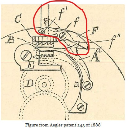

Just a quick update. I took the water damaged movement apart and can confirm that all parts were there and the train of wheels moved freely and if i blow the pallet fork back and forth the escape wheel moves nicely. I noticed the balance seemed to move a lot and further inspection after removal looks to be a broken jewel rather than adamaged staff. I still found no other markings on the bridges or plates to help with Identity but I did see this on David Boettchers article which matches the keyless works I have
I thought it was broken the way the lever came out to the side but it appears it was meant to do that, something I will need to keep in mind when looking for a case.
