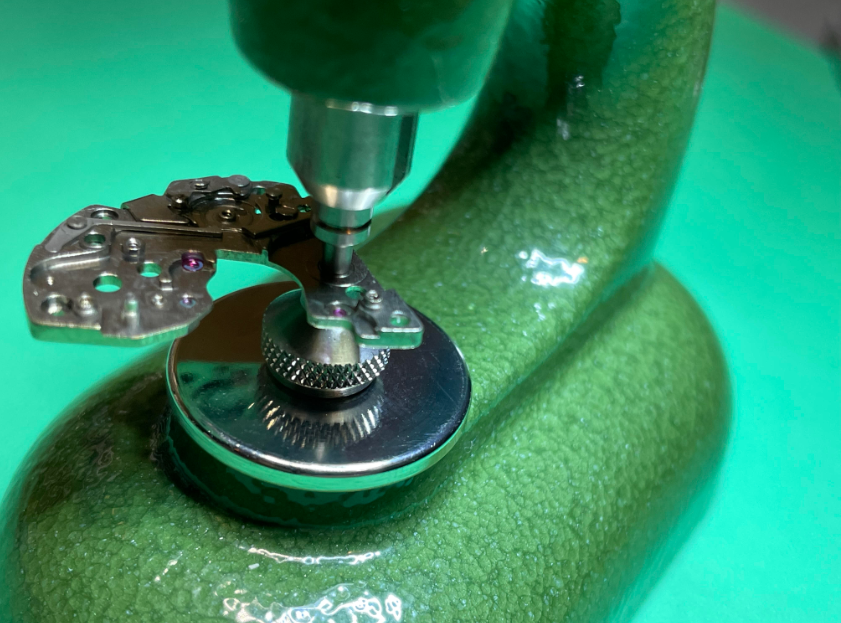

I'd never purchased anything from Ali Express before.  I decided to give it a try and I purchased one of their Horia tool clones.  Well I must say I knew what I was buying when I did it, but I am quite surprised with what I received.  This thing has some weight to it.  The threads feel smooth.  I even took a micrometer and measured some of the pushers and anvils and everything was pretty much where it needed to be, +/-  .001 or so.  I used the tool tonight to remove the upper mainspring barrel arbor bushing in a Seiko 6138 and replaced it with a jewel.  It worked like a charm.

I'm pretty pleased with it.  I have been out sick for a couple of days now, but I got a little energy to get to my bench when this thing arrived on my doorstep.

Tried it out adjusting the pallet fork pivot jewels (both mainplate and cock) of a Seiko 1104A. Back and forth. Removed the pallet cock jewel entirely and put it back.
Worked perfectly. This Chinese clone is a boon for the hobbyist.
