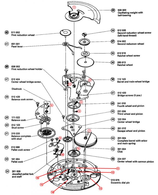

So I'm at the point where I'll hopefully be putting together all the clean parts of a Seiko 7009a movement. There's the famous service manual online that provides a lot of great information about reassembly and lubrication, but unfortunately the lubricants listed are ones I do not have access to. Namely:
  • Moebius A
  • SEIKO Watch Oil S-4
  • SEIKO Watch Oil S-6
I have the following alternative lubricants:
  • Microsgliss D5
  • Molykote DX
  • Moebius 8200
  • Moebius 8217
  • Moebius 9415
  • Moebius 9010
I've numbered all the lubrication points in the service manual (hopefully I've not missed any). I've read a lot of forums and watched a lot of videos on the subject, but it seems like there are a million ways to skin this cat. Below are the numbered lubrication points from the service manual (in red) along with the Seiko recommended product and my plan for alternatives. Let me know if I've made a mistake or if there's anything I've missed.
  1. Date Jumper
    Manual: Seiko S-6 - Normal Quantity
  2. Setting Lever
    Molykote DX
  3. Yoke
    Molykote DX
  4. Diashock Jewel
    Manual: Moebius A - Normal Quantity
    Moebius 9010
  5. Cannon Pinion
    Molykote DX
  6. Winding Stem
    Molykote DX
  7. Day Corrector seat
  8. Intermediate Date Wheel post
  9. Date Driving Wheel post
  10. Minute Wheel post
  1. Oscillating Weight bearing
    Moebius 9010
  2. Barrel and train-wheel bridge pivot jewels
    Moebius 9010
  3. Second Reduction Wheel post
    Manual: Seiko S-4 - Normal Quantity
  4. Fourth Wheel top
    Moebius 9010
  5. Fourth Wheel bottom
    Manual: Moebius A - Extremeley Small
    Moebius 9010
  6. Balance wheel diashock jewel
    Moebius 9010
  7. Barrel Arbor top
  8. Pallet Cock pivot jewel
    Recommended not to lubricate
  9. Center Wheel pivot
  10. Pallet Stones
    Moebius 9415 or 9010?
  11. Third wheel pivot jewel
  12. Center Wheel pivot jewel
  13. Barrel Arbor seat
  14. Pallet Fork bottom pinion jewel
  15. Escape Wheel bottom pinion jewel
    Moebius 9010
  16. First Reduction Wheel bottom pinion
In regards to the barrel and mainspring, I was planning on 8217 for the barrel walls and an extremely light coating of 8200 for the mainspring itself.
As you can see there are loads of points that I'm missing info on, and frankly I think I'm just confusing myself even more by reading more information. I've checked a Moebius lubrication guide, this forum, other forums, etc.
Any help filling in the blanks would be greatly appreciated.

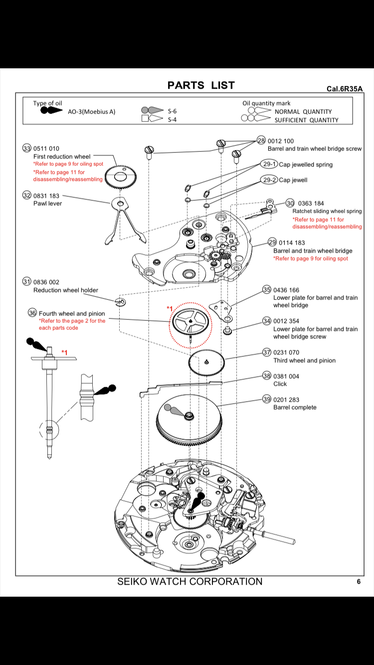

Yes because the exact same thing. I'm also attaching a PDF of a slightly different Seiko showing how to lubricated and their lubrication choices.  The other thing to do you find a really new Seiko watch and see what their lubrication choices are just because people like to change especially watch companies.

Seiko-Oil-7005A.PDF
