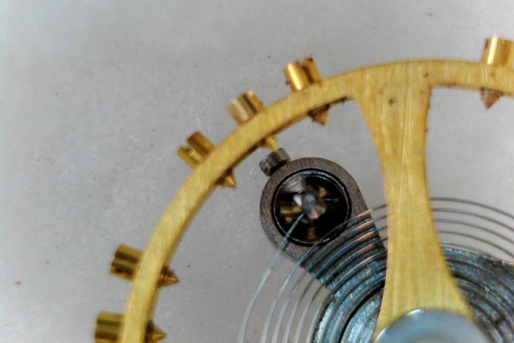

I just put a Bulova 10BZAC on my bench and it has an interesting thing-a-ma-jig on the stud screw that I'm wondering if it is used for adjusting the beat error?
I've included a picture from the internet and circled what I'm talking about--the screw that holds the hairspring stud to the balance cock has some sort of cap on it that I'm assuming can turn the stud?
Anyhow if anyone has any experience with this movement would appreciate hearing about it before I attempt to play with it.

That would help centering of the hairspring if it did. Can you post a close up of it.

What purpose would turning the stud serve?   Did you mean to say "turn the stud arm" ? or stud carirer?  or Beat adjustor arm?

I don't know, why I'm asking. However on closer examination under my microscope, I noticed that the stud arm may be adjustable. I'll find out when I clean it and reassemble tomorrow.869418719_Photoon1-2-23at2_30PM.thumb.jpg.57e72492179ec14eda812b103d84fb43.jpg
Edited by Levine98
Is it just not part of the stud carrier. Does it actually turn ?
Seems a bit of a new fangled design for a 60 year old watch.

I cant see how it would change the beat, if it does turn it must have some other purpose. Looked at a few other examples and all are like this. They seemed a high grade movement for the time with 6 adjustments and temperature controlled isochronism. So is this another adjustment feature ?
I've worked on a bunch of Bulova 10BPAC and 10BOAC. Those two movements share 99% parts and have fixed stud on the balance, making adjustment a real pain.
This is my first 10BZAC and although the base movement looks to be the same as the two above, the stud configuration is different (and I'm hoping adjustable)--maybe it was considered an improvement since according to pink pages the 10BZAC seems to be the a successor to the 10BOAC and 10BPAC movements.
You'll notice your stud holder looks like it's made out of a different material Then the rest the balance bridge. It probably can be pushed and used to put the watch in beat usually when there a different Material that's what happens. It just happens to be a strange design.
Just an update--it is an adjustable stud arm. However I still don't know what the donut shaped thing is for that is part of the stud holder, but not going to worry about it 🙂

Like John said just a strange feature of the movement.  I was initially thinking that if it turned to center the hairspring it might be some kind of predecessor of an Etachron stud adjuster.
