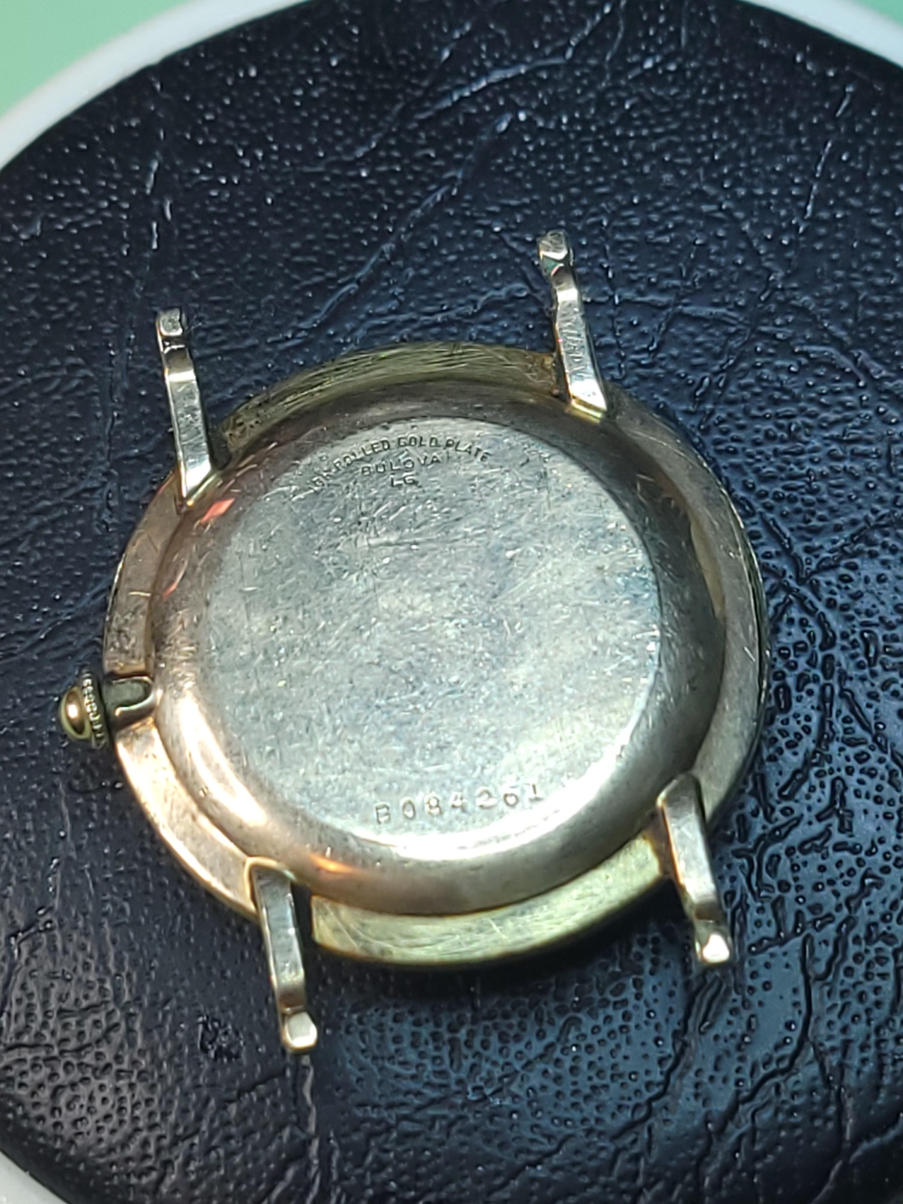

1956 Bulova President 10BU movement work in progress
I will try this weekend. I've tried several times with my cell phone and it's just too small and recessed to get a good picture. I need to get my macro lens and tripod out and then figure out how to get enough light down the hole in the side of the man plate to actually show the top of the broken screw. I appreciate the effort and will try and get that pic this weekend.
