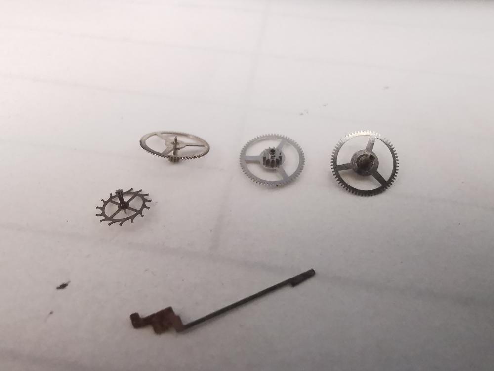

Welp, I'm pretty sure now that only the main plate was different. I got all the parts under the microscope and did  A/B comparisons and couldn't find any differences at all.
I'm not sure about that. At least I think that the 7019 escape wheel is different. Now I can't remember if I've tried to install a 7019 escape wheel on a 7009 movement or viceversa, but the wheel was not compatible and the bridge couldn't be installed on top of it.
Edited by aac58
Cheers guys!
Aac58, I'll compare all the escape wheels again, and I happen to have a beat up Actus with a 7019 movement in it that I might pull the escape from to compare.
It might explain where the escape wheel with the broken pivot came from actually.
Welp I pulled the working 7019 in my actus apart and got the escape out. Trying to eyeball against the other 4 escape wheels I have in storage and I swear any difference was probably totally in my head.
Without a micrometer and decent microscope set up I don't think it's actually possible to be sure of the differences. I think I could eee slightly shorter staves on the non geared ends of what I suspect the 7019 escape wheels are.
I got the actus back together and ticking and removed a suspect wheel from my 7009a storage, but honestly... Who knows?

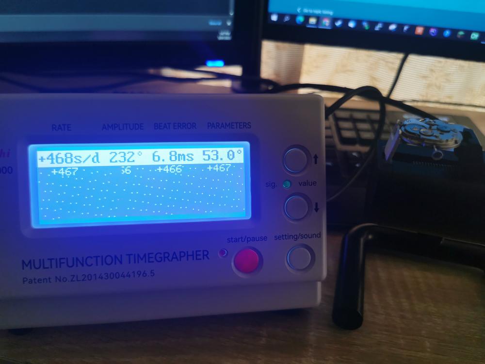

UPDATE: I removed the balance, cleaned it again, removed the shock setting and cleaned and lubricated again, put the balance complete back in the movement and it's now running dial up. So it appears I screwed up lubricating the shock jewels on the balance.
UPDATE TWO MILLION AND ONE:
I gotta admit I got pretty depressed about this not turning out very well, but I'm fairly ecstatic now. After fixing the lubrication on the balance I got it on my timegrapher and thought I might take a crack at regulating it. The balance issue seems to have fixed the amplitude nicely also.
This is was I was working with, +468s and 6.8ms beat error.
After a bunch of fettling I got some figures I'm happy with. I might be able to tweak the beat error some more, but I'm taking this win.
Dial down:
  • 0s/d
  • 253deg amplitude
  • 0.4ms beat error
Dial up:
  • +2s/d
  • 251deg amplitude
  • 0.5ms beat error
Crown up:
  • -1s/d
  • 226deg amplitude
  • 0.2ms beat error
Crown down:
  • +7s/d
  • 228deg amplitude
  • 0.6ms beat error
Not perfect numbers for sure, but I'm super happy.
