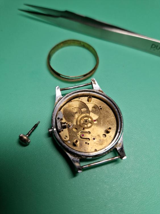

Can't find a way to get the dial out
A couple of pictures of the front… Sorry, I’m months away from this one, but…there is an edge to the bezel but I see no obvious signs of previous bezel removal and it is quite thick so it would be difficult to a grab an edge on the crystal with a crystal lift. It does look like in/out thru the back…good luck…
Personally I would salvage the missing screws from some donor movement. I also bought a random selection of screws "Assortment of Stainless Steel Watch Screws" for next to nothing. As for using an Alum solution - I had great success with that removing a rusted stem from a stainless steel crown. The best piece of advice I read on doing that was to keep the solution warm so that the reaction didn't take weeks! I did it in a couple of hours with the solution in jam jar and the jam jar in a saucepan full of water which I left on an induction hob maintaining about 60C in the Alum solution.
