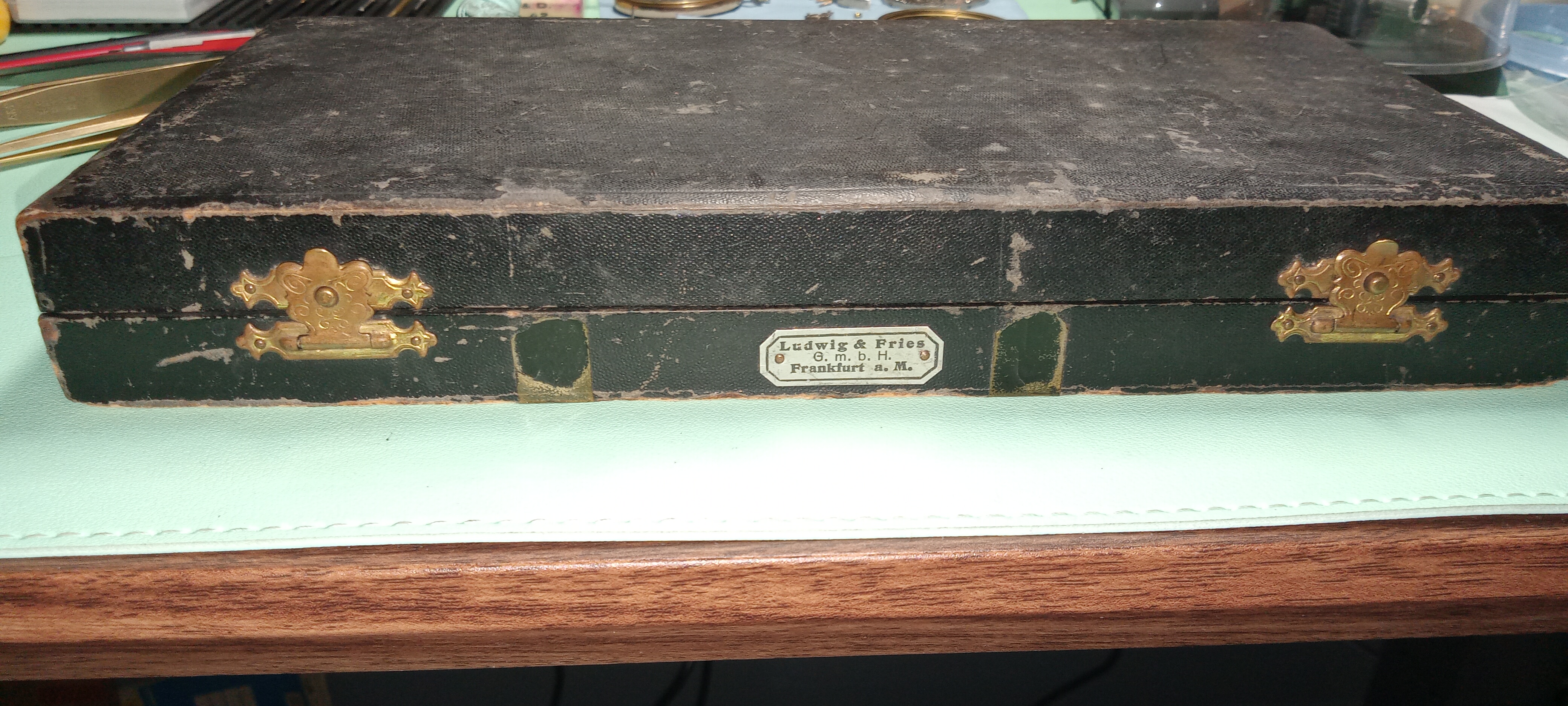

I think I did pretty good. Ofrei has bergeon jacots for over 4 grand! the guy with the used one claiming to be bergeon wanted over $1500 bucks. nah. i'm good with this one. spring drive complete with original bow string and extra string works great and all the lanterns are intact. little clean up, a little buffing and a drop of oil i'm good to go. first one up is a center wheel from a Waltham size 0s pocketwatch but I don't think I have the right size pivot holder. says Ludwig & Fries on the box but looking under my loupe I see no signature on the tooling except for the number "32" stamped on one end. either way it's in great shape.

Ludwig and Fries was a wholesaler in Frankfurt/M. like Flume, Jacob etc.
Frank
did you take a close look at my pics? only the box says L and F., and I couldn't find any discernable signatures anywhere on the tool itself. it works wonderfully though. wondering what brand it could be and the L and F box? looking for the connection?
