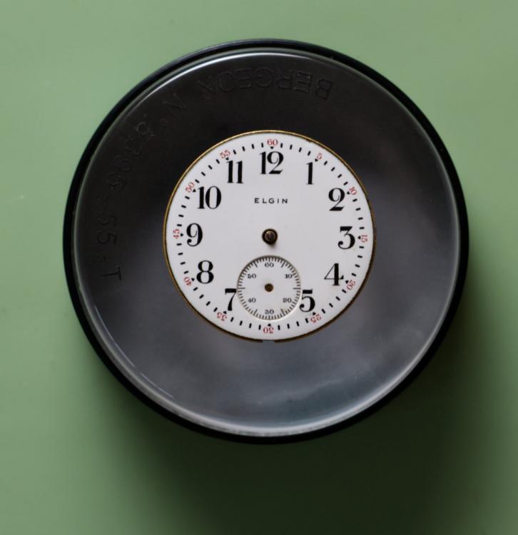

My very first efforts were on an Elgin grade 313 (of which I had two built 22 years apart).
In keeping with the Elgin brand I also picked up an Elgin grade 409 which was a smaller sized ladies pendant watch. Like the 313, I only purchased the movement which had a dial and three hands.
