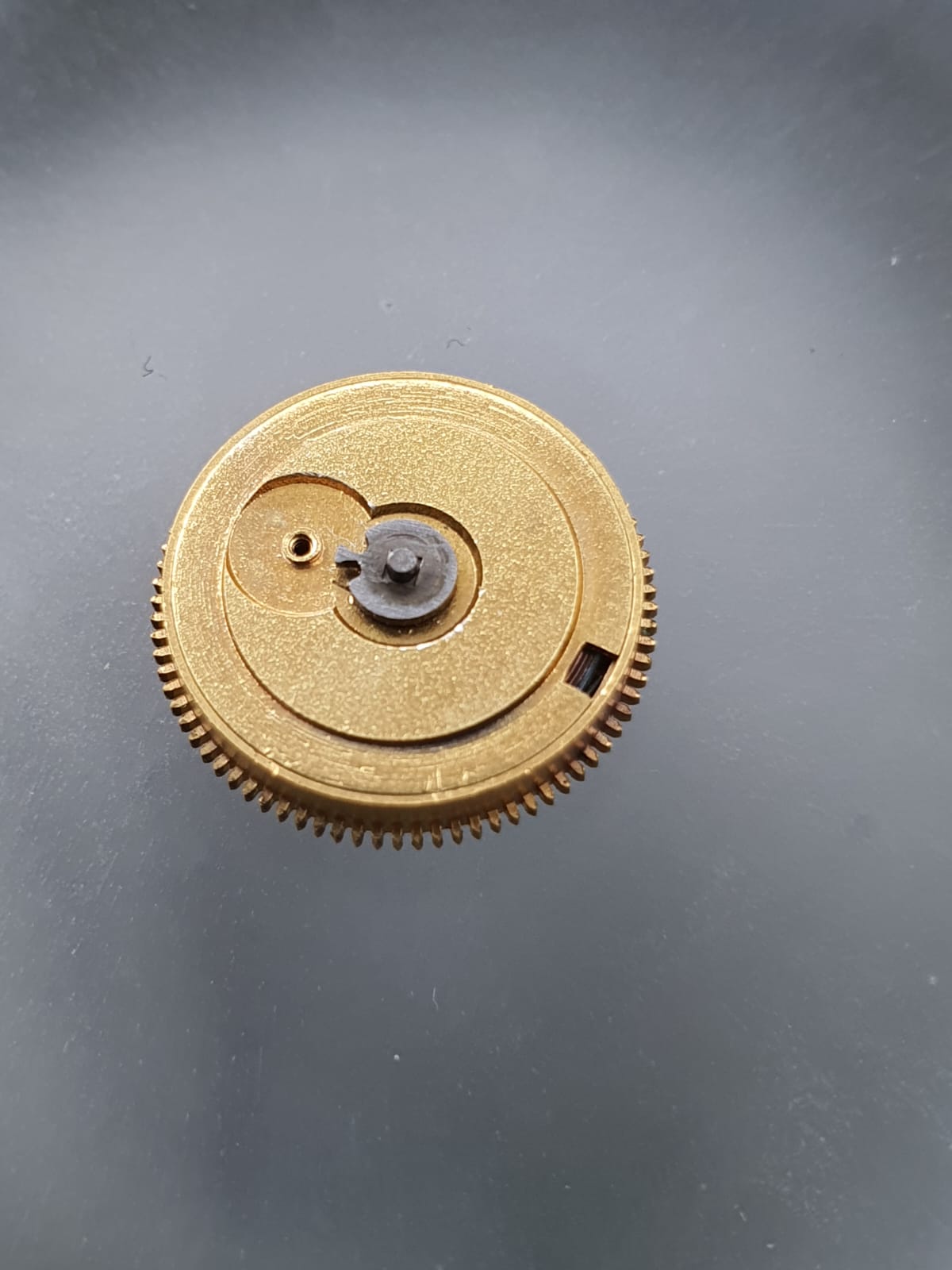

Have this 36mm antique pocket fob watch, not come across mainspring barrel like this before has a toothed wheel on bottom and an best describe as al apple she plat on top, one obviously has to come off to be able to remove the spline through middle and the barrel cover to get at spring. But cant find out how it comes apart have tried soaking it to see if can get apart but without forcing and damaging not sure how comes apart

You have a Geneva stopworks there, missing the second piece. This is a common occurence. Making or finding a new piece is time consuming in either case, and the watch will run fine without it. The ratchet wheel looks like it should pull off of the arbor, stout hand levers are good here. Some watches have the ratchet integral with the arbor, with the trick that the "bonde" or part that attaches to the mainspring is threaded on and unscrews to release the arbor/ratchet wheel. If that is the case, there will be 2 holes on the "bonde" to fit a tool to help unscrew it (but you can grasp it with very stout [nickel or brass] tweezers. In your case I think the ratchet wheel comes off due to the undercut around the square- that would be next to impossible to create by even modern machining methods.

dont suppose you would have a pic of where the missing part is ?

awesome information.  I have the "other" part of the geneva stopworks on a watch I just got into, and I was scratching my head that SOMETHING had to contact that gear.   Found a great video that explains it in detail per the google search.
