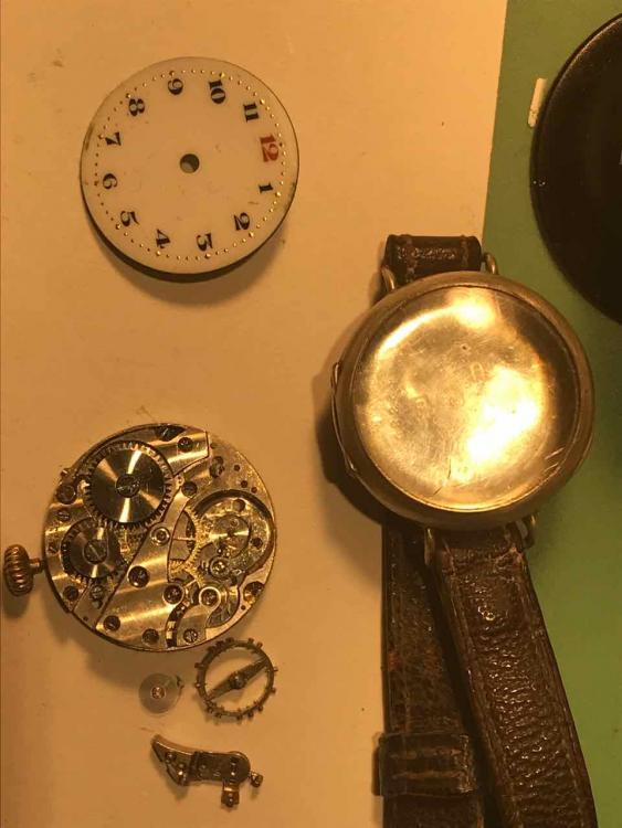

Hoping some one has some advice for freeing up a seized ratchet/barrel arbor screw. The screw doesn't appear to have any movement in it and I am nervous of applying any more pressure as I don't want to either sheer it or strip out the head slot. The watch is an old trench watch movement. What would be a sensible method for tackling the dismantling?

Hi. Just asking that you have checked for a reverse thread. Post up some pictures please

Every now and then you'll come across a ratchet screw that is a left handed thread. I'm not saying that is the case here, but it is worth noting

Your ratchet wheel screw doesn't appear to be rusted. Most likely it's a left hand thread.
Make sure your screwdriver blade is well dressed to avoid slipping and damaging the screw slot. Apply torque in both left and right directions and feel/look for any movement. Use a gentle force initially, then increase the torque gradually.
Sometimes heat is required to loosen the screw. I use a soldering iron to touch the head of the screw for a few seconds to heat it up.
Good luck and don't be impatient.
Bingo .... and thanks everyone. Soaking overnight plus a little very gentle heating with a fine soldering iron and it came loose .... it was a reverse thread as you all thought. 😀

Got right to the end of an epic rebuild of the trench watch with it actually running quite well .... and then went and broke the balance staff pivot 😪 ... and that was after having re-studded the hairspring and manipulated it back to the correct shape so was feeling well chuffed ... classic pride before a fall and taking my eye off the ball. I had just tweaked the collet to fine tune the beat error and was careless when refitting the balance and BANG!.
So .... the question is ... is it possible to buy a replacement staff for an old watch like this, and if so how would I get the right size?

Aw mate gutted for you but really well done on the rest of the repair, the thing is not to let it set you back. It may not have been totally your fault, an old watch so could easily have been an old weak pivot that has given years of service. Lets have a gander of the watch and movement matey, i dont think we've seen it yet.

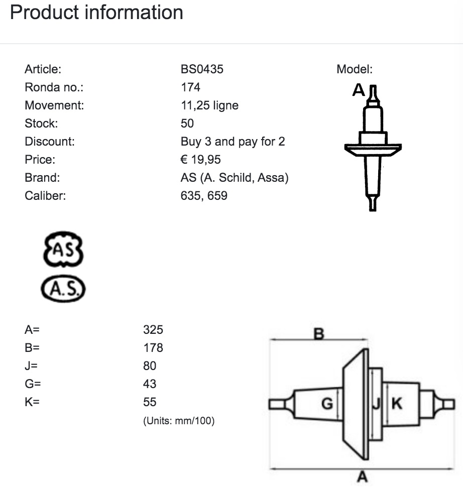

Ranfft has a few listed 38x similar keyless works but different train. Mid 1930s . Can you assemble the rest of the keyless . it may be too old for some identification sources.  your only option maybe to repivot the staff or have a new one made if you are determined to carry on.

I have been perusing the Best Fit Manual .... under AS I came up with the two following calibers which were 11 ligne .... 872332527_659LISTING.thumb.jpg.e1302c4edbe3224dfebbe569ea275ef9.jpg963447826_684LISTING.thumb.jpg.1f22258af841228753602b8c4fb6e1f0.jpg
Both state compatibility with AS 635 - the illustration for 635 is -
The yoke on this seams correct for my movement
The recommended balance staff is given as 72
1512085333_Balancestaffdims.thumb.jpg.700683ca7a6bccfb75a35aeb2aa6a521.jpg242963005_72balancestaff.jpg.6caf74503bc7bdc0cb474e20ffa4a514.jpg
This would match with the Ronda staff illustrated  here..
If I get a close measurement of my staff to this (given the the pivot is broken) is this reasoning sound?

That should be a fair bet, providing you can accurately measure the staff, you will be just missing measurement A. How do   the rest of the keyless works match up to give a more solid ID. I am also assuming that you have staking equipment?
Edited by Neverenoughwatches
Yes I have a staking set ... The setting lever looks very similar ... but it doesn't have the spring at all.
I will see if I can extract dims from the staff and take it from there I think ... if it doesn't match I can always search for one that does I suppose.
