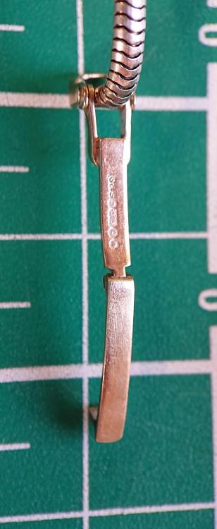

I've been passed a watch by a friend. It's a bit damaged having been in a car crash. They think it's junk but I think it's rather nice, with (probably) a diamond set platinum case. It's hard to know how to approach this.
I'd rather not work on it unless I can get spares for the movement...but I can't see a movement number to research. So it's a chicken egg situation..do I dismantle it so see if there is a calibre number somewhere, or just leave it or hand it back for now. Do any of you recognise the movement? How would you approach this situation. I'm not a professional, but friends and family are starting to trust my work.
learnenDSC_1175a.thumb.jpg.b996ef0e49e748296d38687301296ca7.jpg765227723_DSC_1180c.thumb.jpg.5d5732c746a5fe9c2dc47d7eb2af1ce2.jpg1387451941_DSC_1179c.thumb.jpg.937cf30688edde67a2f49fe61902b278.jpg1046011478_DSC_1181c.thumb.jpg.d2cff00c63855983ef24422b614d5111.jpg

Looks very similar to an AS 969 but without a cap jewel on the escape wheel. I am not an expert at identifying these, but I was pretty sure it was an AS and just opened up all the images on 17jewels to find the similar image.
https://17jewels.info/movements/a/as/as-969/
If you search for "AS" on https://ranfft.de and just click through all the movements of the right size (there are a lot of them) you will probably find the exact one.
Thanks @mbwatchand @Nucejoe. It's just over 15mm so 6 3/4 ligne, and 18,000bph so the AS969 looks like the best match of that family. The keyless works is a perfect match to the photos on Ranfft. Apologies for the blurry picture but it's getting dark:
15991196_DSCPDC_0000_BURST20220802205452792(2).thumb.JPG.4c9ce9694d0138ba2b1200fbd482e28d.JPG
I'm now confident I can find spares and it's a simple movement so I'll crack on I think. Many many thanks!
