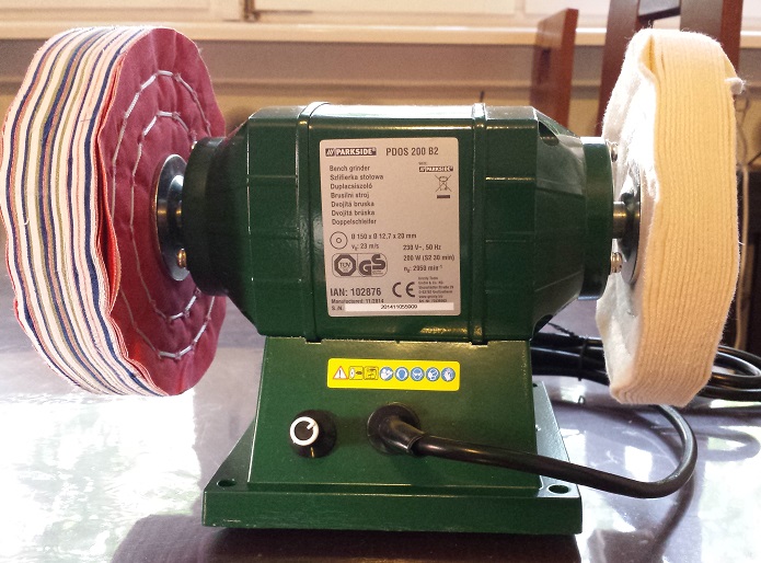

I just have finished modifying dual table grinder from Lidl to adopt it as a polishing machine. It seems to be solid and not very expensive. Im not doing much polishing so for my needs its enough. I added speed control module to it (DIY kit for speed control from one of the shops with electronic stuff, I had to solder but that was fun). Module fit inside case of grinder and only change I had to do was drilling hole for knob for changing speed). I used connectors to put it into circuit so it can be back to original state at any moment, just unplug module and pug it back as it was. It runs quite nice, 200W its enough power, motor seems to run smooth and don't need any maintenance. I can use polishing wheel sized up to fi 15-20cm, up 30mm wide. only problem was getting wheels with proper hole size as it accepts 13mm, so I have to use adapter from 20mm/13mm. All together cost was about 40$ for the device. I can post pictures when I get home.
btw. speed control may be needed if felt wheel is used - too much speed and it can give you burn marks on metal.

Looking forward to seeing the pics. I was toying with trying the same thing, however I wasn't sure what size motor/watt & rpm I'd be looking for when purchasing.
This one can do 2950rpm (now -5% because of speed control module) It has 200W 240V, I think if that was ok for grinding its more than enough for polishing.
Here are the pictures. I believe Cousins sell cone shafts which could be used to attach polishing wheels. This is first draft and I plan to make improvements :). From behind, just by power cable, you could see knob for speed control. That was the only sensible place for it.

Its not just one resistor, here you have this piece, Im sorry its in Polish, I couldnt find anything in English, but there are youtube movies describing how it works. I didnt mounted resistor to circut board, I used cables to easly mount it to the case.
http://sklep.avt.pl/avt1007.html
