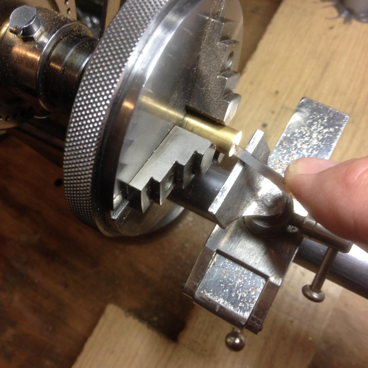

I normally use commercially made bushings, such as by Bergeon but sometimes there is a need to make a custom made bushing. A simple job on the lathe apart from sometimes catching centre is a bit hit & miss. So I decided today to make a centering tool that I see a few years ago on the net so here goes.
1. facing off a 7mm brass round rod
2.Then the dreaded catching centre (this time OK)

10.The tool in action finding centre one handed you just know when you have centre with the conical shaped end and with gentle pressure on the handle it marks centre
JOB DONE
I have made slight mode to the one made for the pics. The one in the pics I drilled using a 1.90mm drill but it actually drilled a little bit bigger than the 1.90mm. This caused a tiny bit of slack so I have re-made the main body & re-drilled with a 1.80mm drill & smooth broached the hole to get a real snug fit.
Getting a dead straight bore is not essential but desirable. If I had a tailstock that was fitted with a drill attachment then it would be really easy to achieve. Also my lathe centre to centre is marginally out so I cannot trust it.
