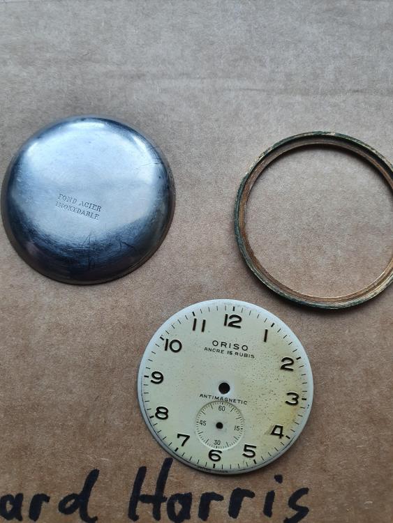

Got this as a sweetener on a job lot.  Nothing on the Internet about Oriso.  F in a shield under the dial, nothing under the balance. Doesn't run but the balance swings well when blown, hopefully just a service, it is filthy.
Oris used some silly variations of their name but this movement isn't anything like i have. They are always marked Oris and if a variation then OWC in a sheid the shape of a bat. Dial looks a bit pitted mate, do you think it will clean up ?
52 minutes ago, RichardHarris123 said:
I should of added the dial side photo. Says 294 but looks more like a 335 _ 8.
The train bridges and pallet cock is different rich but this may be a ranfft error or a 294 alteration at a later or earlier manufacture. The key less works are showing the same as yours a 294 or very similar. You are showing a broken yoke on yours. ☹
It does look very much like the 335 on the ranfft database. The dial plate is flatter on yours but everything else seems to match up. ?
Yes I've noticed the broken yoke.

Morning mate. How you doin ? I couldnt quite match up as there seems to be differences on both calibres. The 335 does look to be the closest, although yours seems to have a flat dial plate where as the 335 has a bevel around  the edge. Strange ? Movement manufacturers eh 🤷‍♂️ never straight forward.  I hope you have some luck tracking down the yoke 🤞. I had a joblot of around 35 turn up yesterday morning, some real pigs among them by the look. I'm going to be very busy lol. And some toys coming tomorrow, its about time i got my finger out and did some repair 😂

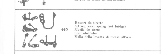

Shouldn't be hard to find the parts you need. There's plenty of cheap Felsa movements, and parts, on ebay.
Where do I find parts sheets?
I usually look on the Documents Downloads in Cousins https://www.cousinsuk.com/document
or here https://watchguy.co.uk/cgi-bin/files
but there aren't and 29* or 33* movements listed.
The Swiss part number for the setting lever spring+bridge is 445
You can find them listed on ebay for the above movements.

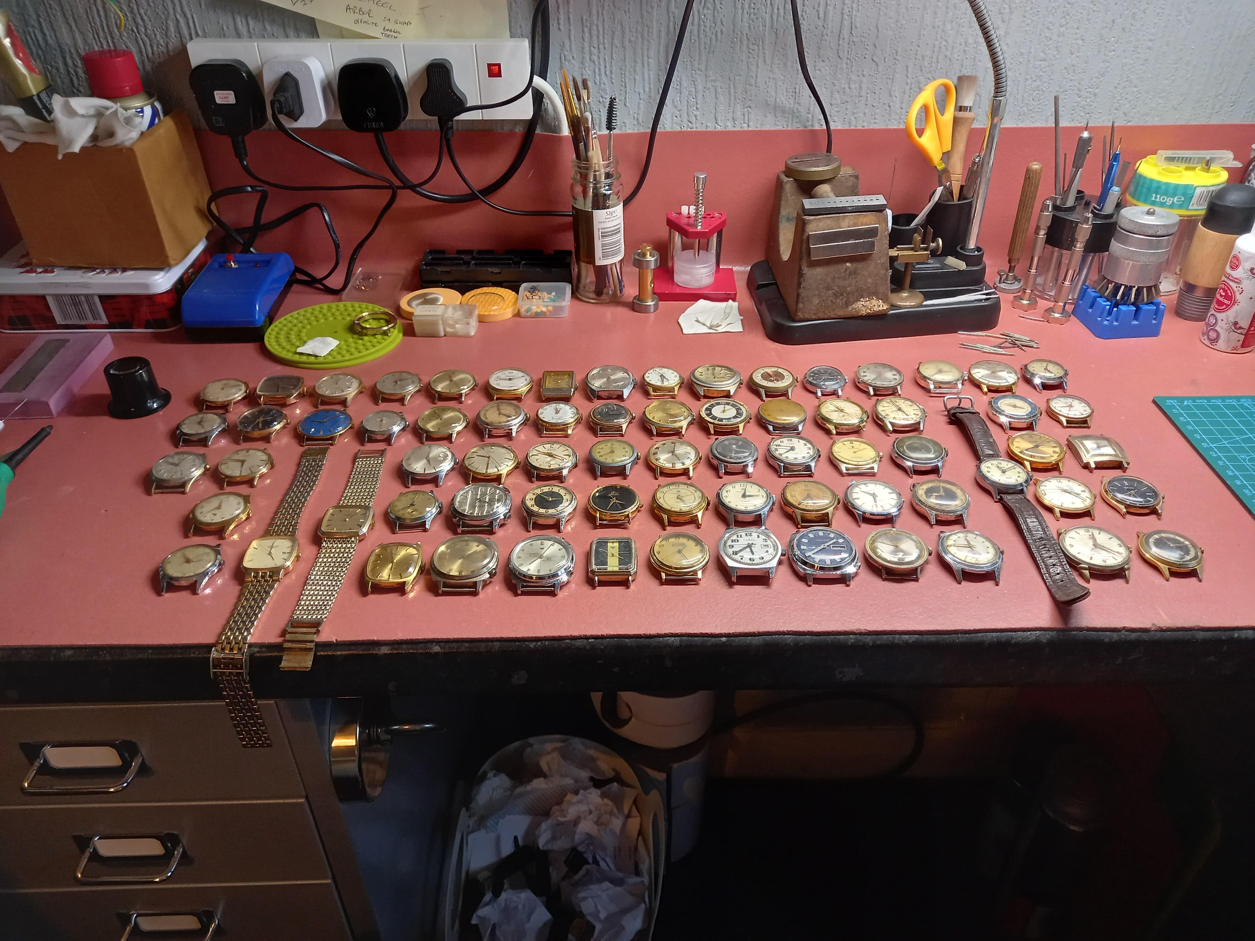

Wow, just wow.
I think i may have got just a little carried away. I did actually have about 25 of those already. Ive just had a good look through, there are about 10 that i havent  heard of.
