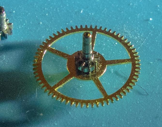

I'm inspecting parts. This is, I think, the third wheel and pinion #214, no. 3 for Bulova 11 BLC. Should it have a narrower projection at the tip? I may need to disassemble my known good movement to find out for sure. It doesn't look like it should have a pointy end from looking at the Bulova spec sheet. Thanks.
19 hours ago, rph952 said:
I removed and oiled the balance jewels. Those little jewel springs don't look like they are meant for a lot of prying.
Pictures would be nice for us to see exactly what you're talking about
plus a picture of the balance wheel in the watch. Everybody likes to take pictures the balance wheel out of the watch but the problem isn't with the balance wheel out of the watch the problem is probably when it's in the watch and we can't see things when it's out of the watch
All so when you get the picture the balance wheel  in the watch to make sure there's no power on it it's hard to see things with the balance wheels moving it's very misleading
