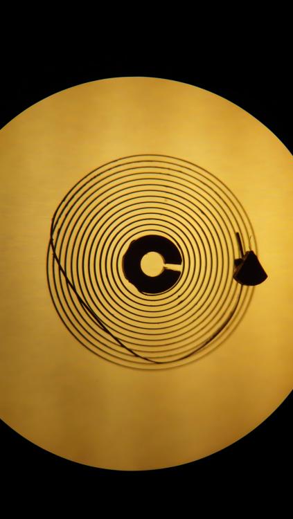

Thanks for your support guys, I will examine the hairspring under the ๐Ÿ”ฌ today evening when I come home from work, and post some pictures again to see if there is any improvement. If not, I will take a step forward on the derusting process, and use some more aggressive stuff jjj. In the worst case scenario I will need to find a balance complete. I already have the numbers for all the parts, including balance complete, thanks to grsnovi who searched them all for me. Thanks friends.

Hi Daniel 123, I still have the hairspring taking a bath in naptha. It's been close to 48 hours. I already have all the parts numbers and I have them located at different places like cas-ker, ebay, etc, but I haven't bought anything yet waiting to see if I can get the hairspring clean. If so, I will just buy the staff and the hole jewel (which is a cheaper option). If the hairspring breaks or is too deteriorated, I'll have to buy a balance complete which I also have located(more expensive option jjj).

Hi, this a short update about the hairspring experiment.
I had the hairspring in naptha for more than 48hs. It did not remove the rust. Then, I placed it in coca-cola for about 12hs and it improved a little bit. Finally, I placed it in lemon juice for a couple hours and it began breaking the rust out of the spring. Now I have it in 99% isopropyl alcohol.

Lemon juice have done much better than I thought. Did you say you don't have an ultrasonic machine.ย
I wonder if lemon juice in ultrasonic would fully derust the spring.
I have lost hairsprings in vinegar in ultrasonic though.ย
The acetic acid in vinegar is more aggressiveย  than citric acid. I'm not keen on the high water content in vinegar though. I thought I'd do a quick scale of what to use so far toย  remove rust for future ref, and would love any additionsย  or feedback onย  them. Some things I have tried and some I have not . But I will definitely be experimenting when a situation arises..ย
No 1. safest option naptha and any alcohol based product. Generally little effect.
No 2. Lemon juice, citric acid. Some reasonable effects.
No 3. Vinegar, 5 -10 % acetic acid 90 % water. Good rust removing ability, be aware high water content.
No 4. Coca Cola . Contains very small amounts of phosphoric acid, high water content and sugar Also good rust removing ability.ย
Four easily obtainable household items. Each can have heat (naptha and solvent with caution), ultrasonic, mechanicalย  and prolonged soaking to increase their rust removing potential. Lastly specific manufactured products. Evapoย  rust, wd40 rust remover. I have only tried Rustins, this stuff is lethal and will literally dissolveย  small watchpartsย  overnight. ๐Ÿ˜ข
