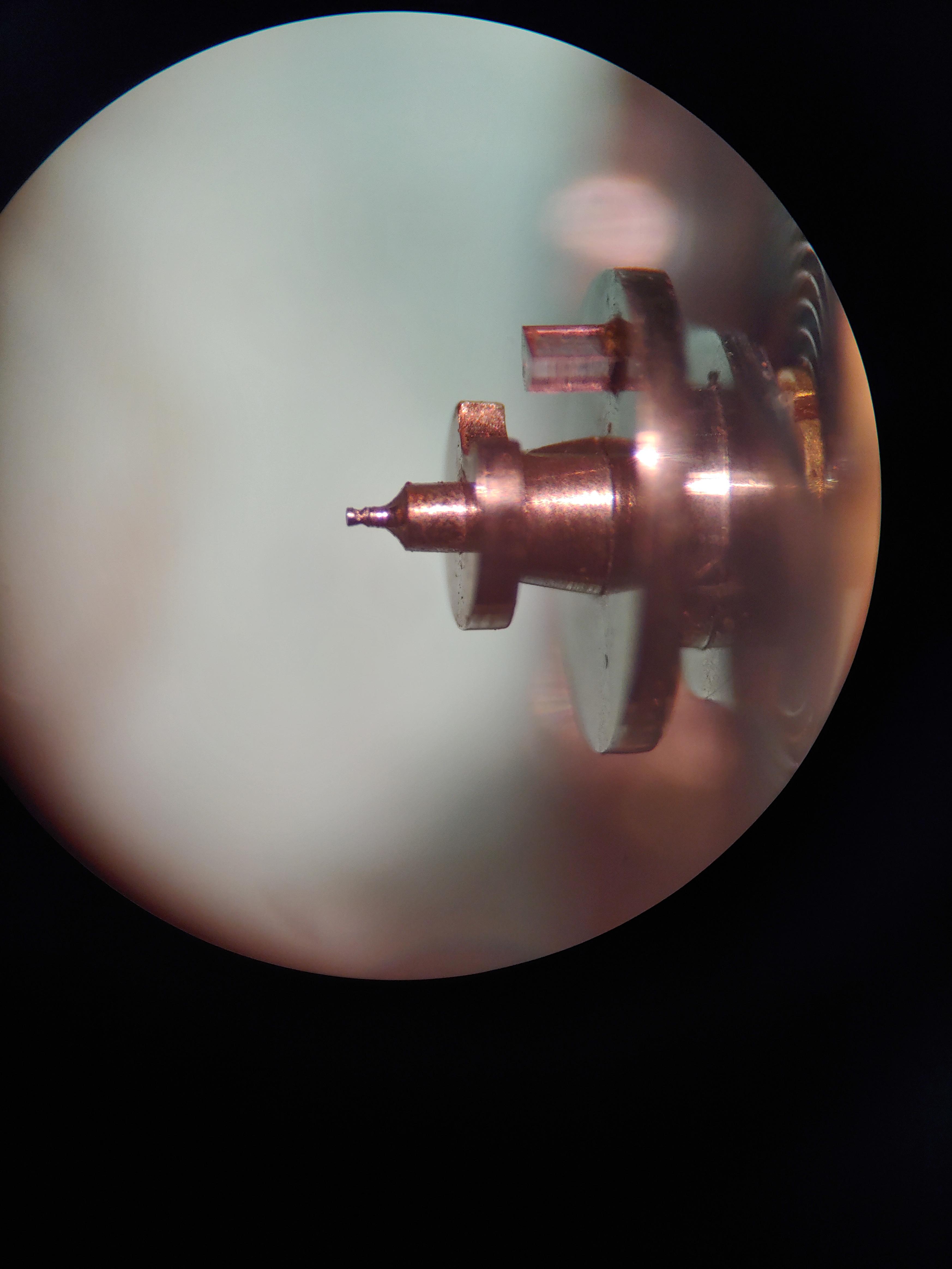

There are liquid rust removers some specifically designed for horology that will remove the rust. Typically there time-limited if you leave it into long it might turn all the steel parts blacked that's very undesirable. I think some people on this group recommend Coca-Cola because the acid in that is equivalent to the rust removing chemical and I think I've heard other people use strong tea As supposedly that will take rust off but I've never tried either. I have tried the liquid rust remover that I bought a long time ago and it did take the rust off. They hairspring doesn't look as bad as some I've seen if you do take the rust off the hairsprings been compromised so it won't be perfect but considering the rest of the watch study pretty good
can you get a new hairspring may be? Elgin hairsprings were premade but matchstick each balance wheel we can probably figure out which one it is and then you'll still have to match it. In other words even if we had the exact replacement you'll have to play with timing screws to get the balance to match the hairspring
For the balance wheel how much lathe work do you do? You could replace just the pivots if you're really skilled. Otherwise it replace the entire balance staff. Or if you a time machine you can go back in time I get a balance completes because we get a balance complete now you have to cannibalize something else to get it probably or if somebody sells you one off of eBay they've already cannibalize the watch for you. But on pocket watches swapping parts isn't necessarily what you want to do is a do not necessarily interchange.
For instance when you change the balance staff like for instance
http://www.elginwatchparts.com/
If you go to the link above and enter in your number 417 we get a parts list with problems? Microphone off
Balance staff as you can see we get a part number and a warning note? Staff number 869 and something they don't have they refer you to something else? This is because there's almost always variations especially with Elgin staffs variations will be by pivots size always for almost every single staff and then the be other variations. Good news is the only have three different balance staffs just different pivots sizes. Apparently this watch came as either a single roller or a double roller in the staffs the same.

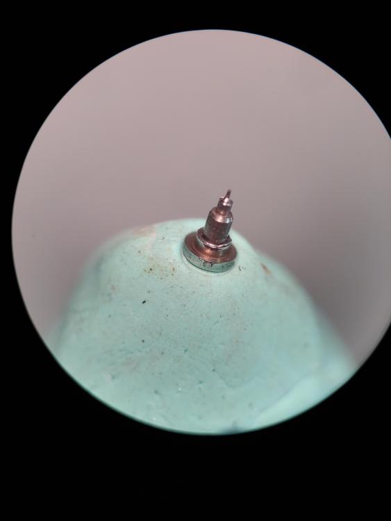

Yes, it sounds like a plan. I will take the balance staff out, measure the healthy pivot and try to order the staff and balance jewel based on the pivot diameter. I don't have a micrometer, but I know a couple people who probably have one. Hopefully with the parts number and pivot diameter I can find  both parts (staff and jewel) on daveswatchparts or ebay. I will also try to clean the hairspring once I get it out of the balance.
This is the biggest challenge so far for me, but I am up for it!!

I am a beginner indeed, repivoting a staff is way beyond my skills at this point. I not even know how to work with a lathe, but I would love to learn. I've seen videos of people doing marvelous things on a lathe. I do have a staking tool and I've taken some balance complete apart and assembled them back (hairspring and roller table). I haven't removed the staff from the balance wheel on any case yet, this will be the first time I mount a staff on a balance wheel. I am reading and watching many materials about assembling a balance complete.
The cannon pinion has literally a hole and some cracks jjj. It's in a very bad shape.
And of course the mainspring needs a replacement jjj. But I would like to tackle one problem at a time. Since the balance is the most critical part, and without it working properly there is no point in moving forward, I want to focus attention on getting it up and running again. Then, I will move onto the next problem 😅.
I had not thought about the sugar in the coke, excellent point. Maybe after the coke I could place the hairspring in ligther fluid and finally in 99% isopropyl alcohol. Unfortunately I don't have a cleaning machine, I have to do all the cleaning by hand with a hairbrush.

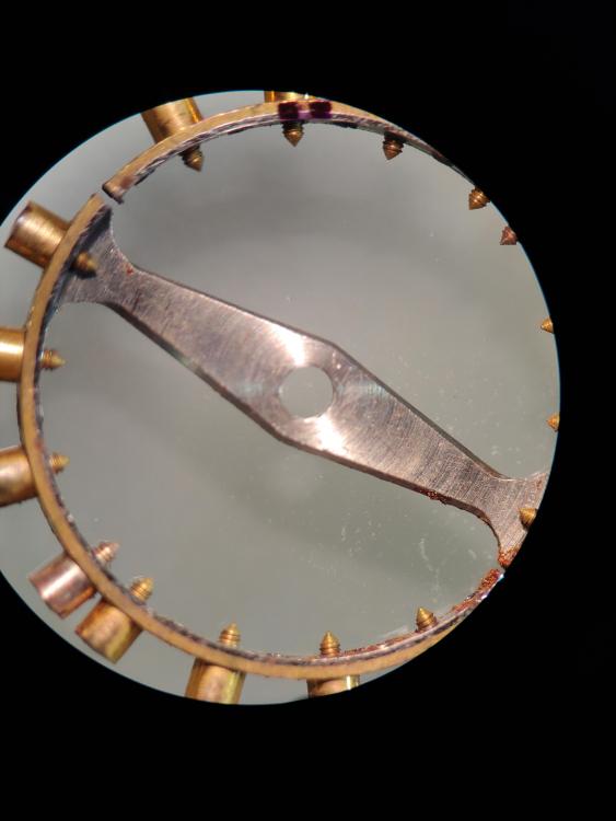

It is the phosphoric and citric acid in the coke that dissolves the rust. And people drink this stuff🤦‍♂️ try something else without the sugar first.it might save you a stick mess. Lemon juice, although I've not tried it on watch parts. I don't think I would try vinegar either to be honest, other parts yes. But the hairspring  is far too delicate and introducing any thing that has a water content is going to be risky. Try soaking in naptha for longer maybe overnight and then gently agitate the fluid over the the complete  balance with a puffer. Before moving on to anything else. If money isn't  an issue then possibly an amoniated watch cleaning product. If you are staying in the hobby look for a reasonably  priced sonic cleaner, I think worth their weight in gold. If the rust has got too deep a sonic cleaner would confirm that anyway and leave you with a damaged part that wasn't  worth keeping in the first place. Ie. Rust was holding it together. Many years ago in the UK we had cars like this held together  by rust . It keep us very busy with body filler on weekends.😁
2 hours ago, Luismartinezdecuba said:
It sounds good, I'll try leaving the hairspring in naptha longer and see if rust goes away. If not, I'll try other cleaners.
Thank you Neverenoughwatches 🙂
I'm in hope for you. On the third coil in the rust looks fairly intensive. When you think the hairspring  is around half the thickness of a human hair, condensation and the dreaded iron oxide  will quickly eat through .

I'll have the hairspring in naptha for at least 24 hours and then see if it cleans (I'll take some pictures through the 🔬 and post it here after the naptha bath jjj). I am also trying to get a micrometer to find out the right pivot diameter.

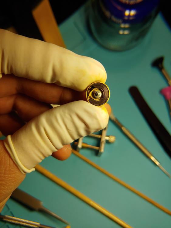

Here is my progression so far, I attached some pictures.
You'll see in one of the pictures I measured with a regular caliper. It gave me 0.10 for the staff pivot, but I will find a micrometer to get more accurate diameter.
Ive3taken roller tables and hairsprings out of the balance before, but this is the first time I take the staff out of the balance wheel. And, in doing so I placed the staff in a too tight hole on the staking tool, and it got stocked in it 🤦. I had to turn the staking tool and use a pusher to get it out. Unfortunately one side of the staff broke, but fortunately it wasn't the one with good pivot (as you'll see in the pics uffff). I knew I had to move one hole back on the staking tool once I found the one that makes the staff fit tight, but I dont3know what happened honestly. At least I didn't brake anything that wasn't already broken jjjj. I have a lot to learn, be patient with me please jjj.
Whatever you see I'm doing wrong on the pics, please let me know. I am learning from you a lot.
Ahhh, hairspring in naptha, I'll leave it there for at least 24h
https://youtu.be/vIQvAm4GC5U
This is one of the videos I've watched about changing a balance staff (one of my favorite)
Aw mate just a bit of bad luck there. You are at least having ago which is what it's all about. This is the only way you will truly  learn and get better and better. Don't let it frustrate you. Try and try again as they say 👍 . The hairspring  is not coming clean at all is it, naptha is only something of a degreaser really, but it was worth a try. I think you are going to have to step the de rusting process up a level. I've tried a few things to remove rust, but not on anything as delicate as a hairspring. I don't want to tell you might be wasting your time because I hate to give up on anything and admit defeat. I can tell you not to try Rustins rust remover because that is very aggressive.  Vinegar, lemon juice maybe ? WD40 rust eater is apparently good, personally I don't like to recommend anything I haven't  tried. Try asking some of the pros they may have  a hopeful answer for you. 🤞
Edited by Neverenoughwatches
Thanks for your support guys, I will examine the hairspring under the 🔬 today evening when I come home from work, and post some pictures again to see if there is any improvement. If not, I will take a step forward on the derusting process, and use some more aggressive stuff jjj. In the worst case scenario I will need to find a balance complete. I already have the numbers for all the parts, including balance complete, thanks to grsnovi who searched them all for me. Thanks friends.
