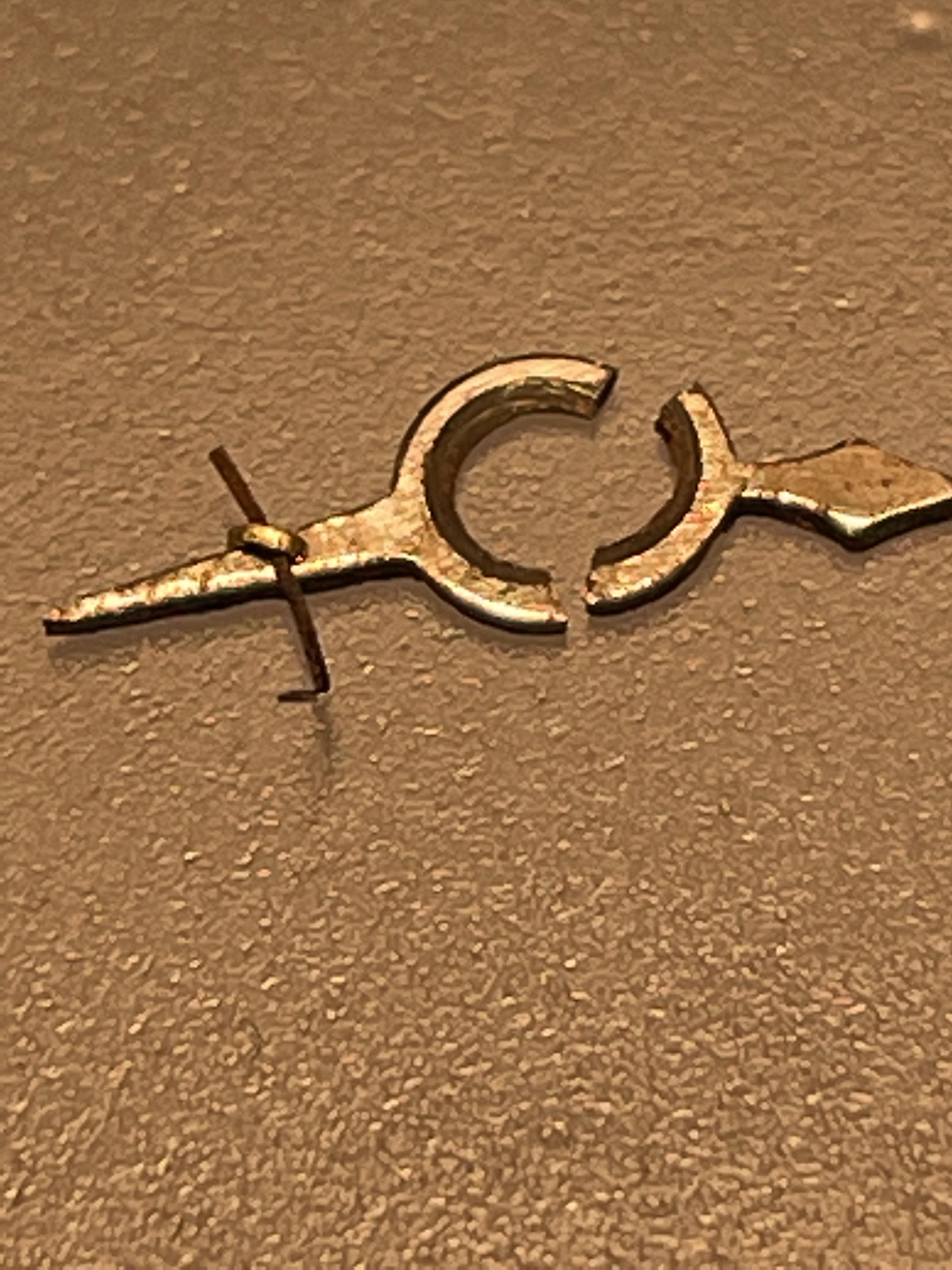

To my untrained eye, it appears that your regulator pointer is actually just a piece of what used to be the regulator pointer.

You are correct, its whats left of the regulator pointer :-). It looks like it had broken off and that piece missing I found inside the case.  But the regulator actually still seemed to work before I pulled it.  It moved at least left/right.

Coming back to this question.  I have a replacement hairspring that I have installed on the pinion.  It is not going to give me anything close to a good watch but it may actually run.   The last big piece I am finding out is the regulator.  It is broken in half and I would actually attempt to make one (got good advice on this from another thread and used a feeler gauge to make a stem clutch, worked great)  but I found that the adjustment pin under the regulator has the hairspring threaded through it.  I know I cant make that unless someone has a suggestion.

It also holds in the cap jewel just by snapping in place, there are no screws.  You can see the angles on the round portion that sit on top of the cap jewel.  Sigh,,,,
