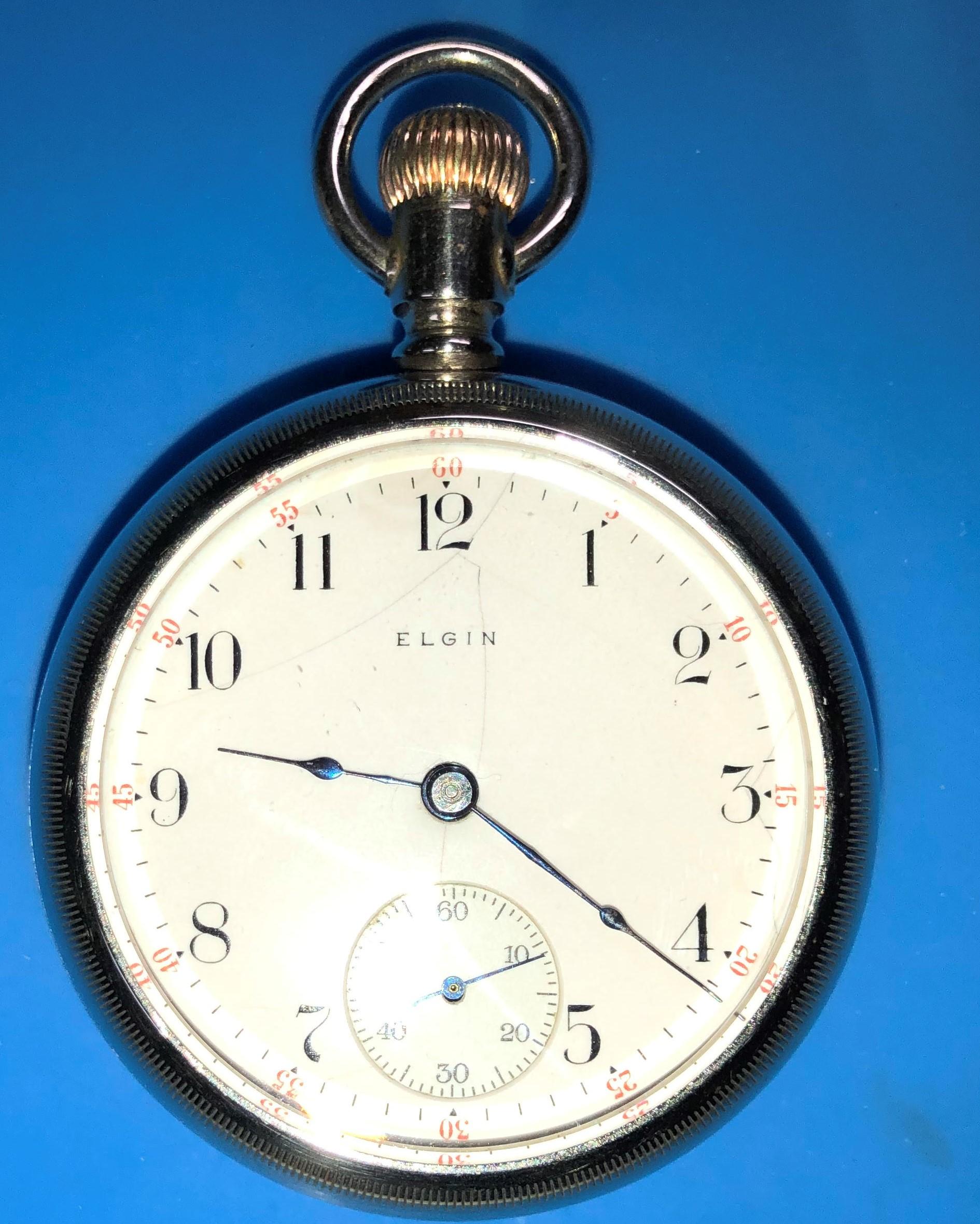

Here is an Elgin 1899 grade 145 pocket watch I have disassembled, cleaned, oiled and regulated.
I replaced the crystal and also the winding stem sleeve. The Crown could be replaced with one a bit more silvered but I sort of like it brassy.

Hi, I have one of these coming. How do you know it's a grade 145? Mind is movement number 8994776 which is the end of year 1899. I haven't worked on American PW before, only Swiss. Is there anything tricky about it such as LH threaded screws? Any insight would be appreciated...J.
According to the POCKET WATCH DATABASE yours isn't. Your s/n says that it's a grade 207 model 4. I was unable to find that specific model in the ILLUSTRATED MANUAL of AMERICAN WATCH MOVEMENTS. Part numbers are listed in the red ELGIN Genuine Material manual.
Be careful - just because you have the same Grade 207 don't assume that you can just swap parts. I made that mistake with an old Elgin I was working on..

the reason you are unable to find it is their way too many grades and models to be listed. There only listing the really really popular stuff everything else you'll have to go to other sources.
Like for instance the link below Elgin pocket watch parts. Enter in your grade number you get a parts list and you can enter your part number in on another search and I give you all the various grades that use the same part. See mass production standard parts except this is a vintage watch go to the notes on the bottom of the page.
Notice variations that means that even if you had to watches that look identical are about the same grade the parts may or may not interchange. notice is a reference to the balance staffs well this is because this is my favorite staff number 857. Why is it my favorite staff number because you feel the right listings first to find a typical almost but not all American pocket watches will have different pivots sizes for the same staff. Then like this particular staff comes in four separate variations. And what I mean by variation there will be definite dimensional differences were you cannot interchange but they all have the same part number. That of these variations they also have the pivots size variation. The list that I'm looking at indicates for the 857 staff we would have 14 different staffs that are all different for some reason with the exact same part number.
http://www.elginwatchparts.com/
oh and then there's the other little problem which does not entirely plagued American watches it basically plagues everything made early on even if they were mass-produced
then I have a link to a video. It's an interesting video showing making Elgin watches with the problem if you look at your pocket watch you will find that all of the plates have a serial number referring those parts to this one specific watch even the balance wheel should have its serial number scribed on it. Because even though the parts were mass-produced the watch was still hand fit. So all certain parts will readily interchange other parts will not probably or possibly typically escapement components will be problematic. Express if you pay attention of the notes on the bottom of the part page where it said there were variations
then you look at the video there making the parts but notice when their hand fitting some of the stuff they might be hand adjusting the parts the earlier the watch the more likely there was hand adjusting to get things to fit as they go more and more modern their tolerances get smaller and smaller the perfection of making parts at some point in time even Elgin drop serial numbers because they aren't needed anymore for individual components. But back when these watches are made the parts are made in a batch and between batches there can be or possibly will be variations
https://youtu.be/ys4ChOWYNy8
oh and remember to take pictures especially of the keyless works. According to the specs up above you have a lever set that will make things a little easier.
Oh and? Maybe I should just leave you some mysteries or by the way did you notice is the full plate watch? Notice where the balance wheel is when it comes time to reassemble it all give you some clues the problem is or what you'll run into is on a full plate watch getting the pallet fork where it's supposed to be can be an interesting challenge if it's done incorrectly damage can occur. But I think I'll let you have some fun with your watch, pocket watches can be interesting to work on.
