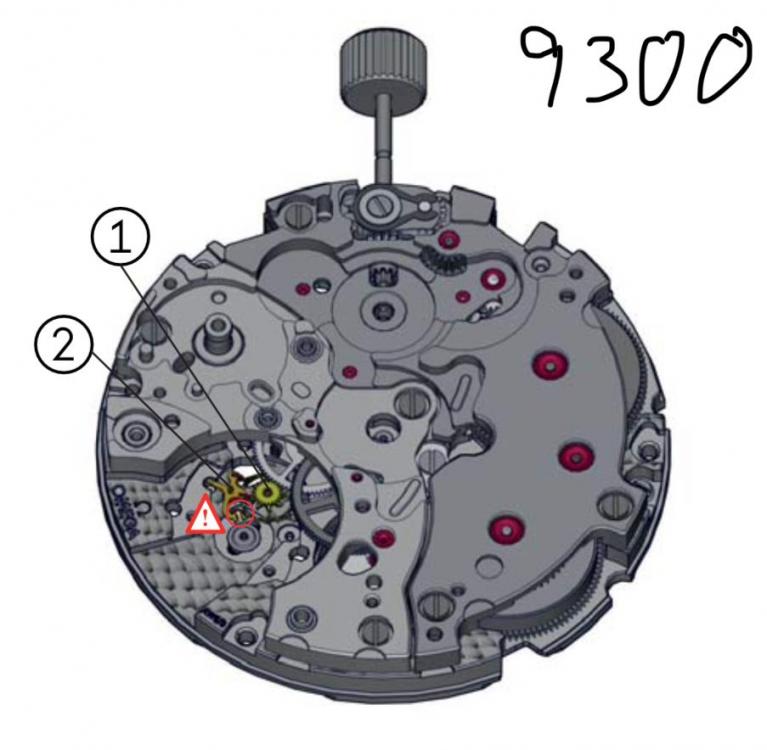

After looking through the technical documentation for the 8500 and 9300, I have come to the conclusion that while the 9300 is not a modular chronograph, it is certainly an integrated chronograph with a sandwiched (layer construction), sharing a strong connection with its 8500 brother.
If you compare the layout of the 8500 and the 9300, you will find some remarkable similarities, as well as some interesting differences. The wheel train of the 8500 is shown below, with a very traditional direct seconds construction, of the sort seen in an ETA 2824. The seconds hand wheel (fourth wheel) can be seen directly in the middle of the 8500.
In the 9300, on the other hand, the wheel train lay out is very similar, although different bridges are used to secure each of the wheels. The intermediate wheel (off -center wheel) is labeled with a red arrow:A24F9088-BC5B-4AC4-8622-EB1068219BE2.thumb.jpeg.dbaa31c60ef4ecb02059d54d2aa1ca43.jpeg
The intermediate escape wheel in the 9300 is labeled with a green arrow, the third wheel(s) is labeled with an orange arrow; interestingly, the small seconds in the 9300 is achieved via an indirect seconds pinion (blue arrow):4D4FB2C6-CA46-4C01-A6A3-85F4976B5A3A.thumb.jpeg.91ddaca46d00076e4a81f9cfa7835b33.jpeg
from my understanding, the seconds pinion appears to go through the hollow intermediate wheel.
The wheel train bridge is then fitted over:4C430A60-0B4A-4322-83B4-A3BC5CCE6678.thumb.jpeg.cc3f4d3915696369bc4892fdf35afe00.jpeg
The fourth wheel is actually achieved via the the vertical clutch mechanism, which is the central chronograph second hand:47057BB4-1FE7-4D58-AA12-D2D543AB6A97.thumb.jpeg.a1ec5e35c5b11fd65ccdf95abb9bf15a.jpeg
Notice the pinion on the vertical clutch that interfaces with the third wheel via a cut-out on the bridge, and the pinion on the intermediate escape wheel that interfaces with the wheel of the vertical clutch.
