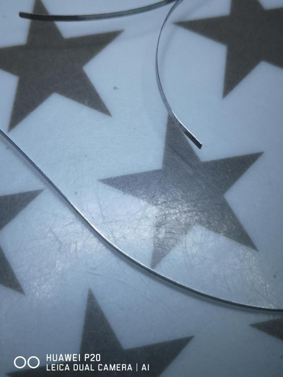

Just cleaned and oiled and rebuilt a doxa with a  A.S 1361 movement. It was going and stopping so took balance and pallet of and the train ran great,so great it would not stop for about 10 min. When it did stop i only had to touch the crown and of it went again for about 1 min 30 sec. So looking at the parts sheet it says something about a brake spring. The mainspring is part number 770 and brake spring is part 775. It looks like there are two parts to the mainspring???
So now i have taken the mainspring out of the barrel and it has the normal split ends that holds the auto to the barrel to stop over winding. see pics. But the barrel has nothing to hold or intefere with the mainspring to stop over winding. Also ranfft claims the inner diameter of the barrel is 8.5 mm this measures 9.25. The spring itself is very close to being what ranfft reccommends its just 20mm to long.
What i am asking i suppose is am i flogging a dead horse here or is trhere something i am tottally missing

Hi Gary  The mainspring and barrel look a bit manky, have you changed the spring and cleaned the barrel walls. when reassembling the barrel a couple of dabs of breaking grease on the walls before fitting the spring.    The brake spring 775 looks like a loose addition to the mainspring, modern springs have it alttached.   There wiil be some one on here who will know for sure.

  Bottom of the  barrel looks like it can use a polish and you do want a somewhat rough barrel wall.
I am not sure if its a poede MS, where th spindle is a seperate piece, this is how one looks like.

Hi Gary
the AS 1361 can be either automatic or non automatic, the movement you have is automatic and yes the bridle is seperate.
My answer to this is to use a battery welder to weld the bridle to the mainspring
I use single pulse at 15A to perform the weld
Firstly tightly wrap the bridle to the mainspring with fine copper wire in order to keep them together and well aligned
then turn the electrodes of the battery welding machine inwards (file the tips down to about 0.5mm)
Place the mainspring and bridle ensemble between the electrodes at the place where the attachment is needed with light pressure and pulse the welder
this should result in a fine spot weld.
