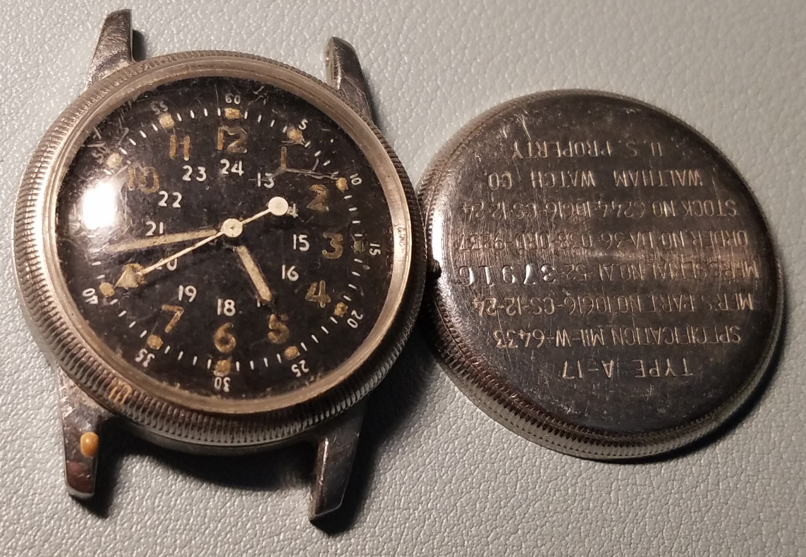

Anybody know the difference in these?  I have a 6/0-D (military watch) that needs a new balance staff.  I see some 6/0 staffs on Ebay (#26106) but not sure if it is what I need.  No help on Ranfft site.

This is useful.  It comports with what I see in the CE Marshall catalog pretty much.  The only unknown is the pivot size.  I will measure it.  I dont understand why the two different pivot sizes have the same part number.
