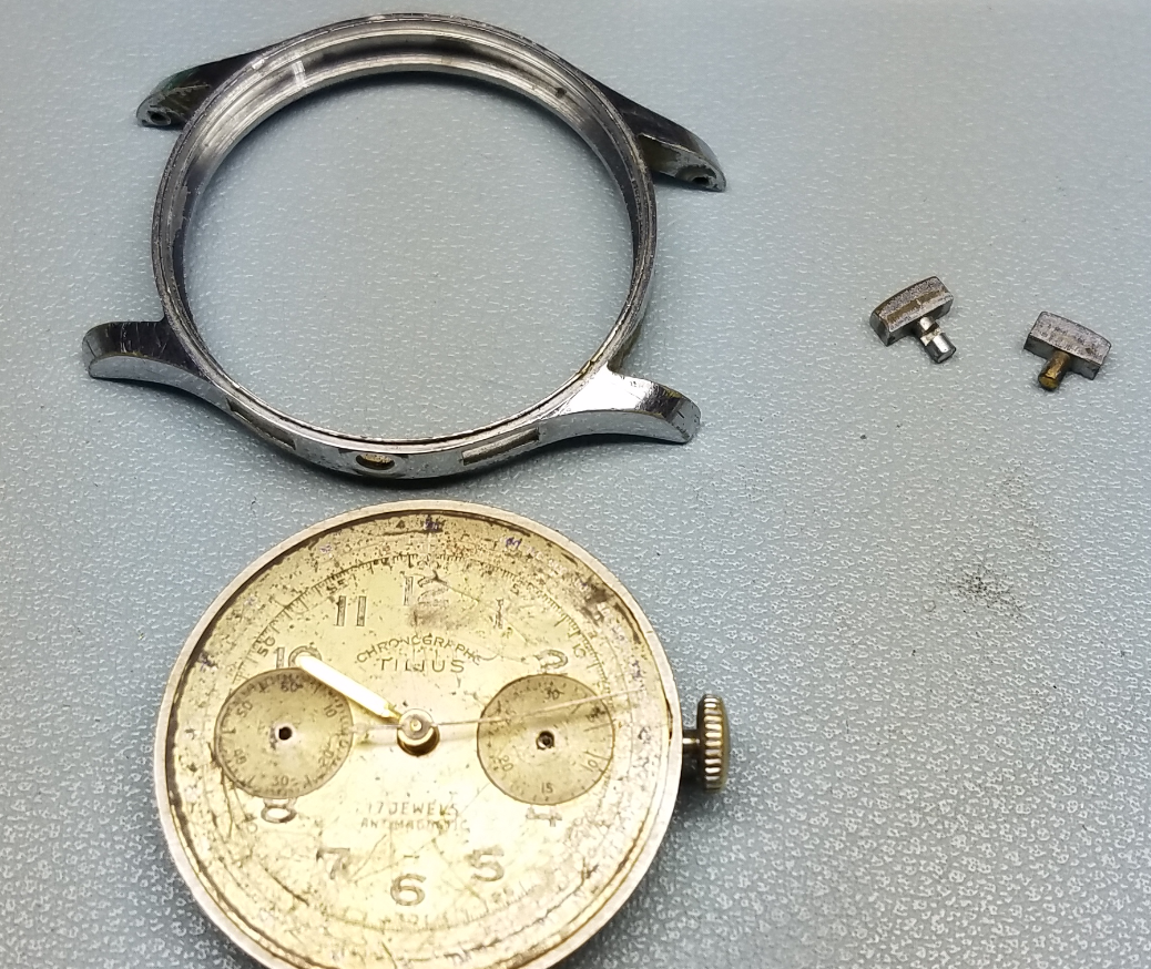

Hey, I am gonna jump on this thread with a question about use.
In the picture, you see a Landeron 51 chronograph, case, and pushers.  It is running very well now that I have a new hairspring. I plan to find some hands and either buy a dial or have this one refinished.
As far as the case and pushers...is that silver plating, or chrome?  I realize I am asking for a guess since you cannot investigate in person.  Maybe using this silver process you guys are talking about would work??
I would like to restore to a pristine condition.

It's almost certainly not a silver plated case. It's not a really great option for cases because it tarnishes. The watches I have to experiment with were NOS from the early 70s, and they were splotchy black. Tarnished silver doesn't look good, and needs frequent polishing (or handling) to avoid tarnish. Plating wears through quickly. Chrome and nickel are the more likely plating materials.
The dial on the other hand... If that's a silvered dial, check out this thread:
Ignore the beginning of the thread, and scroll down about half way (look for the photos).@Blacklabshows a dial he cleaned up using what I believe is the commercial liquid solution. It might be a good way to bring that dial back. The applied details will still be missing where they're missing, but it would likely clear up considerably without all the noise from the missing silver and tarnish.
Edited by spectre6000
As spectre already mentioned, surely no silver on the case.
If the case shows pitting: it is chrome.
With no pitting at all: most probably Nickel.
Nickel is slightly yellow, chrome more blueish-white.
Frank
