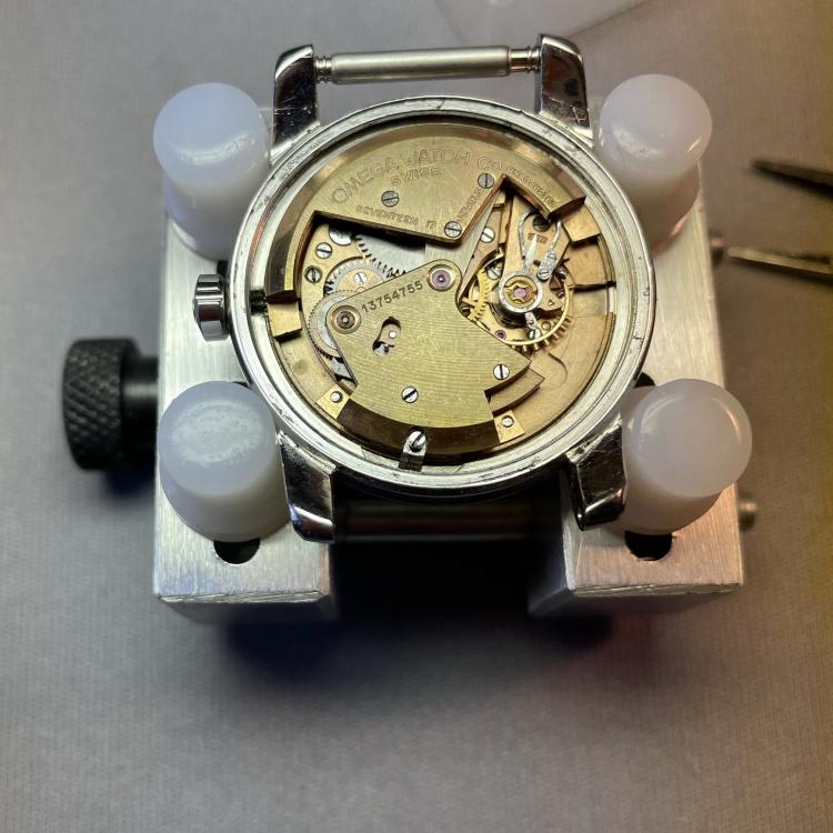

I opened it because it felt like the movement was a bit loose because of a rattle that did not correspond with the familiar "bump" of the bumper wind movement.
I made some measurements and ordered a few different seals from Esslinger. The movement clamp was a little lose and it kind of looked cobbled together or adapted from something else since the end that went under the edge of the case looked like it had been shortened with and end nipper and not dressed with a file afterwards. It was also not holding the movement especially well when I tightened the slightly loose screw.

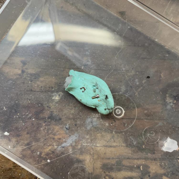

I decided that I could cobble something at least as well with materials on hand and tools I had or could make, so here is my effort. Please don't cringe too much.
Here is where I started, in the workshop with the screw and the broken clamp set in a piece of rodico. The first task was to get a hole of the correct size in a piece of suitable material, which I decided would be some sheet nickel-silver (German Silver) without having any tiny little drill bits.
Also photos of the movement with the clamp removed positioned at about the 12 o'clock position, the clamp itself, and the screw.
