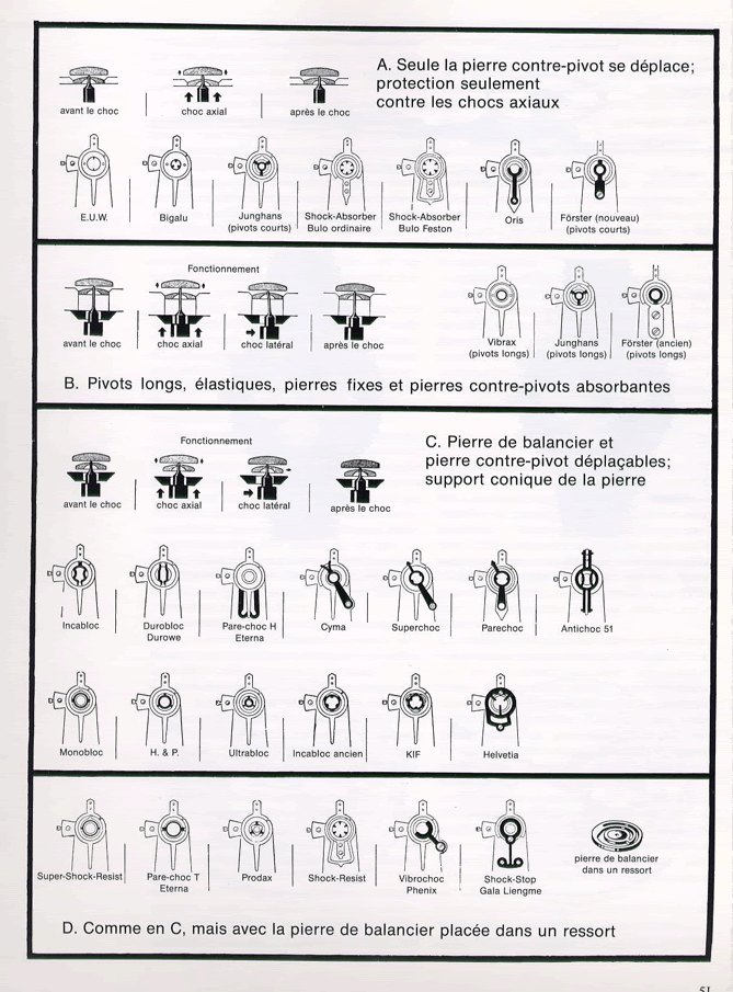

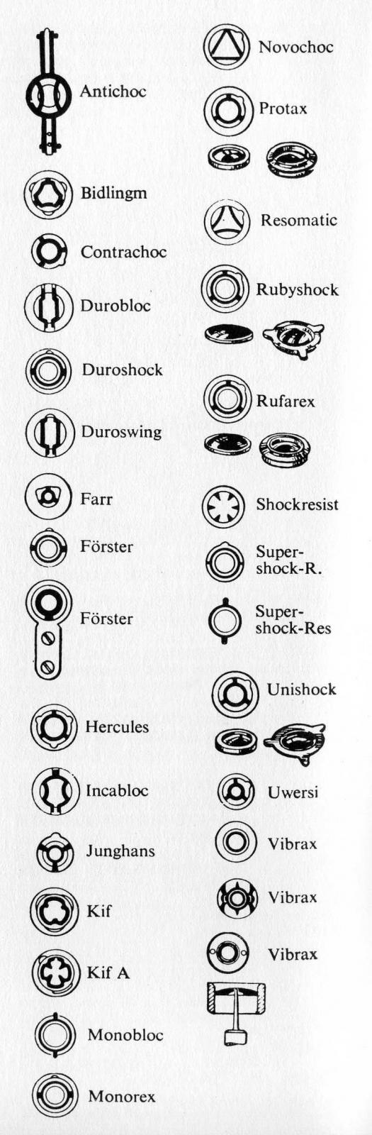

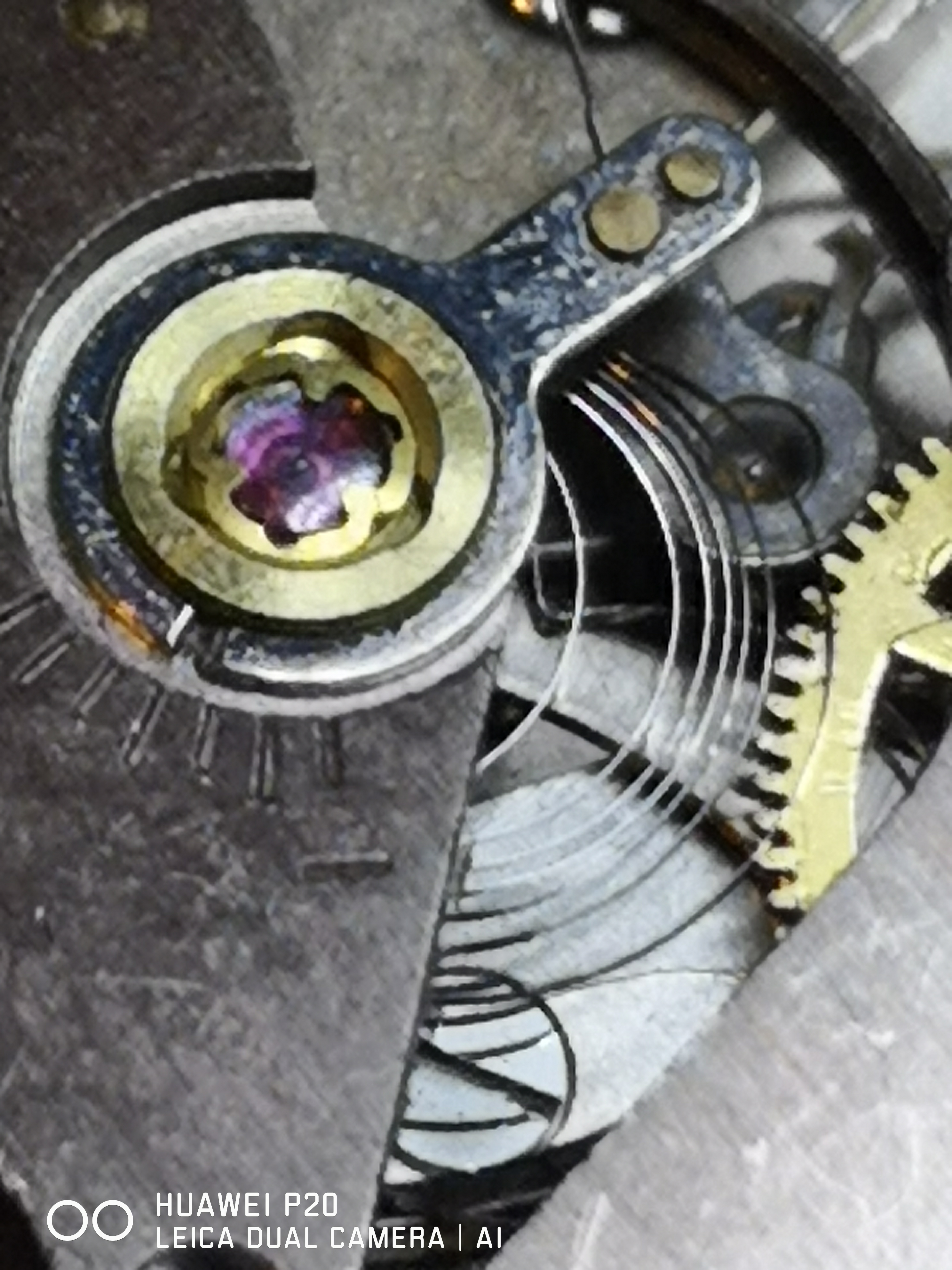

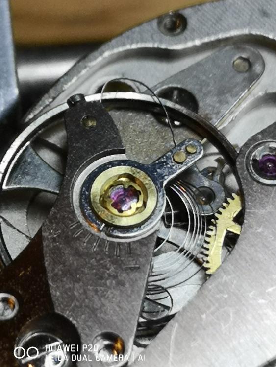

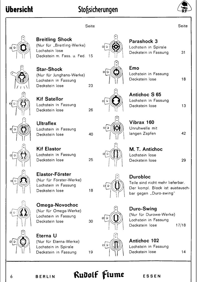

hey guys
I need a balance complete for this oris. The oris parts sheet says i need part number 715a.
But when i go to Cousins it gives me the choice of two.
1. 650721
2. 654721.
Which is the correct balance ?
I don't think the cock is incabloc (see pics)
Any one who can shed light upon this let me know.
