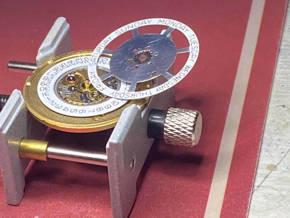

hmmmm.... maybe there is a way to skin that cat 🙀 let me think on it... unless anyone else has any ideas? I left the opening in the side of the base and ring quite large to maybe allow you to grip the crown, but appreciate this may not always be possible, especially for small movements where the crown will not extend past the outer wall of the holder. I noticed this also, but after using the holder for a while I noticed that the ring/holder began to wear into shape (rough edges/bumps worn off) and the size became closer to the desired movement OD. Maybe with some trial and error we could add 0.5 mm (??) to the movement OD to allow for this initial bedding-in?
