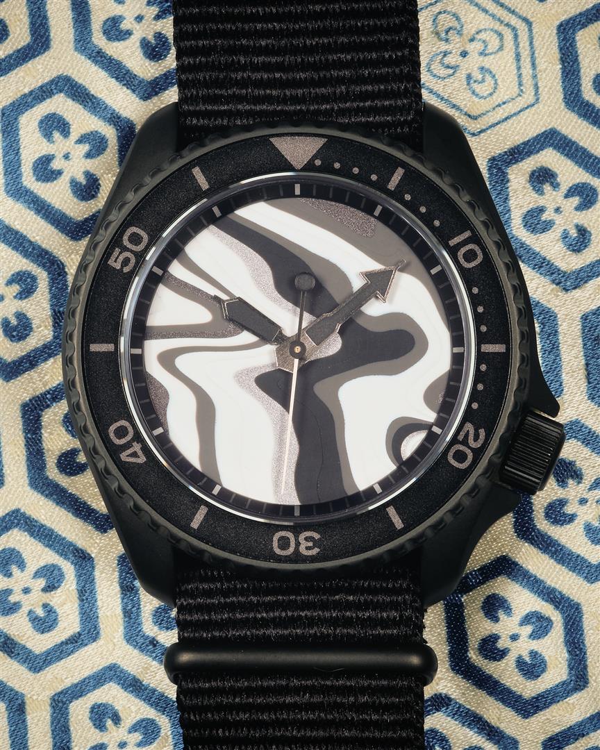

Another shot: I'm working on improving my watch photography too!
holee smokes thats nice!

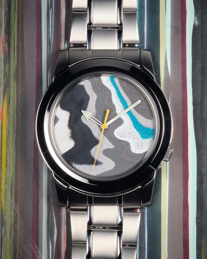

Please forgive the poor quality of these snapshots, but here are a couple more examples. (Along with everything else, I'm really working to improve my wristwatch photography. It pains me to share quick snapshots now, but it's a ton of work to produce really high quality photographs. I'll be writing up a technique/walkthrough for taking high quality wristwatch photos and sharing it with the group when things calm down. With luck, it'll help folks take better picture of their watches ... and maybe make a little more money on their eBay sales.)
This finished watch is an SNKK27 with a dial that really reminds me of a topographic map.
This dial sitting by itself is way more vivid and psychedic, and I'll be putting it into a watch today.

Quick snapshot of a vibrant-to-the-point-of-garish completed watch. I'm likely to keep this one. Again, forgive the photo quality -- I've got a bunch of stuff lined up to shoot better this weekend.

I spent a few hours photographing the watches I've built to date instead of grinding fordite dials over the weekend. I'd like to write a guide for watch photography for folks ... but I've still got a ton to learn.
