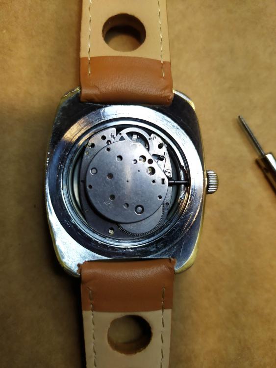

My timex f1 (that i think have a m25 movement) have Teo problems, the first is that when the Watch start, It stops After a few seconda, and the seconds is that when i load the main spring after some rounds of crown the main spring snaps and returns without charge.
I've arleady clean all parts of the movement, but i don't know what parts is ruined and be changed.

well, to me it sounds more like a click issue.  are you sure it is a M25?  show a picture!  this way we don't have to guess...:)
On the movement there Is the sign "n44" but i haven't round anything about It.
Another thing Is that, when i nove the barrel with my banda (like the main spring should do) the movement work fine
that looks like a Sprite model.   the N44 is a factory number and has no bearing to this topic.  is there a date ring?  if so it would likely be a M25 no date ring than m24.  still a guess without seeing the dial.  aside from this, it sounds like the mainspring is the issue. But, that would have to be confirmed by more investigation.

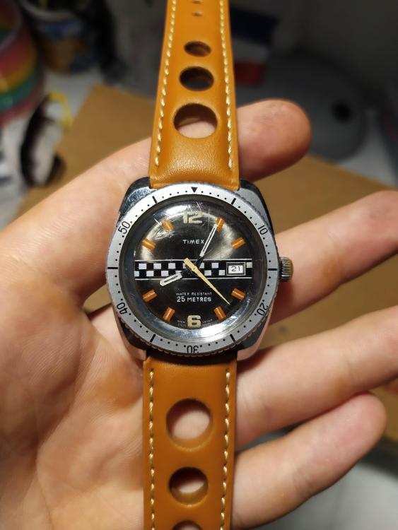

I leave you a photo to make you understand why I want to restore it.

I have seem the issue where the outer edge of the spring slips against the barrel.  It could be either the tails or the small dibble that catches the tail is worn.  Either way this not an easy fix since it requires a full tear down and rebuild.  So what to do about the required parts?  Buy a lot of 'fixer uppers' or 'spares repairs' as they say across the pond.  What happens as a result of this of course is now you will want to repair them all.  BTW:  The watch shown is a European model from what is commonly named the "Sports Series".  This is distinguished by the use of Meters rather than Feet printed on the dial.  Need a NOS mainspring and barrel?  I have them but shipping cost more than the part.
Finally i've repaired the movement and now the Watch runs, the problem was the mainspring that slipped against the barrel like as jerseymo said.
I've also found an old advertisement, but i'm not sure if the Watch of the advertisement and my Watch are the same, can you help me?
