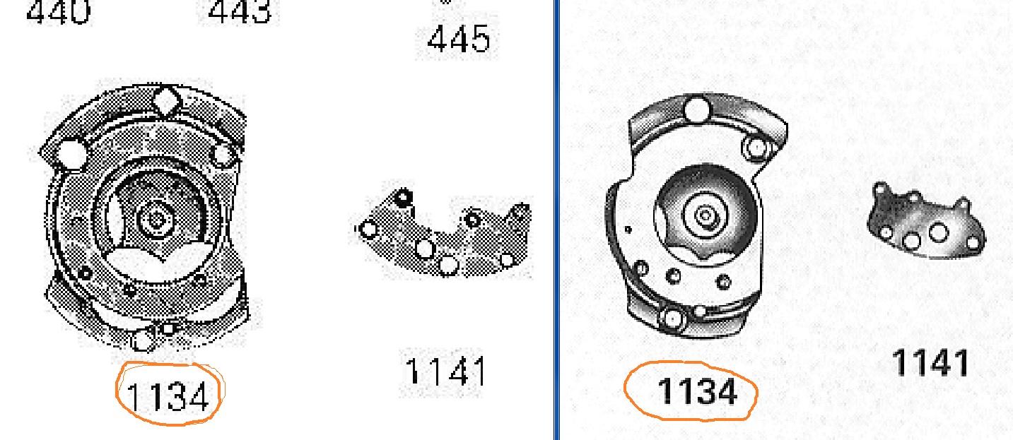

I am working on the two vintage ETA movements 2783 and 2873 and will need spare parts for the automatic winding assemblies. While searching for these parts I came across obviously different ones which have the same part number.
Furthermore, some ETA parts are interchangeable between ETA movements.

I think those numbers refers to the system EBAUCHES SA tried to introduce a while ago. ETA has change their system a bit and do not always use these reference numbers nowadays.
The older tech sheets still do so I attach an old document describing the different parts and their referens number.
Dictionnaire Technologique-EBAUCHES SA.pdf

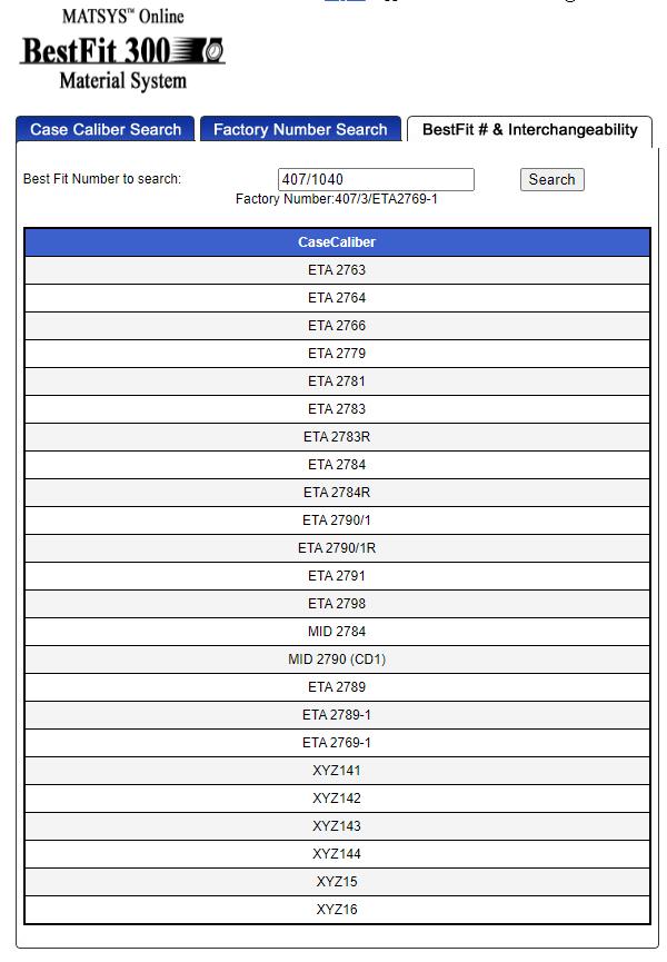

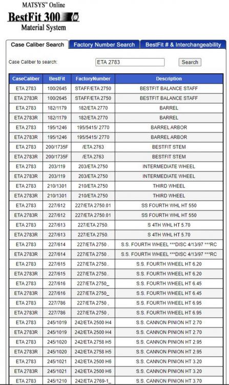

So insted one can buy access to an database provided by BestFit.
Here you can see the actual part number and which calibers share this part.
Access to the database is sold by Esslinger
https://www.esslinger.com/matsys-online-from-bestfit-lifetime-membership-watch-parts-lookup-software/
This is the Caliber Search
And the Interchangable list
