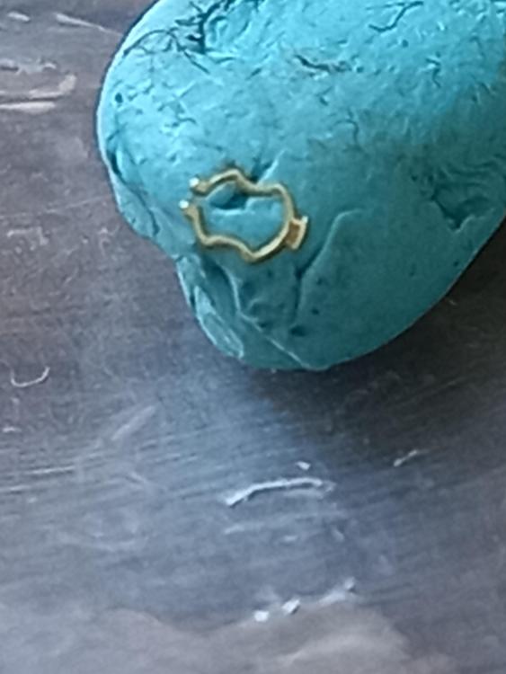

As Requested. These are the most that I can expand the camera view, 10x. I have place the spring on top and tried to side the bar into the gap. No joy. Do I need to place the bar down into the outside surround and attempt to slide it under? If so, can can anyone tell me which side. Outer of base, or inner?
Regards
Ross
Regards
Ross
Ok im back , bloody phone was peeing me off not loading up. You have an inca or lyre spring i cant remember which. Inca i think , either way its going back in. Use the method i discribed earlier with a small piece of rodico and a fine oiler. Hang on a min missus is wanting me now

Hi ross. As far as i know the spring doesn't go in horizontally.  Have you tried standing it up on end and locating it into the recess on the right hand side of the setting on your photo. Then lower it down and locate the two arms in with an oiler. Use rodico to hold it in place while you do this. This where a microscope comes in very handy.

Then your picture I magnified it stepped out something and circled a couple of things. Well technically I circled one thing is a little protruding finger that's good it's supposed to be there. But on the other side it seems to be invisible or missing? That's very very bad. Both parts have to exist or the spring will just fallout all by itself.

13 minutes ago, JohnR725 said:
While you may be in the same boat it's always best to start a new discussion because it becomes extremely confusing when your discussions now the end of another discussion and then people are quoting the previous discussion mixed in with your discussion and are you in the exact same boat really?
Well spotted john 👍. One side is broken. This is why i always advocate using a microscope
