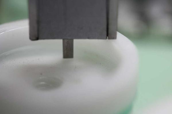

The die has to be hollow enough in the centre so it only presses on the retaining ring and doesn't contact the crystal as the retaining ring lowers towards the case during pressing.
What do you mean by 'a die that didn't foul the crystal'? I have a clark installed at the moment and the magnification is half compared to the original 116 high dome that was removed.
You can get a set of dedicated dies for the purpose, but as I rarely work on these I just modified a couple I already had in my lathe.
The one on the left is deeper cut than the one on the right in order to allow the cyclops to not foul the die.
The die after cut out:
The original depth:
Hope this helps.
